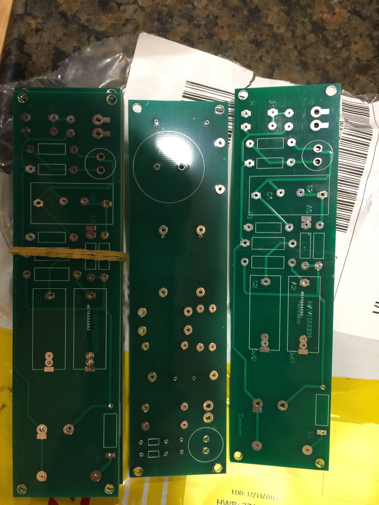

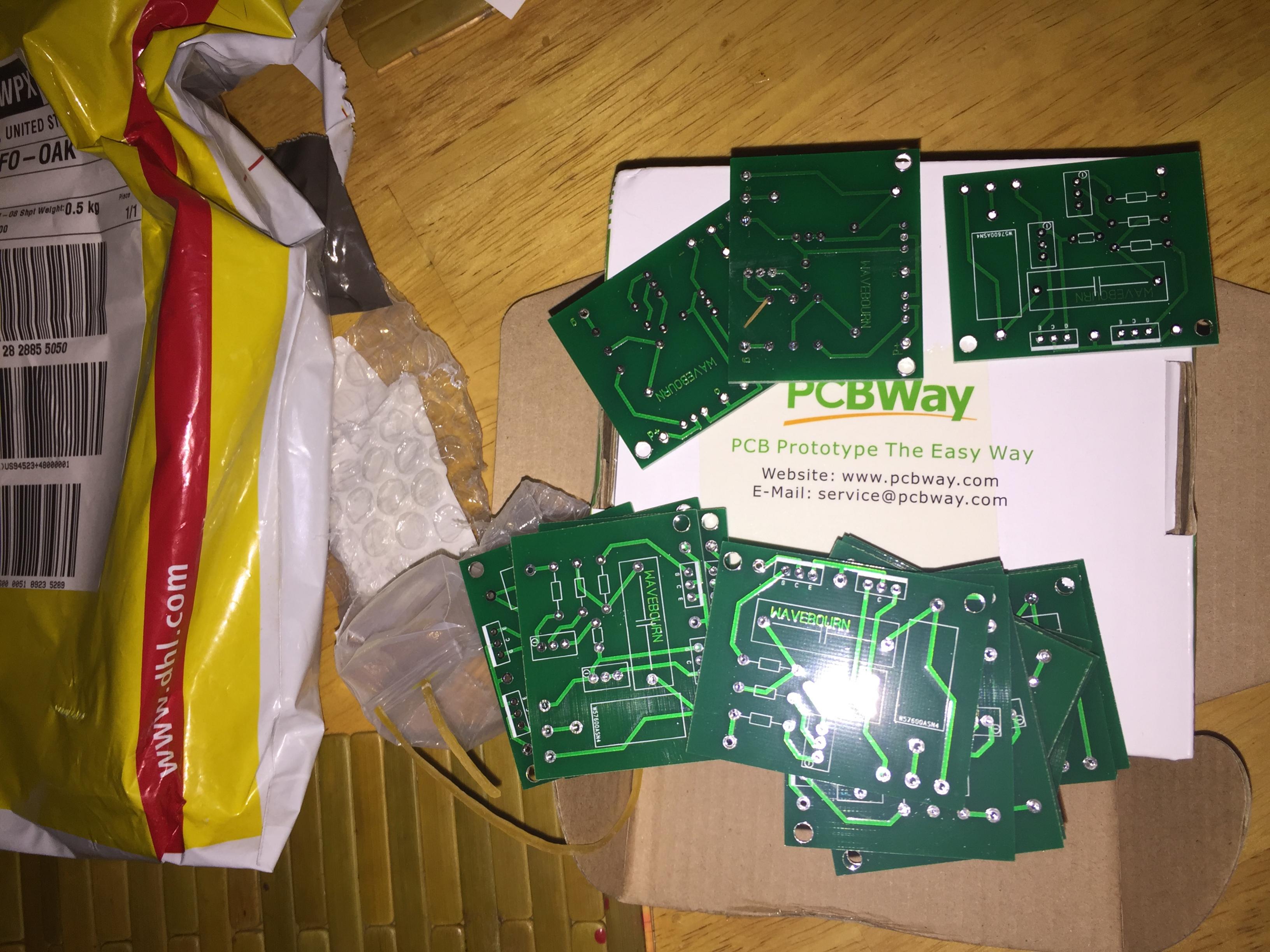

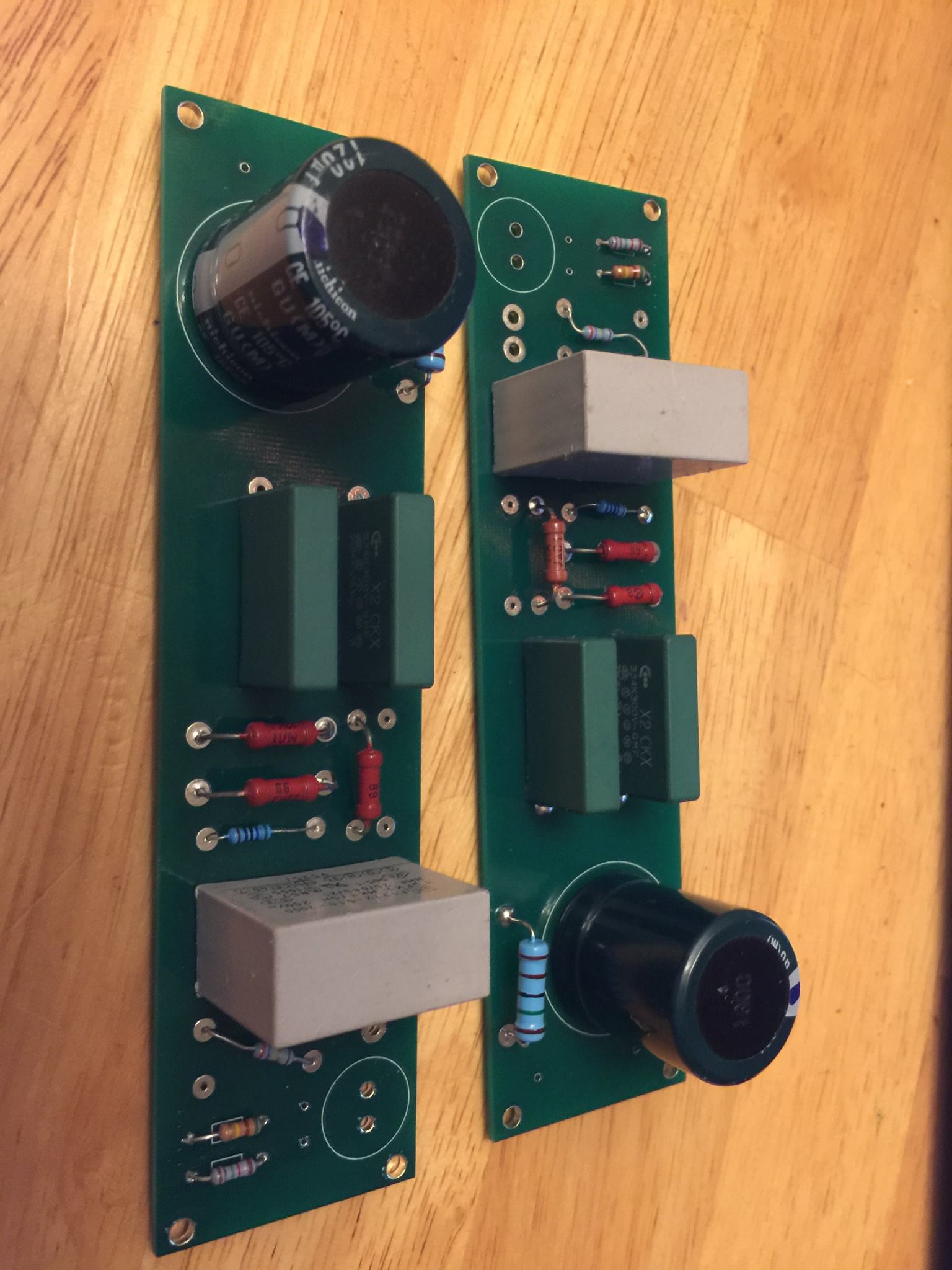

I will have some soon.

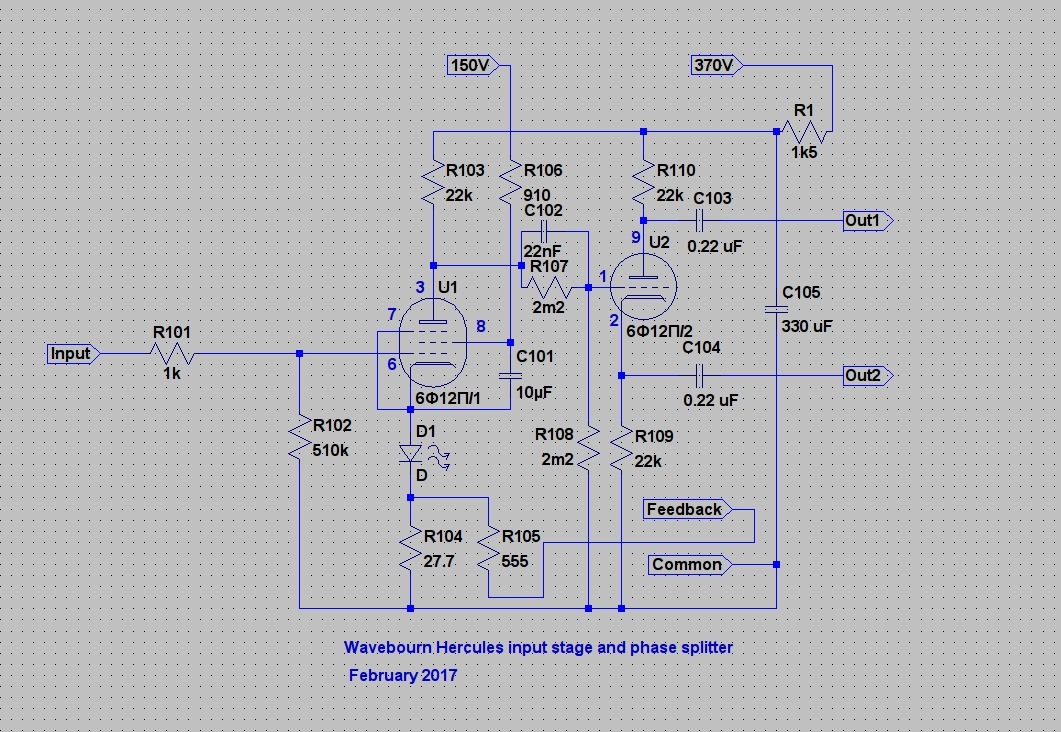

Here is some example: P-P phase splitter.
The board contains one error, and will be redesigned. It stays near tubes for better convection, so any tubes can be used, either triodes-pentodes, or double triodes, connected by short wires or resistors.

I would love a set of those when they are ready 😎

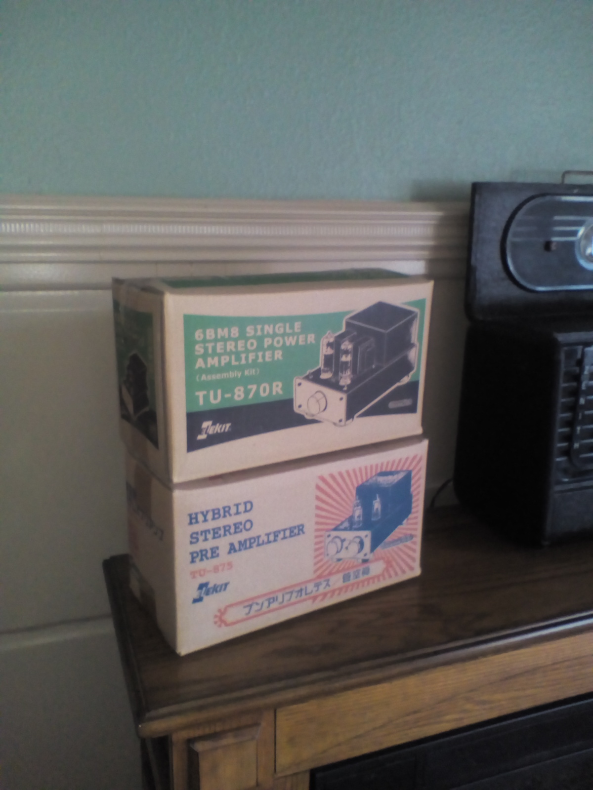

The two Elekits in the picture would likely be finished and playing sound while one is still sanding and gluing on bottlehead kits. ( Save the PM's guys - the TU-875 is NOT for sale ... )
Elekit vice Bottlehead is really an apples to oranges comparison, imo.
One is built on a PCB in a stamped metal chassis. PCB construction offers a high probability of success, with little risk of ground loops, and other vexing issues. The TU-879S I have at our lake house uses a mosfet ripple filter, and DC on the filaments. It is stone, cold, silent, on 96 dB Klipsch speakers. You can't even tell it is switched on. I did convert it to use 6V6's, because I like 6V6's, and I could.
The other uses point to point wiring, and comes with unfinished lumber for a chassis. Point to point is fine, sometimes fun, but there are more opportunities for mistakes, and other issues, like hum and ground loops; a realistic concern when you are dealing with high sensitivity speakers. Bridging it to get 8 watts sounds nice, but it may not sound the same bridged, as it does in stereo. Someone who owns one might be able to answer this. I think there is a bottlehead forum on the aptly named audio asylum - you might get more accurate information on their products there, since it appears none of us ( including me ) have any first hand experience with them.
I don't necessarily share the point of view that it is harder to modify a pcb based circuit than it is a point to point circuit, but if you are not the type of person to modify circuits ( why would you even want to? It looks like they went to a lot of work to engineer a well designed circuit ), it doesn't make any difference.
I'm not an Elekit fanboy, and don't want to come across that way, I just thought the reference to them as having the appearance of "cheap ebay gear" was seriously uninformed.
