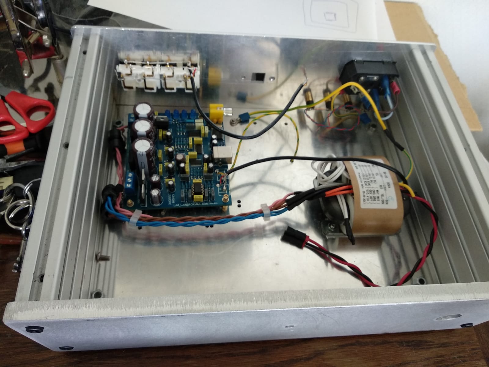

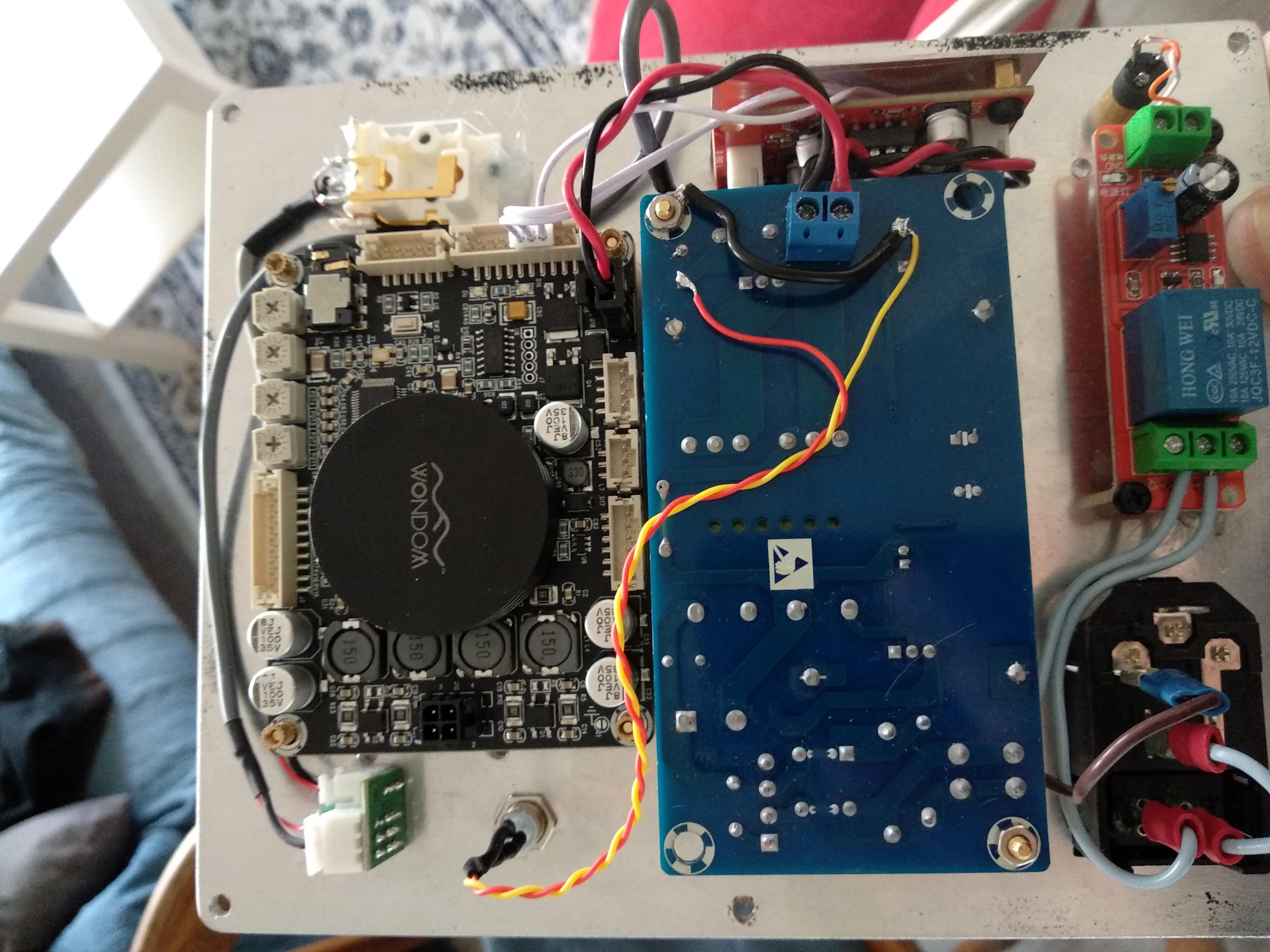

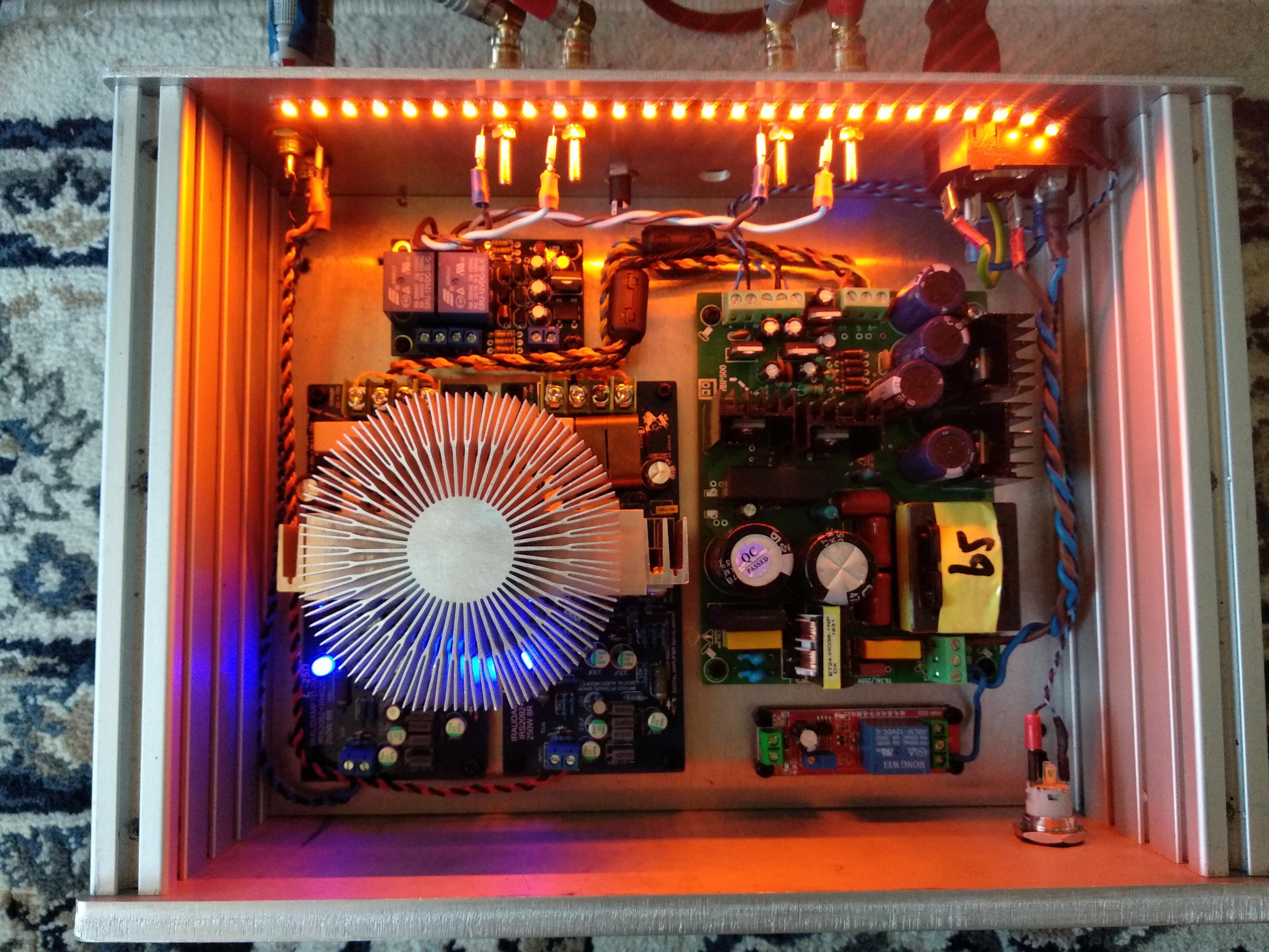

Just to make things a little clearer, here are pictures of the DAC build, L25D power amps(with fully functional christmas lights), and sub plate amp.

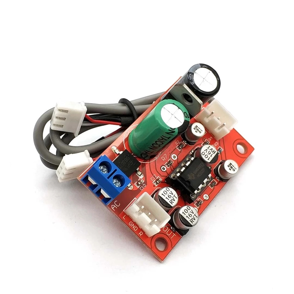

OK, but the 5534 requires external compensation for unity gain. Not a huge deal, 22pf. However, the 5532, essentially a dual 5534, is internally comped for unity gain. Lower parts count.
So if the NE5532 is preferred over NE5534, I could just use one of these?
aliexpress.com/item/4000081857155.html

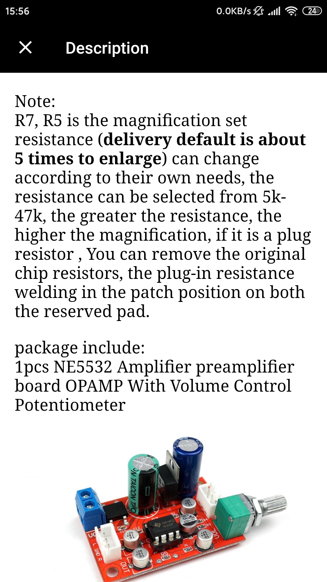

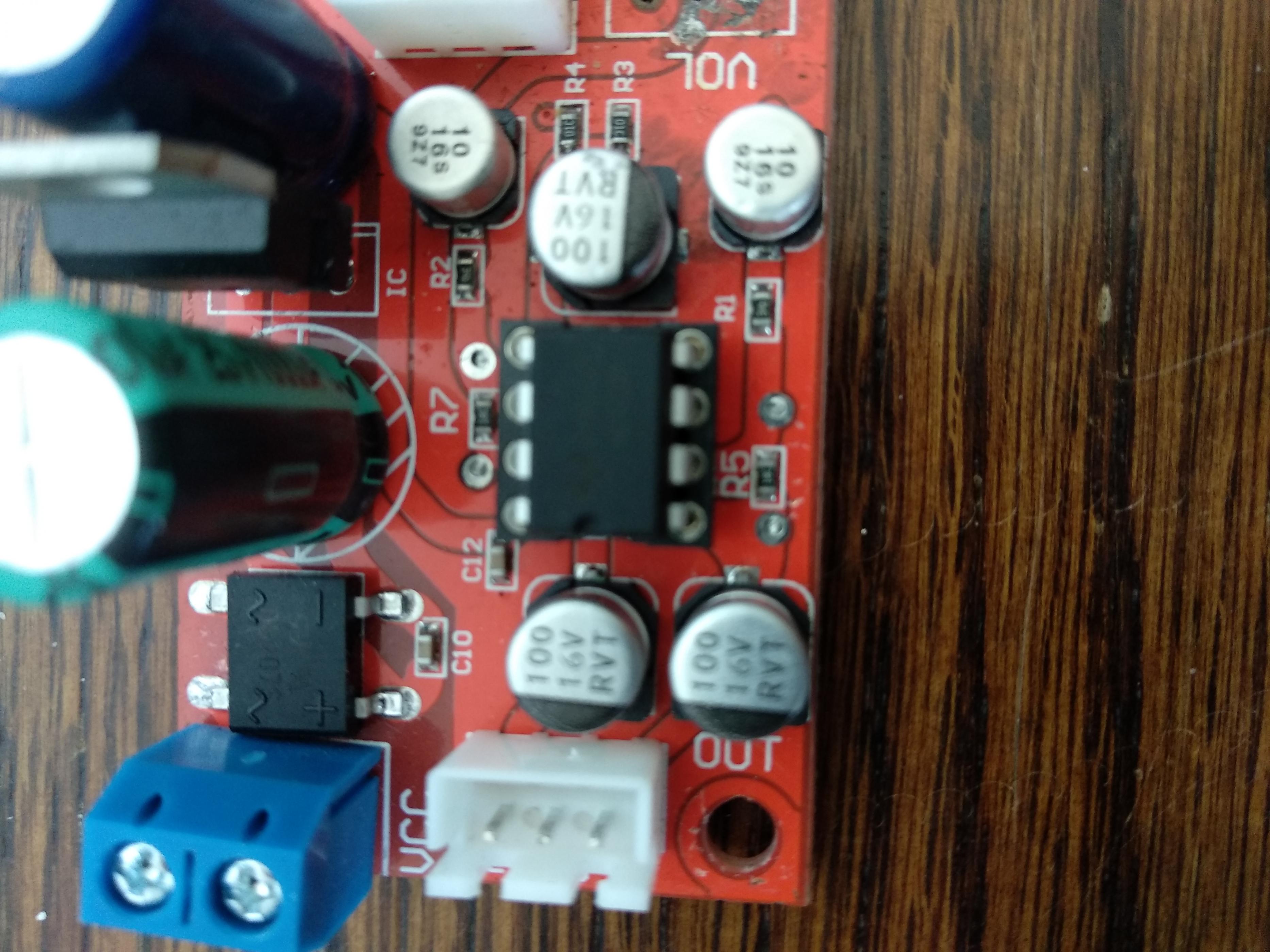

It's seems like I can easily remove the gain resistors r7 and r5. Then add 5k ohm through hole resistors. Still with no further documentation I have no idea what that makes the gain.
The stock resistors measure 15k
