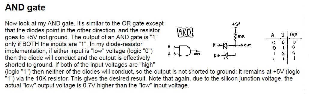

Notice the AND gate in the schematic fragments I've uploaded. If PN junction diodes can be used to make an AND gate, then (with proper voltages) a 6AL5 should make an AND gate too. Heaven knows that reverse recovery spikes will not be an issue, as is the case with PN junction diodes.

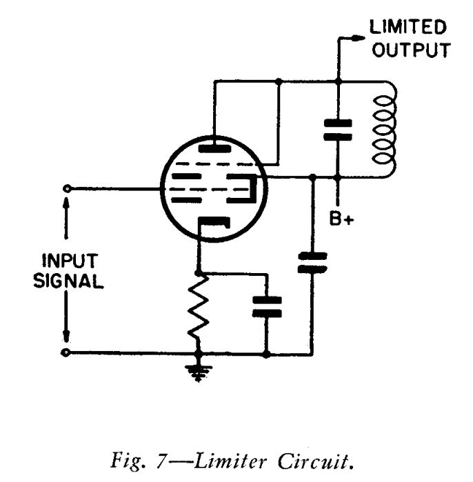

3, perhaps 4, IF stages feeding a 6BN6 gated beam limiter would seem to provide the hard limited signal needed.

A 6BN6 can do the gating too, so no need for extra diodes.

FWIW, I've seen reports of unsatisfactory distortion performance, when a single 6BN6 is used to amplify, limit, and demodulate. Interestingly, Stu Hegeman's H/K Cit. 3 uses 2X 6AU6s and 2X 6BN6s in front of a germanium diode Foster-Seeley discriminator.
If somebody can suggest a better AND gate built with triodes, instead of diodes, I'd very much appreciate it.

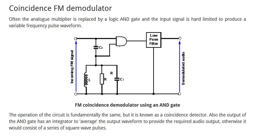

In ICs, PLL and quadrature/coincidence are the "in vogue" methods of FM demodulation. PLL is impractical in 100% tube circuitry, but quadrature/coincidence is quite doable.

In the other hand, the un-decouplig resistor at the plate of the 6BN6 can control the amount of RF signal coupled to the limiter grid and its tank circuit (signal level, phase and Q), then from it you can control BW of the detector and eventually distortion. In any case, what are the amount of distortion these sources argument to have?

I doubt if the 6BN6 was intended for hi-fi. TV sound more likely, so a little distortion would not be noticed by most people.

Correct. Check the 6J10 compactron out, where a gated beam section and a power pentode are packaged in the same bottle. That's the entire audio section.
Back to the vacuum diode AND gate, as triodes are (presumably) too slow at 10.7 MHz. A 6AL5 seems to be fast enough. I'm uploading a fellow's homebrew PN diode AND gate schematic. Please suggest parts values and voltages to adapt the topology from "sand" 5 V. logic to "hollow state" FM. Would buffering the gate prior to RC integrating the pulse train produced make sense?
