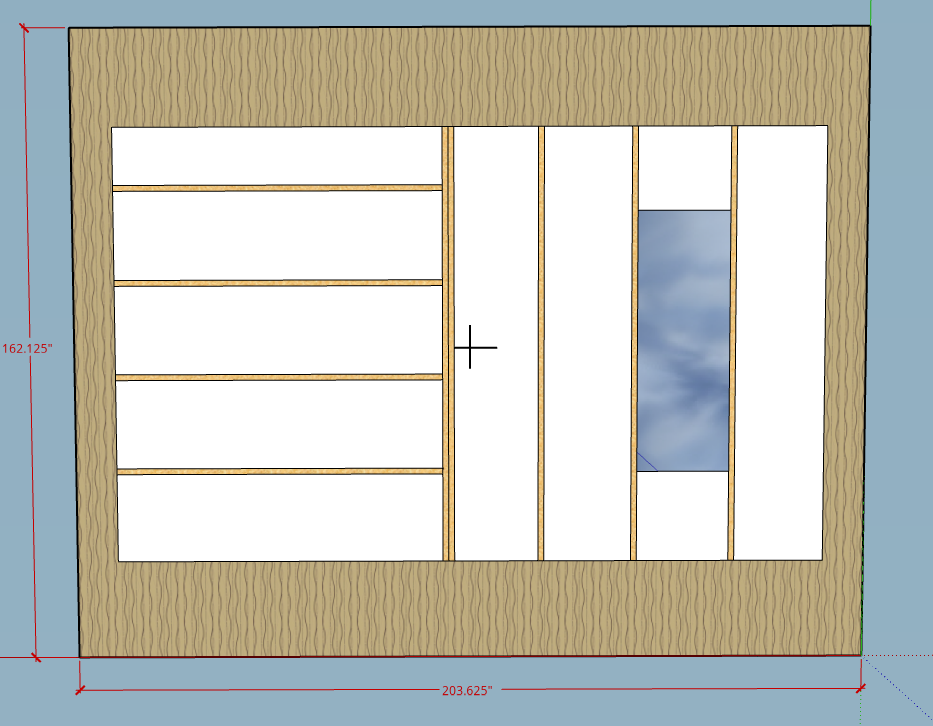

I'm making 42 of these and there are 9 slightly different sizes to fit in between ceiling trusses. Made from solid Birch - For piano practice room.. Bit of a learning curve with fit and finish.

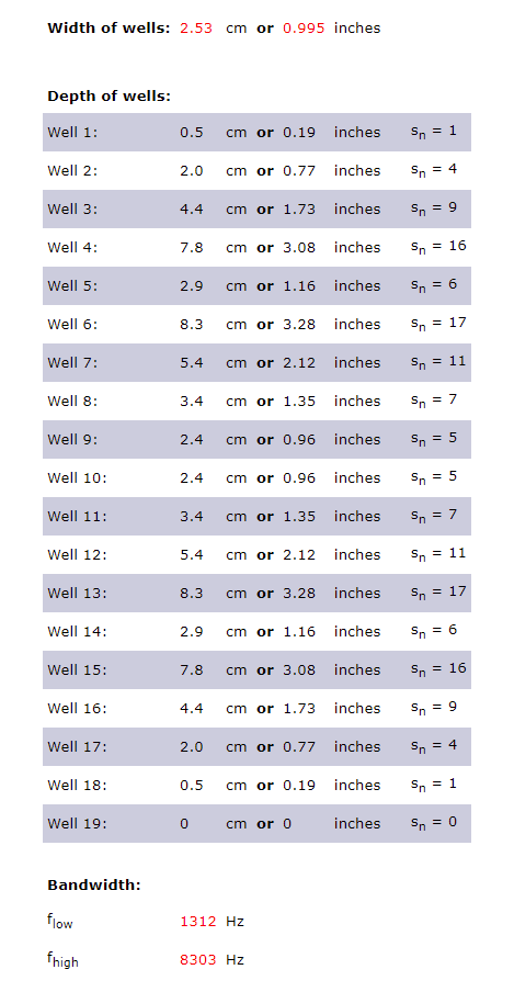

Any information on the design, what frequencies are they optimized for, are they a prime based QRD? I've been trying to read up on diffusion and room treatment and it's a lot to take in.

The piano rooms ceiling perimeter has absorption covered with fabric. There's a skylight, the remaining space holds 42 diffusers.. I used the calculator here Calculate Quadratic Residue Diffusor ( given size )
Made small adjustments to the number of wells for different size boxes and maintained a consistent aesthetic
