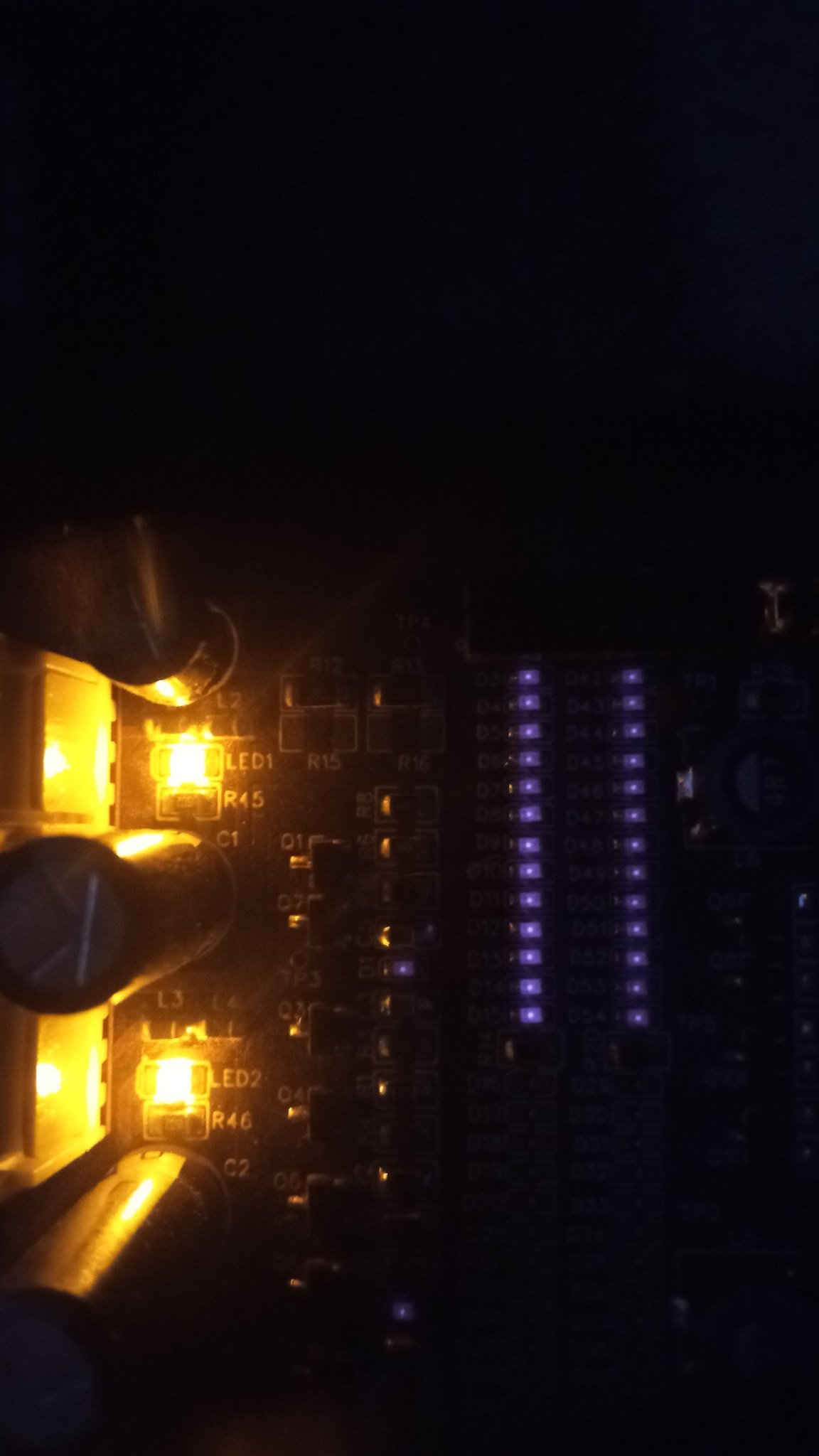

These IR LEDs are a pain. They are really small (0603 size) and worse, the orientation mark is only at the bottom side.
But this is the fun of diying 😎
And here is the IR glow from the Dark LED module
George

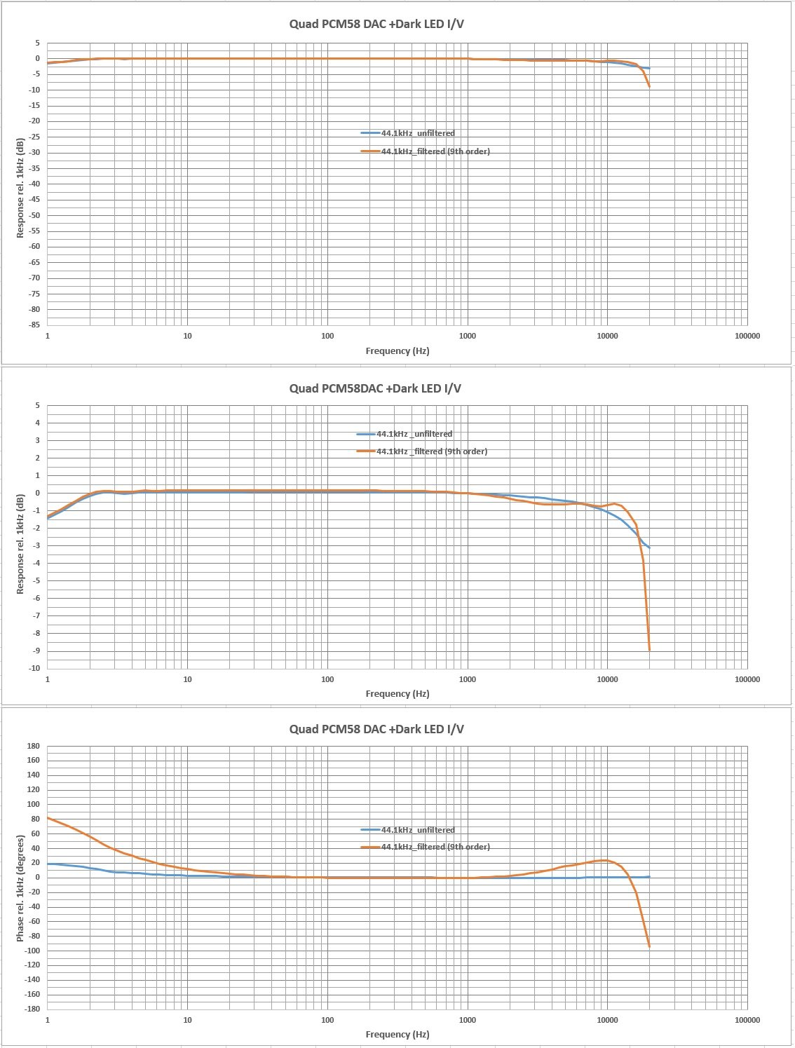

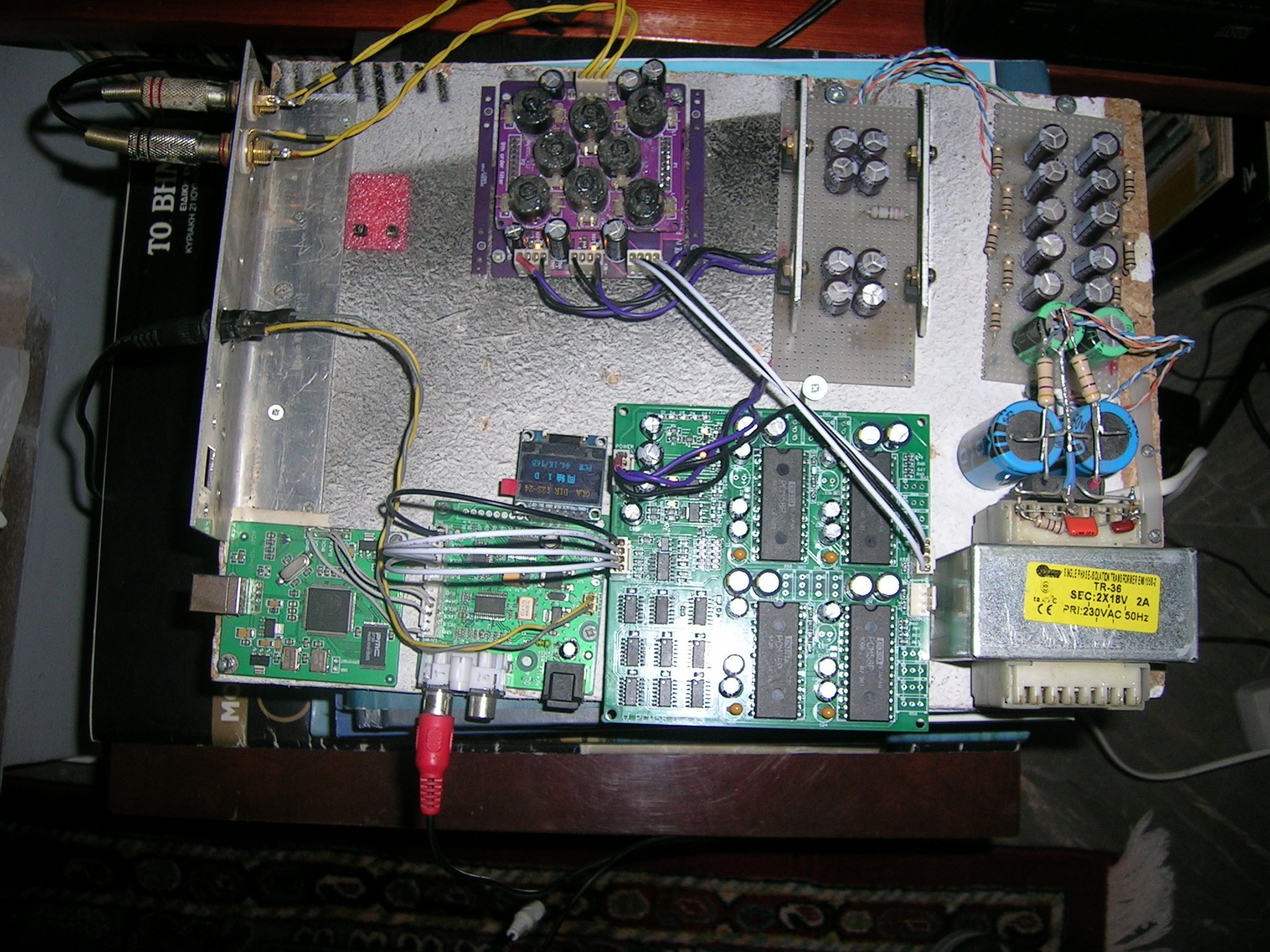

My Quad PCM58 DAC + Dark LED I/V first audition after the assembly.
The DAC was with zero hours.
High mids and treble were almost missing.
After two hours with music, they came to the surface.
It needed some twenty hours playing music for sound to set.
Big sound, very good low end. Well balanced mids and pleasant highs.
I see that sound still settles more from day to day.

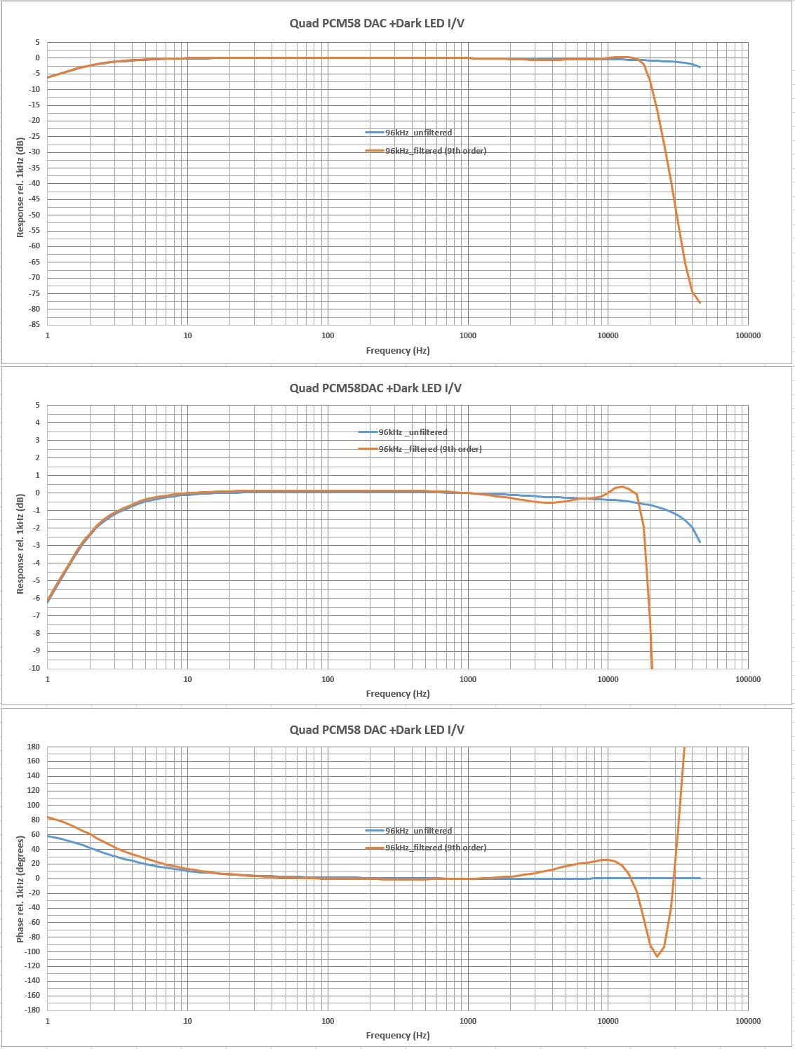

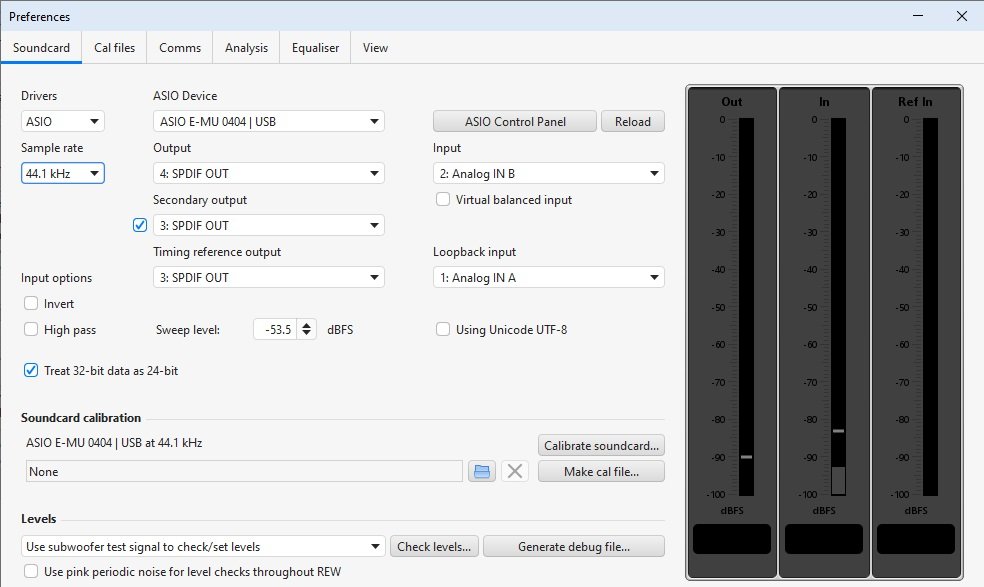

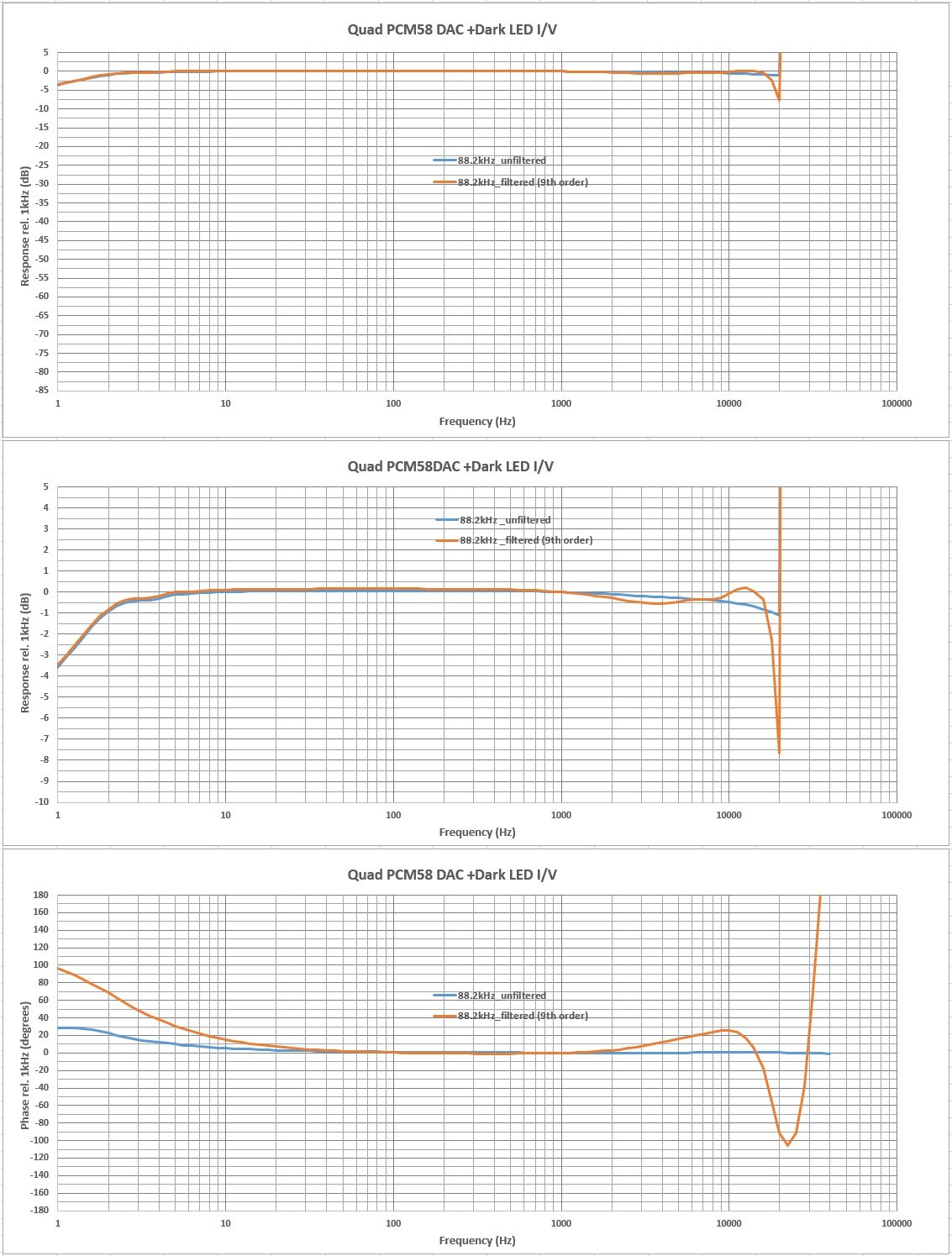

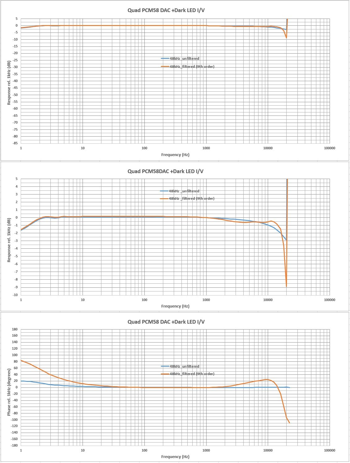

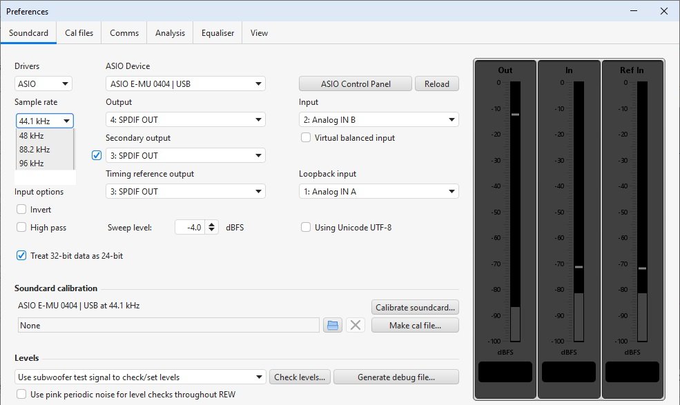

I took some FR measurements. Input was SPDIF,
E-MU 0404 sound card. SPDIF out (so Sampling Rate was up to 96kHz), to analog in
Two measurements at each SR. One unfiltered (9th order filter of the DarkLED bypassed) and one filtered (9th order filter of the DarkLED installed).
Quad PCM58 DAC in SE configuration
DarkLED output load: 20kOhm
George

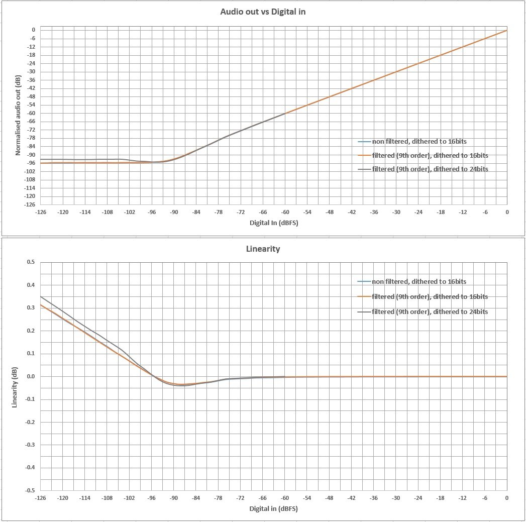

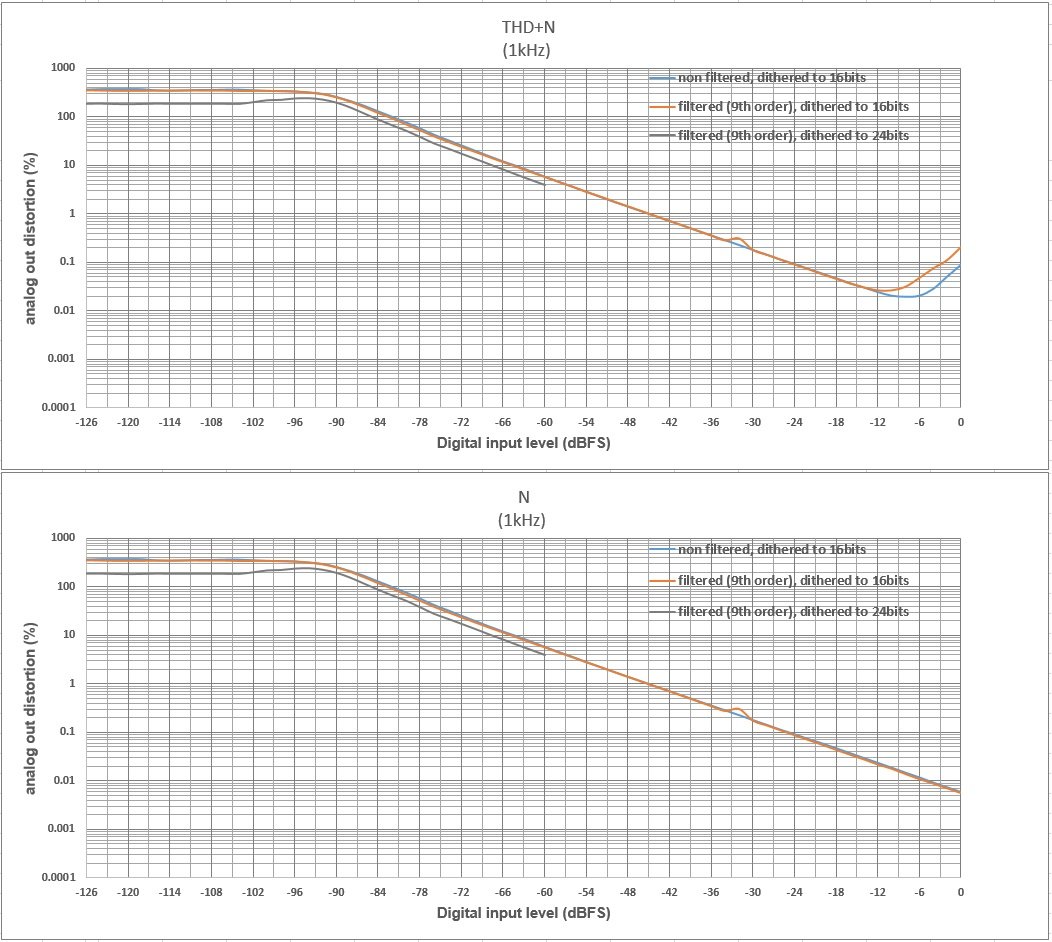

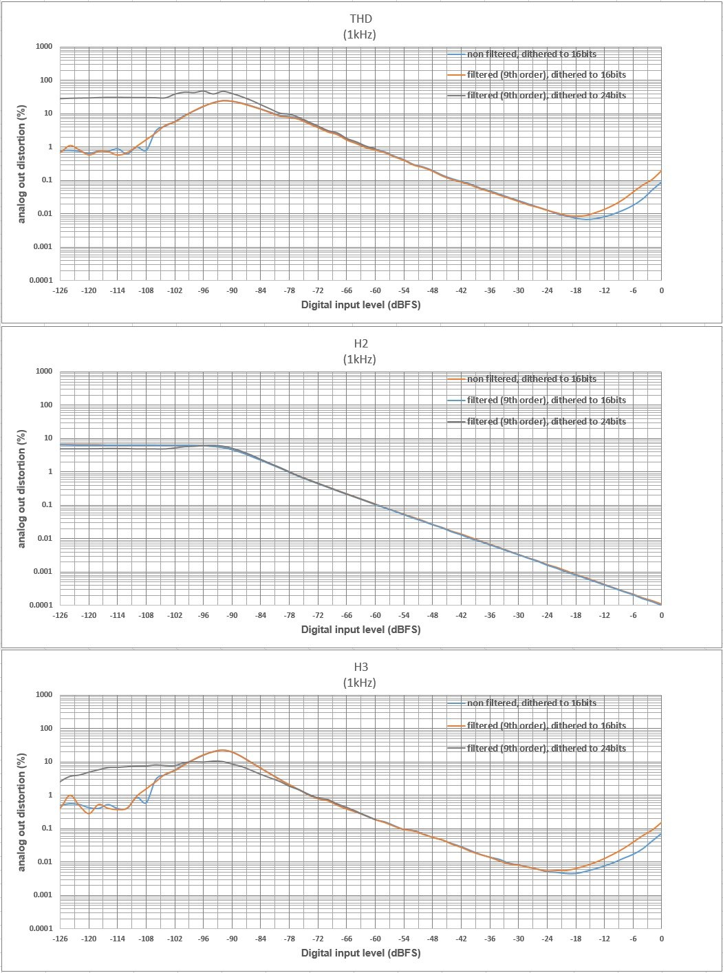

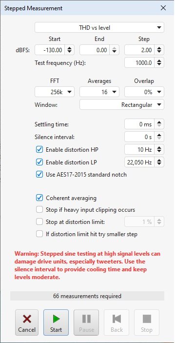

Step level measurements.
1kHz signal. -130dBFS to 0dBFS
E-MU 0404 sound card. SPDIF out, to analog in.
SR 44.1kHz
I find linearity to be excellent. - 0.5dB at 15bit depth, +0.5dB at 17bit depth.
Distortion profile is very close to Abraxalitos TDA1387 DACs.
All these with no trimmer installed yet.
George

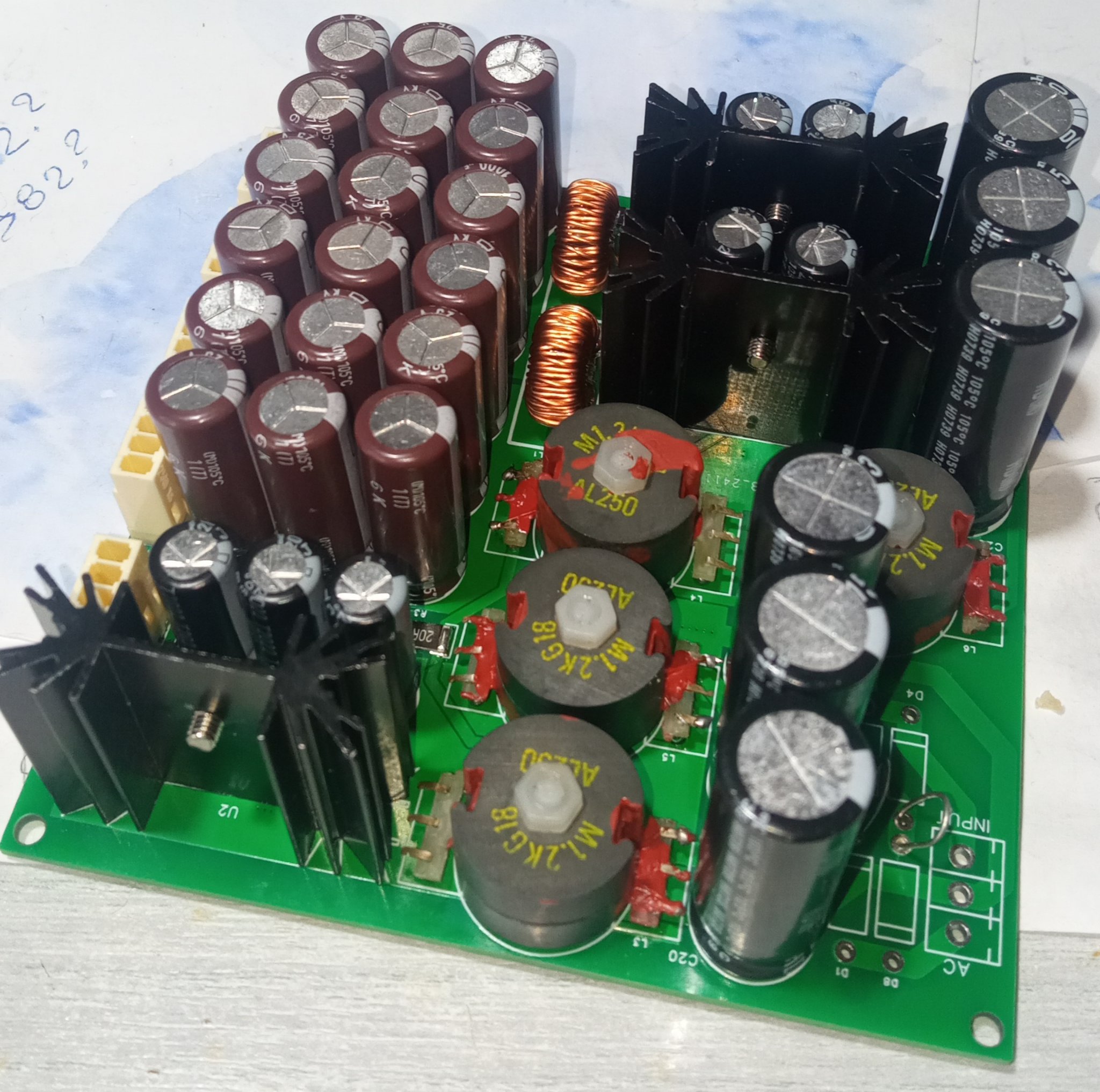

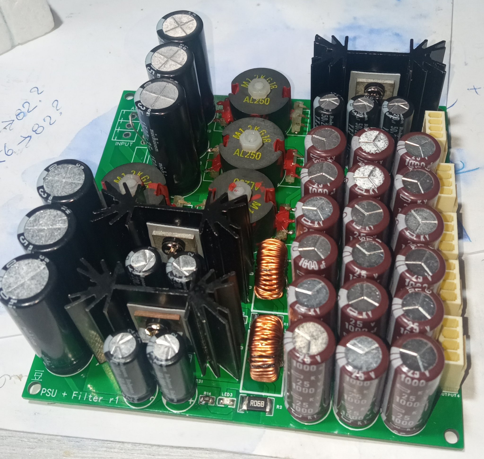

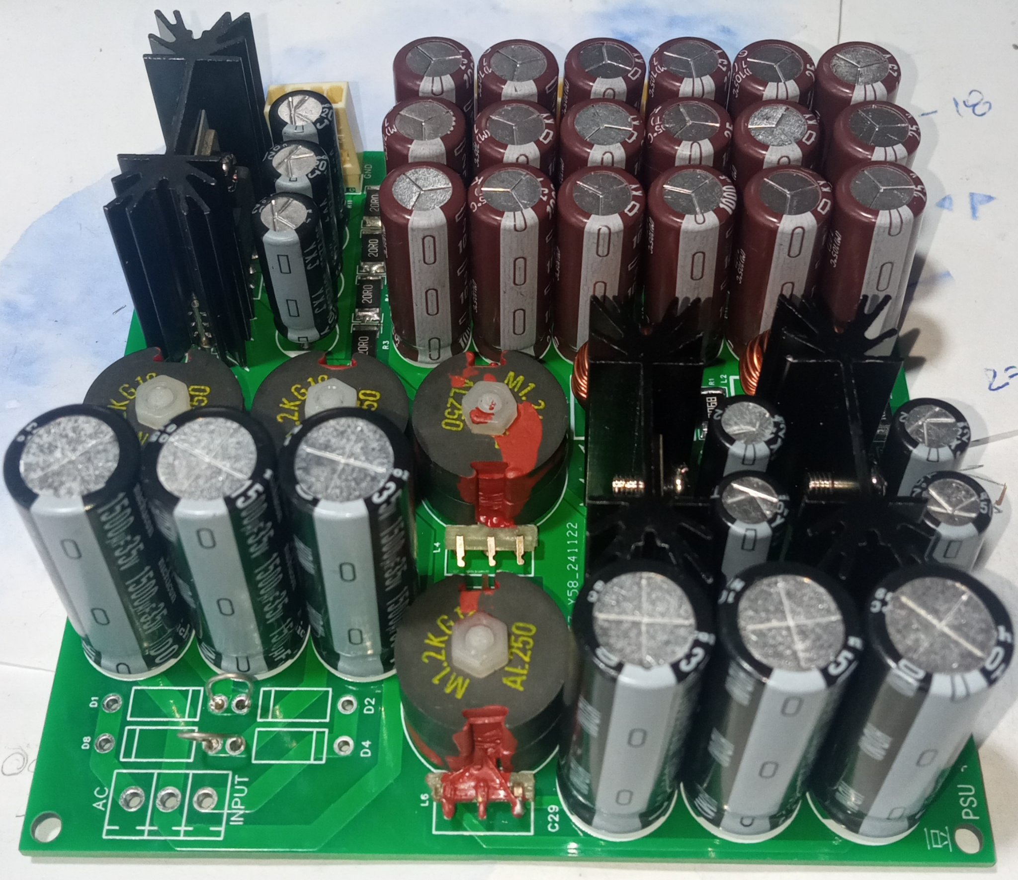

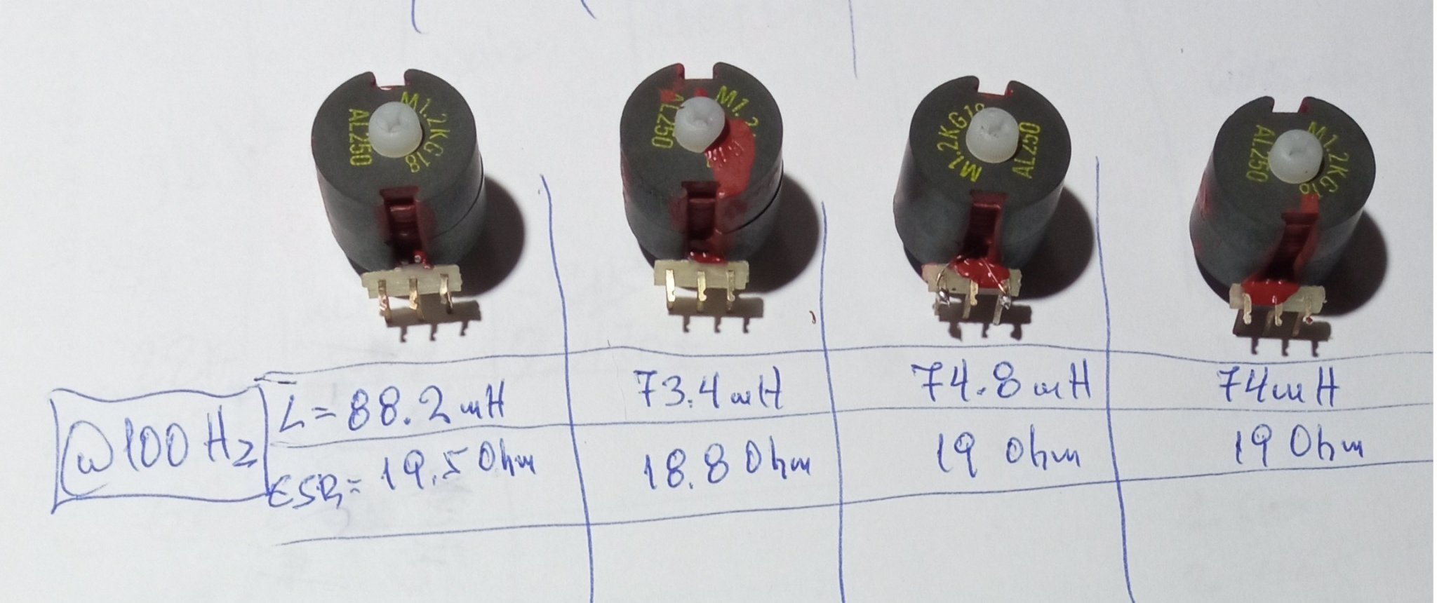

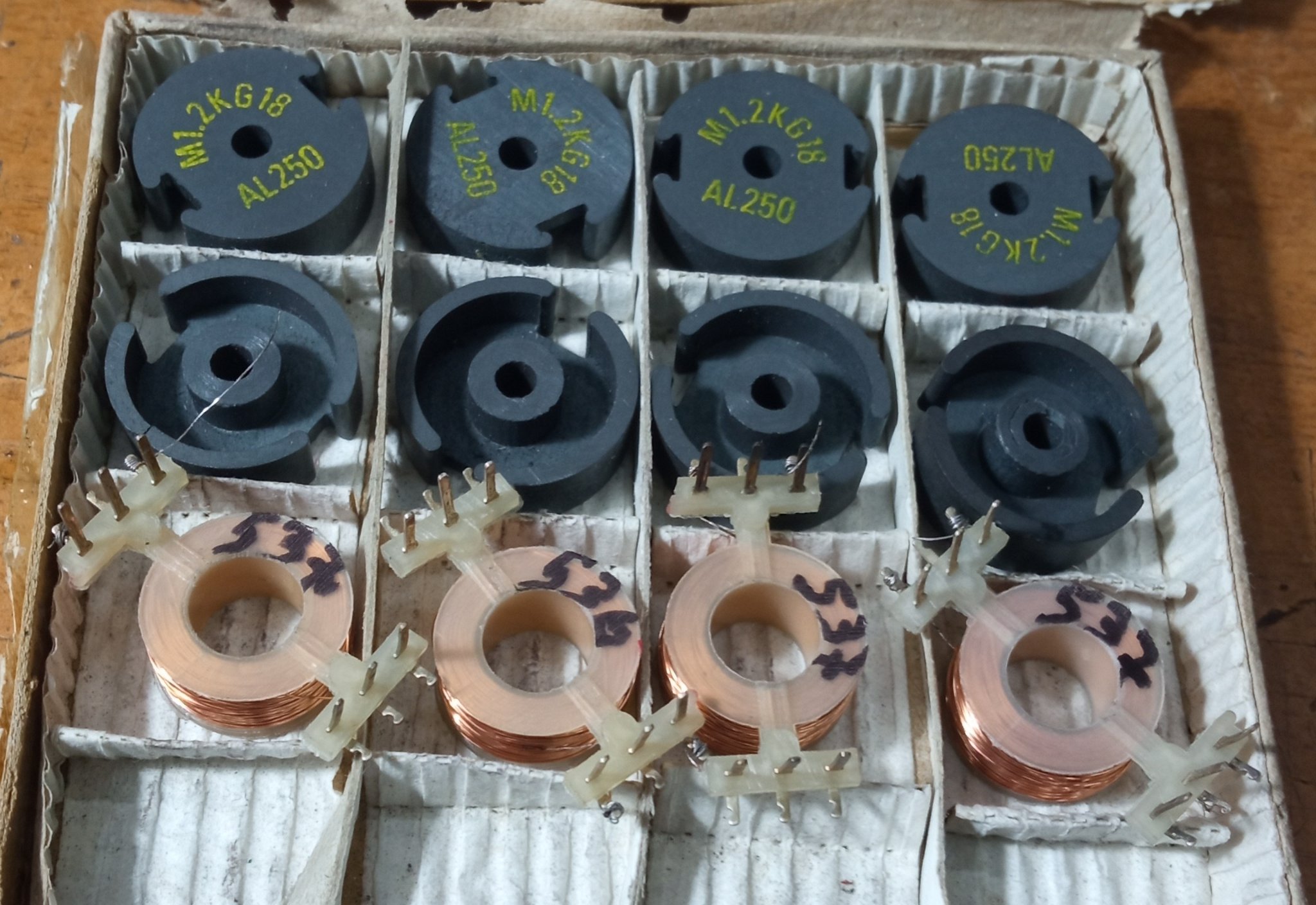

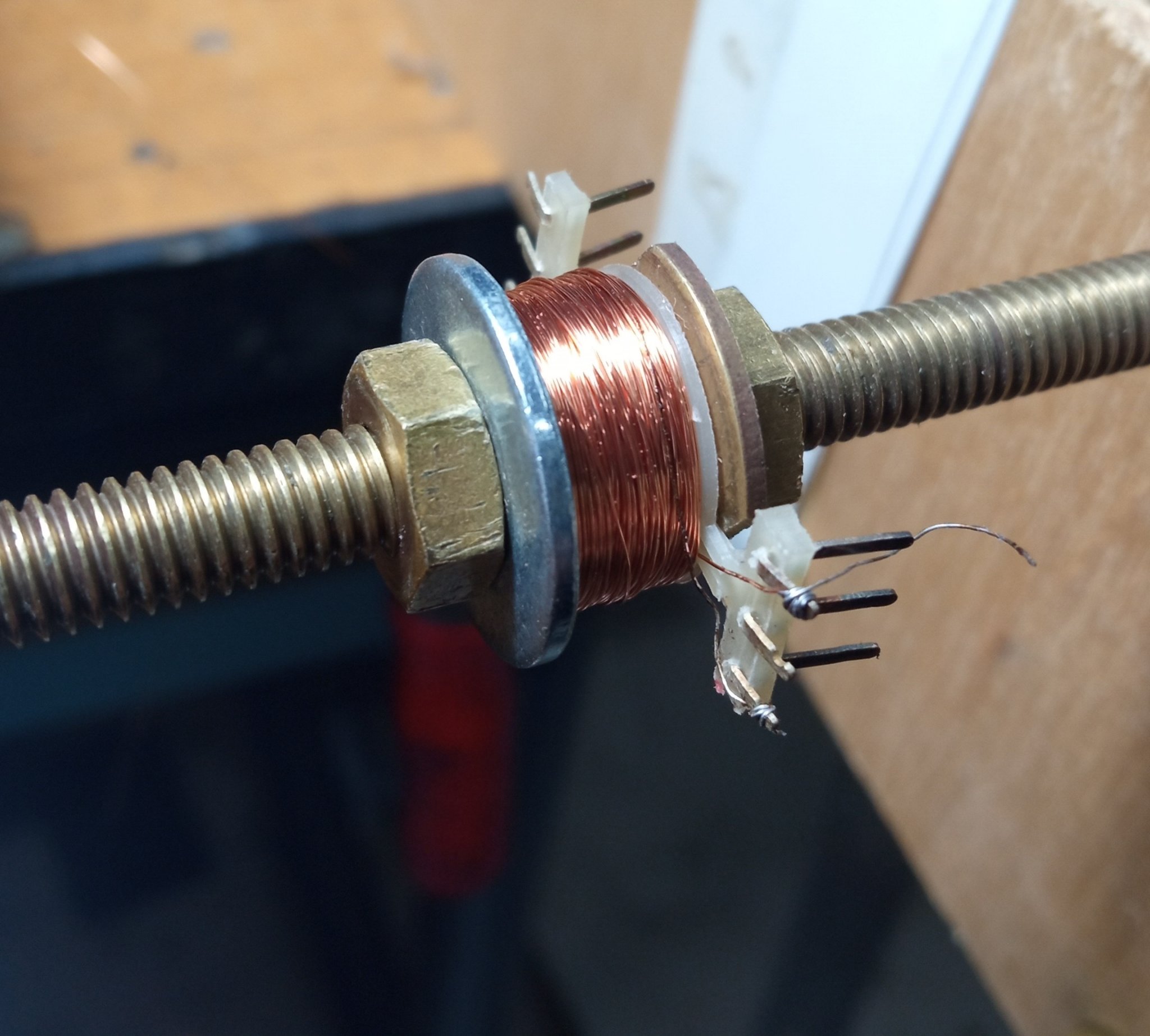

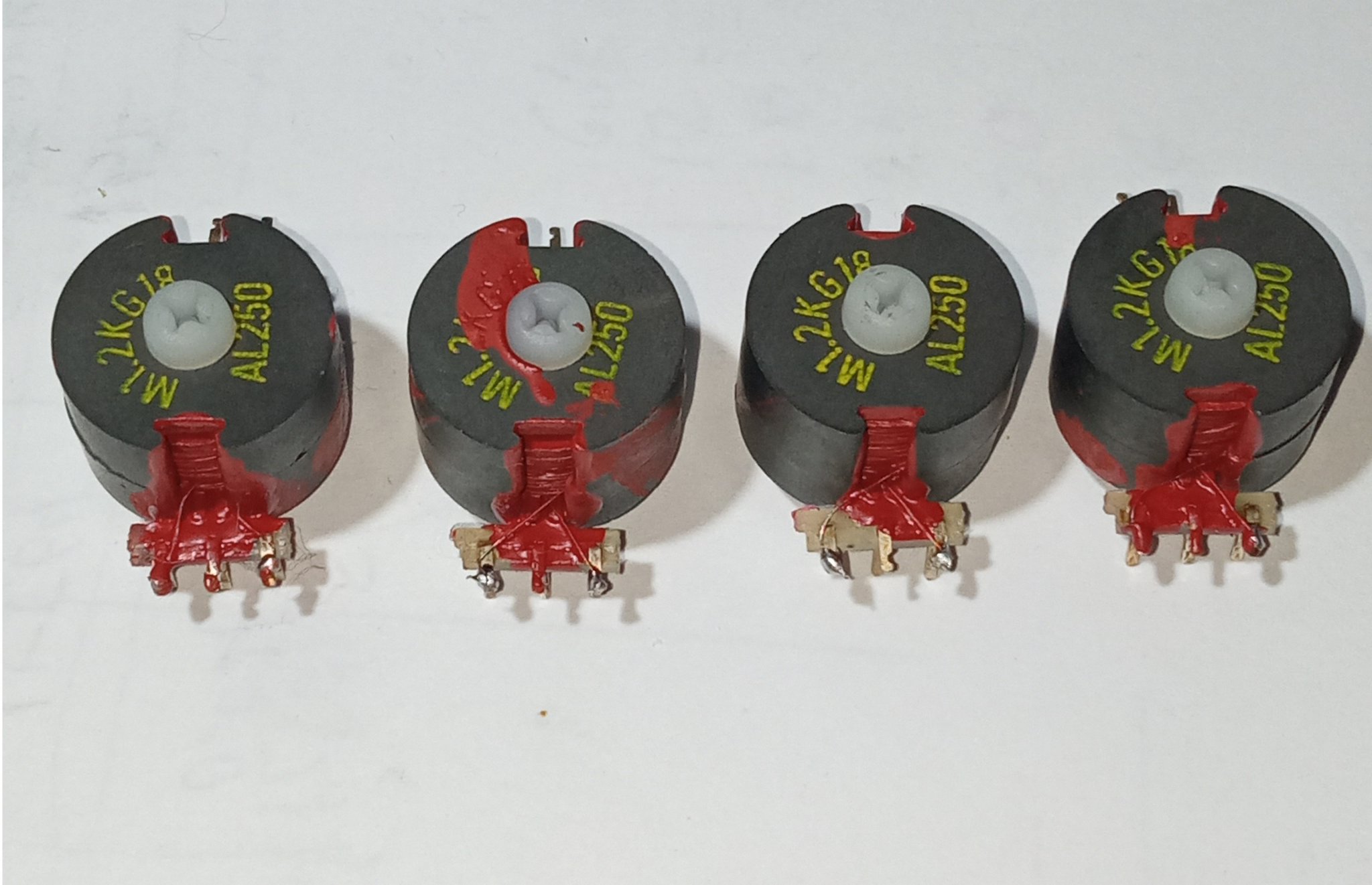

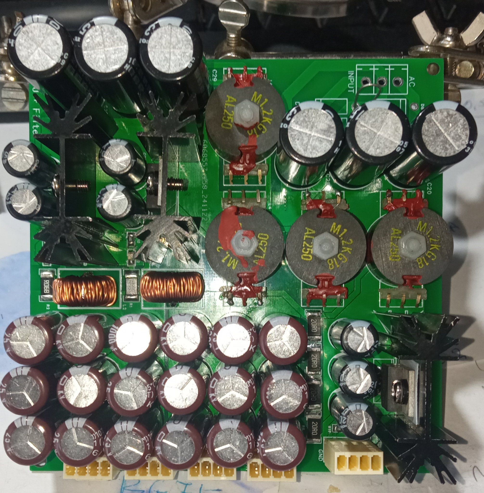

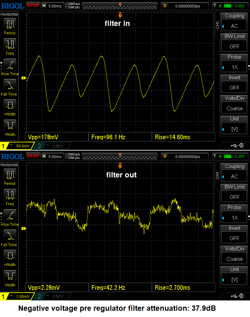

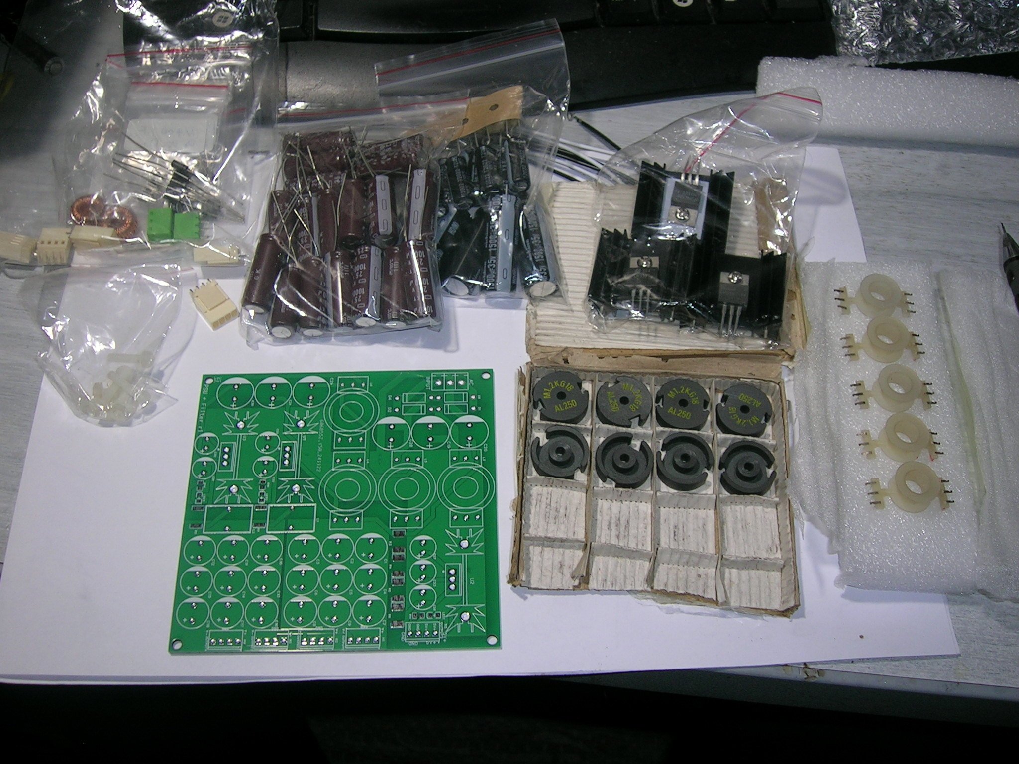

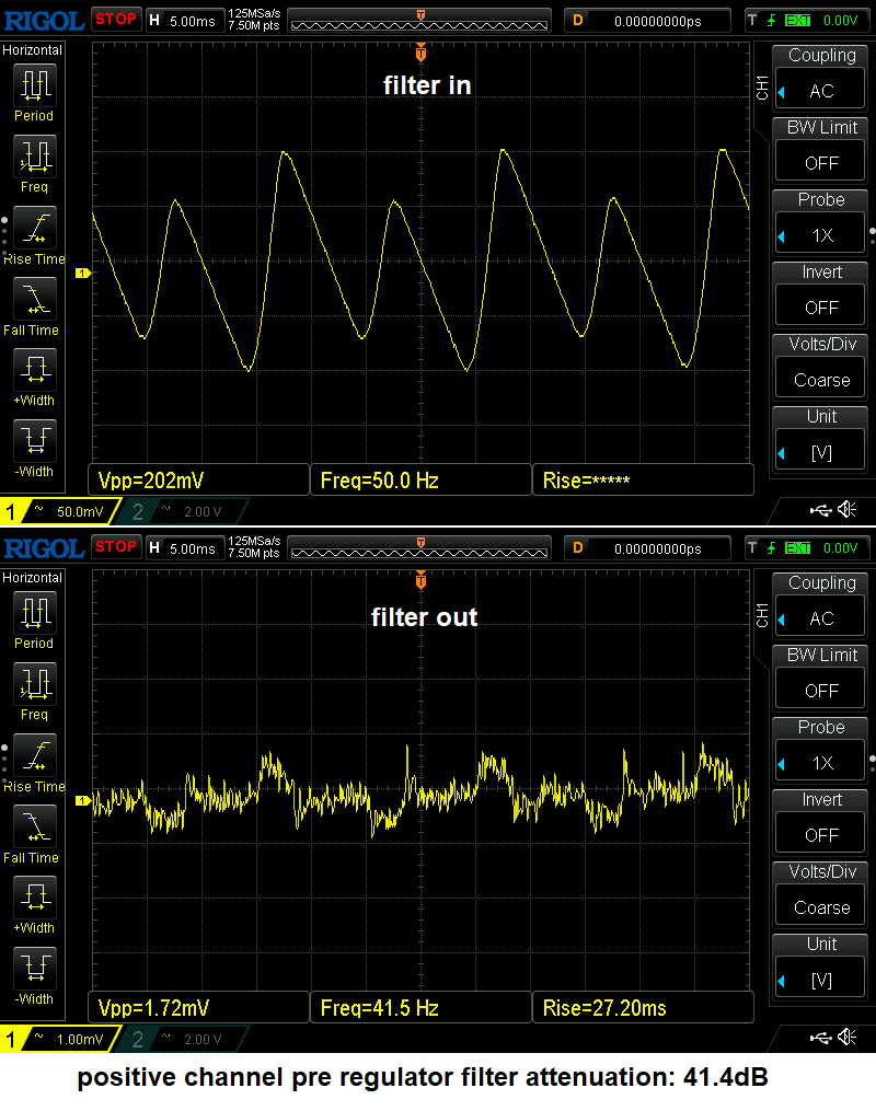

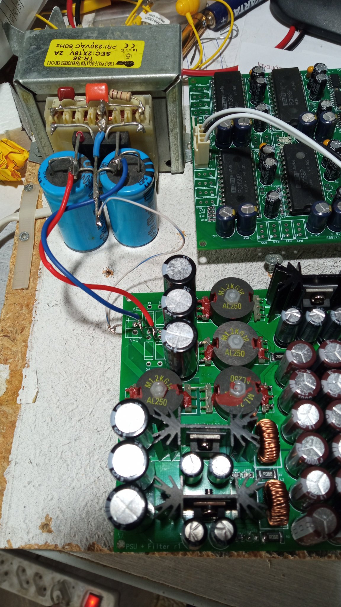

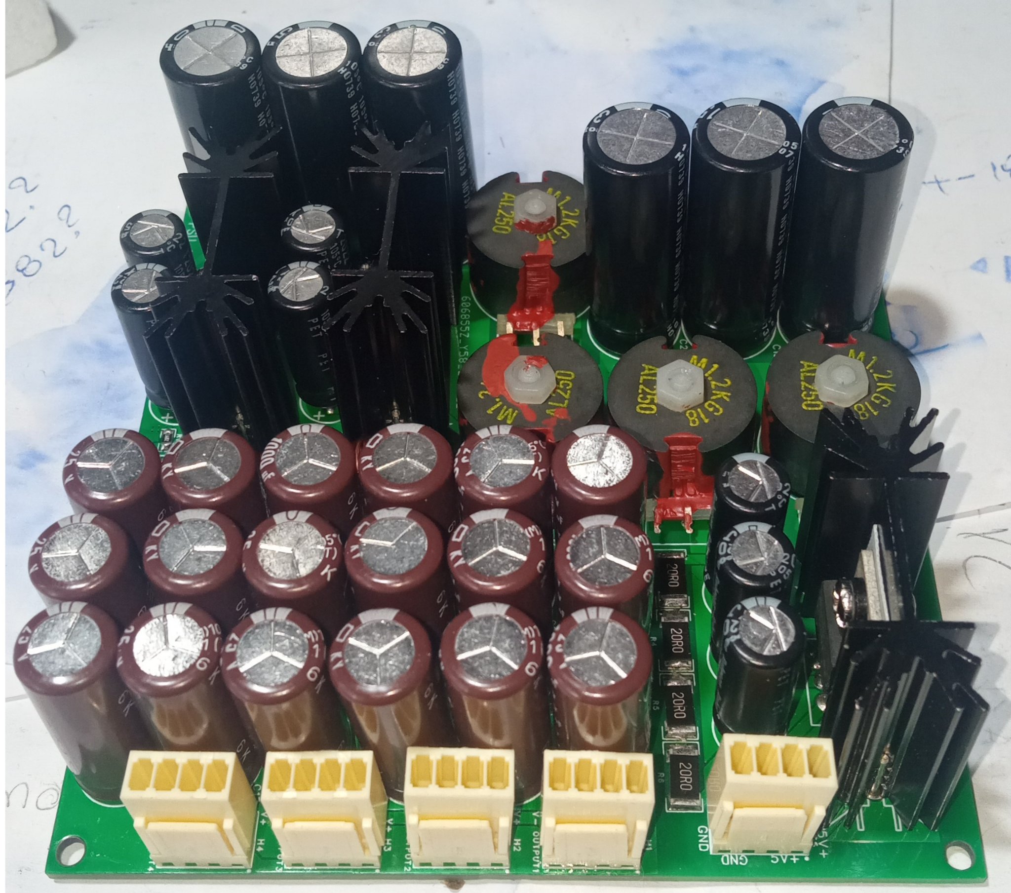

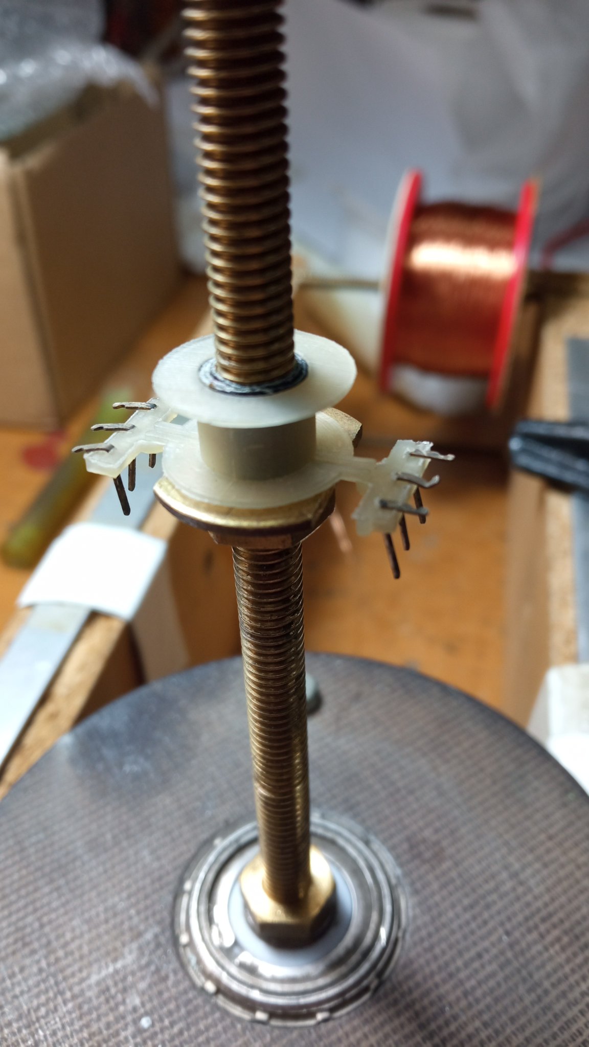

George - you're quite gung-ho in your choice of 0.15mm wire, the thinnest I've gone for is 0.19mm in my PSUs 😳 Your ESR measurements are of ~19ohm for the DCR so with a typical current draw of 140mA you'll get about 2.7V drop across each inductor. As there are 2 inductors in series on each rail I estimate you'll need a rectified DC around 29V. Do you get the same from your math? I look forward to learning how low a ripple voltage you achieve at the reg inputs🙂 Lovely pics, eye candy indeed especially with the added red 'paint'! May I enquire what that is?
Hi Richard
You are right of course. I get 5.5V drop across the two inductors on each rail.
With a 2x18Vac transformer, the rectified DC is 2X25.5V, so the regulators input is only at 20Vdc. :nownow:
I will rewind the burned primary of a 2X24Vac 3A transformer I have here, so the regulators will have enough headroom (Vin-Vout).
As for the ripple reduction of the CLCLC pre regulator filter, see attached oscilloscope screenshots :up: (capture is X2 average)
The red paint is motor/transformer varnish.
:wave2:
Regards
George
