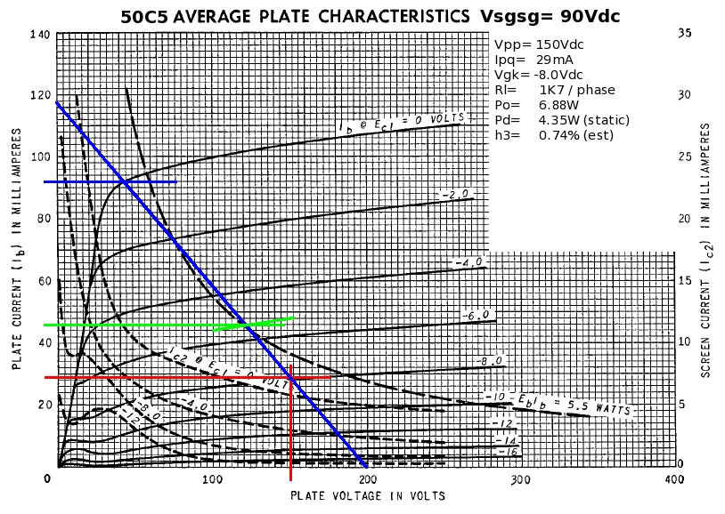

Take a look at schematics for the Marantz 9, Dynaco MkVI, Berning EA2101 for starters. It's a pretty simple thing to do, but you'll want to verify how the doubled input capacitance of the output stage will affect the amp's open-loop response.
50C5s work pretty good with some slight spec busting, and getting the screen voltage down (the spec sheet actually gives two sets of plate characteristics, one for Vsgsg= 110Vdc and for Vsgsg= 90Vdc). For this loadline (attached) you have an Rl= 1K7 per phase. If you wanted to parallel finals for more output, the voltage would stay the same, and the current would double. That means you would then need: Rl= 1700 / 2= 850R per phase. Your OPT would then need to match your speaker load to: 850 X 2= 1700R (P-2-P for Class A operation, as per the loadline). 50C5s were designed for Class A operation, and should sound quite good with a decent OPT (very rare indeed, considering what 50C5s were almost universally used for back in "the day") a regulated screen supply, fixed bias and some NFB. Being that it's a good Class A VT, you could make the PP final a differential with active tail loading so that it does double duty as a phase splitter.
Four 50C5s (two in parallel per phase) should get you about 10W of output.

Ok, I've run into a snag while doing calculations... When calculating the plate voltage and Imax, I keep getting plate voltages that are way over the maximum values for the 50C5 tube.
According to the book, the equation that I need to use is: Imax x Eb = 3.125 x Pout
Pout being what the desired wattage of the amplifier... in this case, I'm going with 6.5 watts (3.25 per tube, well within the max 5.5 watt limit). I get a value of 20.31 and when looking up Imax on the graph I find 132 mA plug all that into the equation:
20.31 / .132 = Eb and I get a plate voltage of about 153 volts. The max voltage for the plate on the 50C5 is 135 volts. Am I missing something important?

You don't do calculations when it comes to hollow state design. That only works for solid state. To design VT circuits, use plate characteristics and loadlines.
A Q-Point of 29mA @ 150Vdc gives a reasonable Pd= 4.35W of static plate dissipation. That makes Vgk= -8.0Vdc, and since the 50C5 hasn't cutoff at Vgk= -16V, it's operating in Class A. So draw a Class A loadline from the Q-Point to the Vgk= 0V line to make sure the loadline lies within the saturation region. That intersects at Ip= 92mA, and since Ip= 2.0mA @ Vgk= -16V, the total current is 90mA (since the primary of a PP OPT responds to differential current only). This gives:
I= 90mAp
I= 90E-3 / sqrt(2)= 63.64mArms
Po= (63.64E-3)^2 X 1700= 6.89W
The OPT needs to match the speaker load to: 3K4 (plate-to-plate) to stay within the conditions the loadline prescribes.
"I get a plate voltage of about 153 volts. The max voltage for the plate on the 50C5 is 135 volts. Am I missing something important?"
One thing: VTs are a good deal more "forgiving" than solid state. Busting that spec by a mere 15V isn't going to cause any problems at all. (If anything it might ferret out marginal, gassy 50C5s.) Look at what George (TubeLab) is doing: going just 15V beyond a plate voltage rating is nothing. It allows you to hit a more linear portion of the characteristics, and that's all for the better, sonic-wise.

So, after some poking around, I think that I'm understanding that a 4-tube Push-Pull output section is two tube pairs in parallel between the phase splitter and the output transformer. And the transformer has to be able to handle the doubled current and wattage.
Feel free to correct me if I'm wrong.
Yes. When paralleling tubes multiply all currents in datasheet (including on graphs) by the number of paralleled tubes. As if you have a N-times fatter tube. Actually, some TV horizontal sweep pentodes contained 2 in parallel inside of one bulb.
http://www.triodeel.com/6ch6amp1.gif as an example. Obviously with the lower B+, the previous stages will have to be reworked.
Thanks Tom. The "Spunky" has the sort of output stage I'm looking for. Though I'm not so sure about the heaters being powered straight from the wall.
