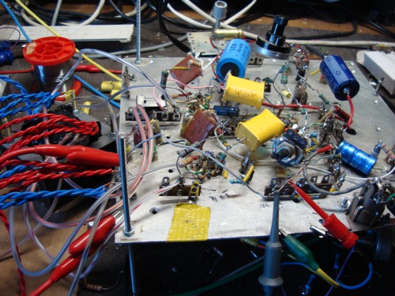

I hope your amp isn't like the pic.
richy
