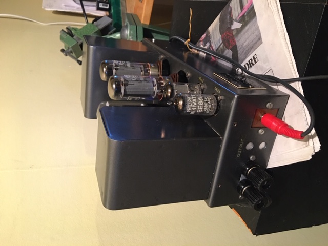

Been looking long and hard and just cant see how I can fit an iec socket without cutting the chassis.I would prefer signals at one end and mains at the other.Can fit a phono connector where the 6 pin Morgan is and the binding posts where the 2 pin main input is.Or maybe put rca input where one output socket is and fill the other one in.

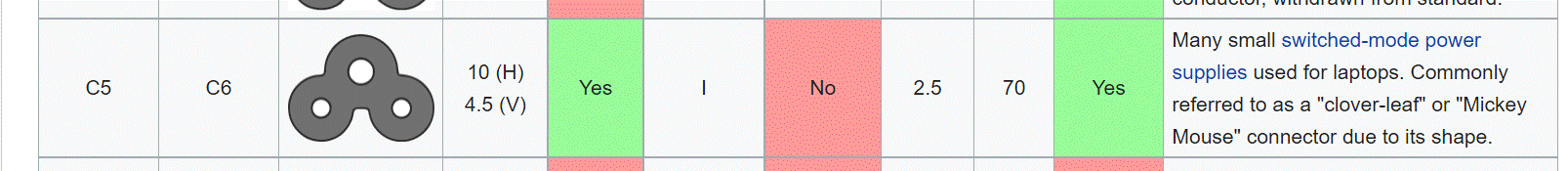

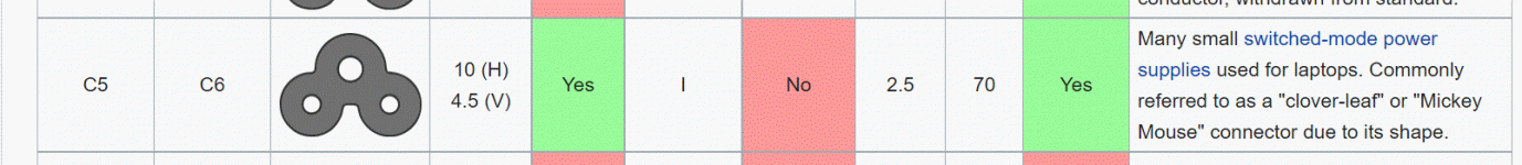

Use the cloverleaf style laptop IEC connectors (C5 and C6).

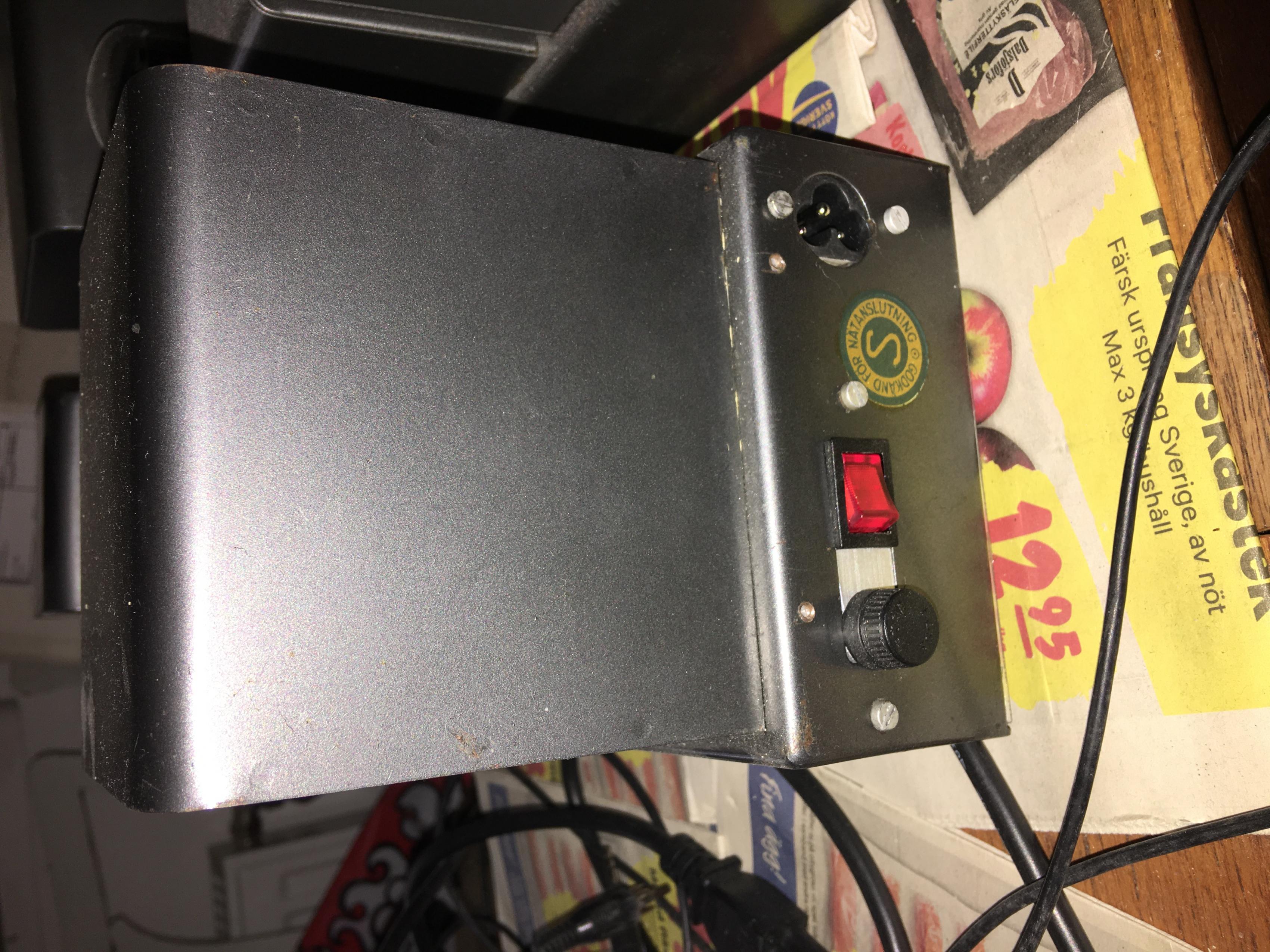

Mount the socket on an aluminium plate. If you really want to not make any holes it would be possible to use the power selector bolt hole, and two of the maker's plate holes on the side. I drilled two small holes, plus one more for an earth point, next to the fuse holder, on the side of the amp.

I’m not entirely clear why you’re adding phono jacks if you have a 22? The power amps don’t have a blocking cap on the input as that is handled by the 22. If you change it to phono you’re going to want to add a blocking cap to the input, but that may mess with the 22 input, depending on where you put it.

Need to use the 22 until I can add phono sockets etc to the power amps.Only have 2 sources and they both have dc blocking output caps.
