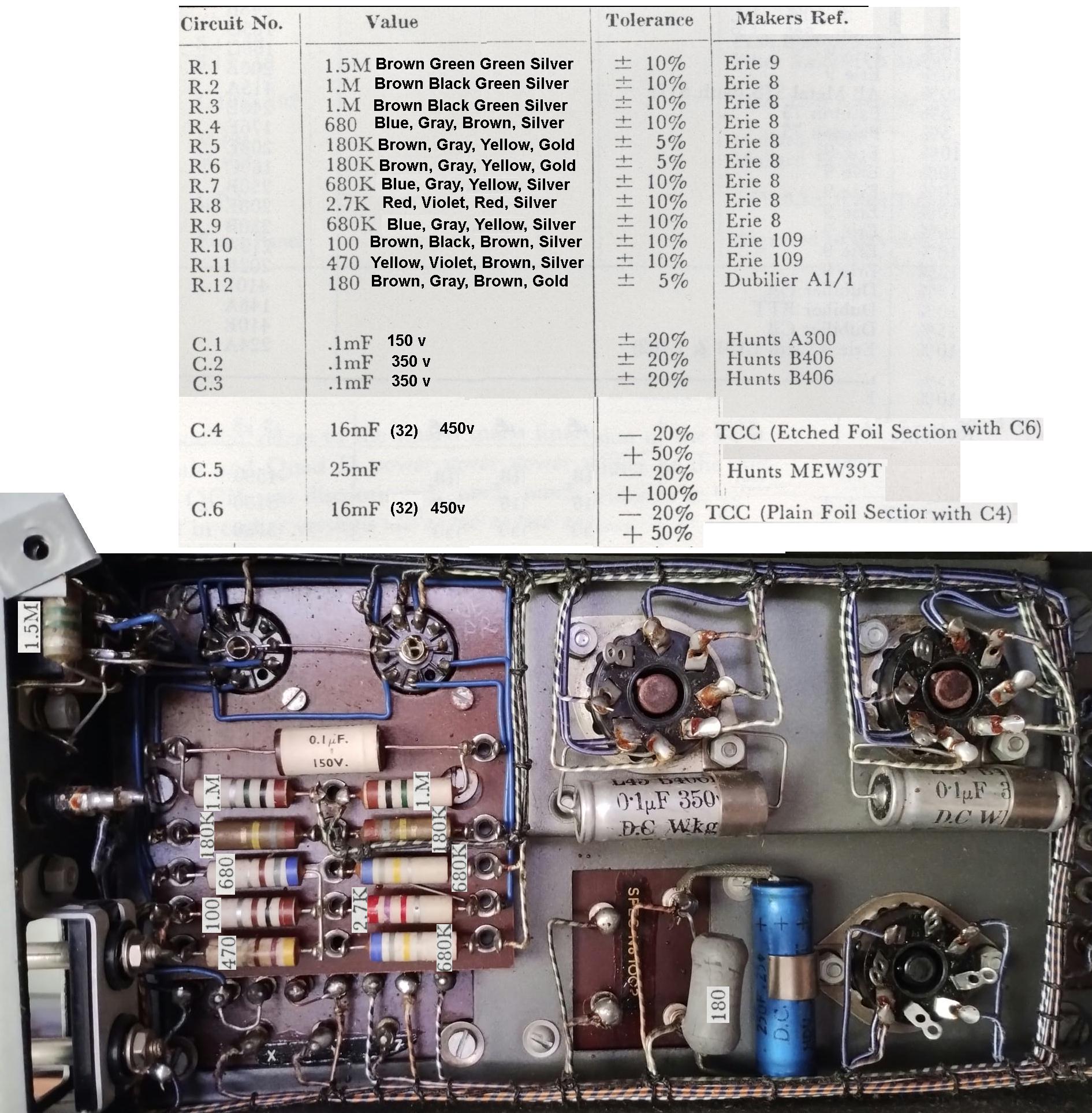

I´ve just dismounted the box TCC Dual condenser, and I think I´ll refrain from opening it and to as Anatech suggests in his attached picture of the new dual cap.
Anyway, I´ve figured out all the resistor codes, and printed the components list out for the visit to the electronics dealer tomorrow.

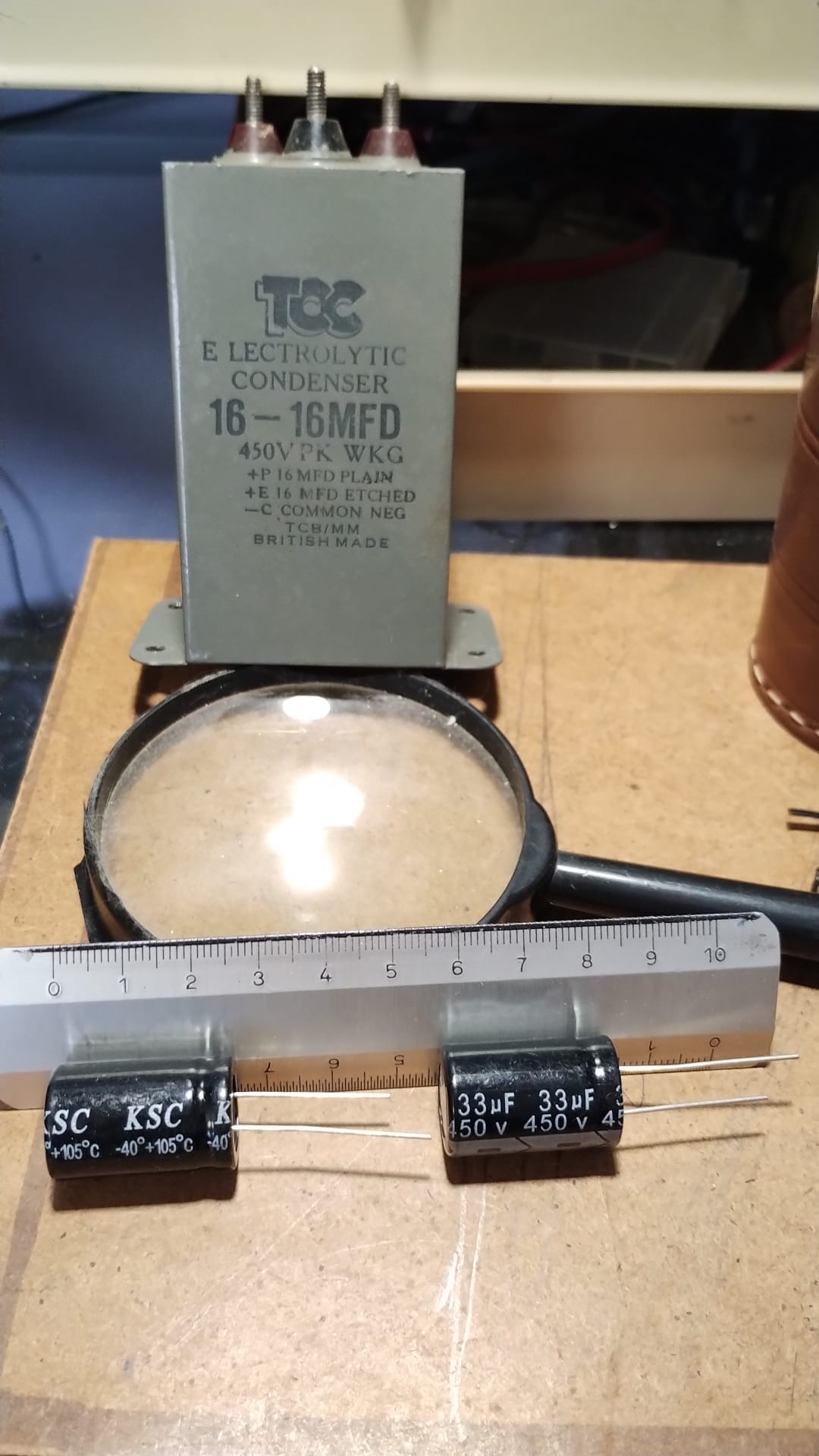

Hi Anatech,
I was just looking at your "Complete.jpg" photo in post #23: The big new blue 32 microfarad capacitator seems to have two connectors that are obviously different from the old TCC Dual box-type cap with three connectors, i.e.
+P, with a single wire connected,
+PE, with two wires connected, and
-C, the common negative in the middle, also with two wires connected.
From what I can see, the new cap has two connectors, one with 3 wires, and one with two. It looks like the single wire goes to the positive terminal of the new cap, so the negative terminal must get the two negative wires previously on -C, the old common negative. Then, the remaining two wires previously connected to +PE are seemingly now also connected to the positive terminal of the new cap. Am I right?

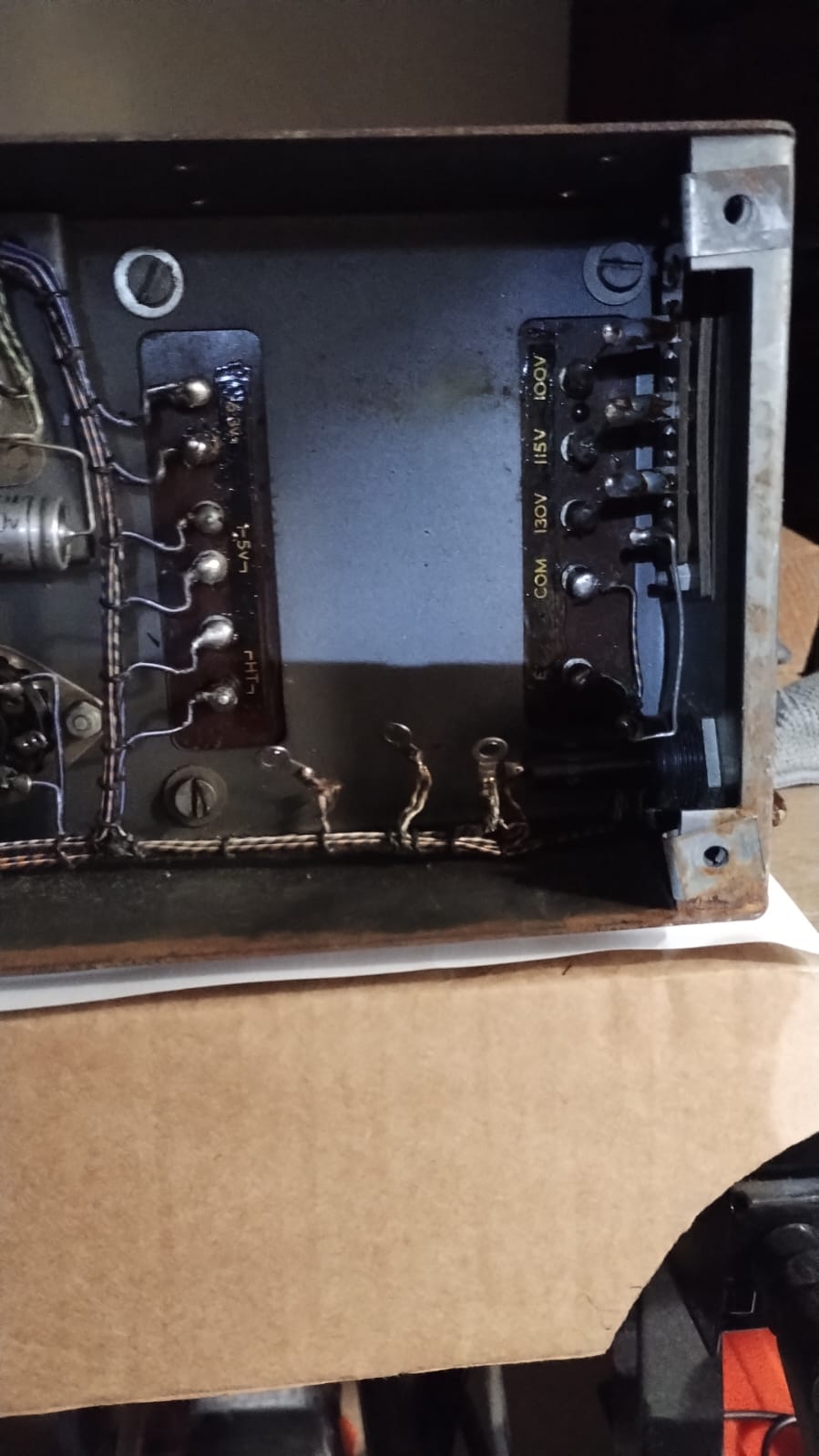

No, they are next to the terminals on the OPT.The A to H letters on the OPT would be inside the biggest metal box, I gather,
There is no reason whatsoever to replace the dual cap unless it’s faulty. The main failure mode is a short to ground.
Hi aleatorylamp,
The common terminal is hidden under the others. It was connected exactly the way the originals were.
The two capacitor sections have a common terminal as the original does. I just desoldered the wires from the ring terminals and connected the wires directly to the terminals on the new capacitor. I have seen people unscrew the ring terminals and solder the entire mess to the new capacitor(s), then glue that mess down. Lazy as heck!

I'll disagree with you on the reliability of those older capacitor assemblies. I see them go open often enough or reduced capacitance with high DA. If the capacitor measures fine for both capacitance and DA, I'll leave it. If one of a pair needs a new capacitor, they both get one. That keeps them the same as the new capacitors have higher capacitance. So we agree on the defective part, but I measure them more closely to avoid near future failures.

Well... Next to these terminals, there is: A pair marked as 6.3 v., another pair marked as 5 v, and a third pair marked as HT on the inboard side, and on the other side at the end with the 110 V selector and the fuse, there´s E, COM, 130v, 115v, and 110v.No, they are next to the terminals on the OPT.
I began unscrewing the big OPT box to have a look for the letters inside, but soon left that alone as it became clear that all the terminals were soldered to the OPT, and the OPT was screwed to the box... Slap on my fingers with a ruler!

Thanks for the clarification! So the 3 contacts on the new capacitator are the same - no problem then.

That’s the power transformer (PTX). The letters refer to the output transformer (OTX) at the other end. No need to remove either of them.Next to these terminals, there is: A pair marked as 6.3 v., another pair marked as 5 v, and a third pair marked as HT on the inboard side, and on the other side at the end with the 110 V selector and the fuse, there´s E, COM, 130v, 115v, and 110v.

Hi ejp,That’s the power transformer (PTX). The letters refer to the output transformer (OTX) at the other end. No need to remove either of them.
Oh wow! Sorry about that. I didn´t see it, did I? ...and, I didn´t really know what OPT or OTX was either.
Anyway, I just saw the letters pretty well hidden under the resistor rack board. They are: P, Q, R, S, T, U, V, W, next row X, Y, and Z.

Then, all capacitators do look pristine, but who knows... Now that I´m at it, I´ll change them as well. Pity about the old stuff if it´s still good, but I don´t want to have to open the thing again.

That´s the way it looks. The two 680K resistors won´t move the needle, and the 470 ohm one is cracked., and my voltmeter´s x10k position is broken, but the needle moves ever so slightly for the 1M and 1.5M resistors. The others seem OK, but I´m changing the lot.The amp will be a simpler proposition to update.

Today's parts are a lot better than the old ones, more stable for one. Capacitors, we have come a long way, especially where leakage currents are concerned.
So for the amplifier circuits, go with the higher power Metal Film resistors (1 watt minimum, 2 watts if you need the higher voltage rating). Check the breakdown ratings in the data sheet before you buy. You'll probably end up with mostly 1% values, for the power supply dropping, Metal Oxide are fine, 5% values. Small capacitors. Polypropylene. Higher voltage ratings are fine and this type has very low distortion. May as well. For the other electrolytic capacitor, and axial rated at higher voltage. They are better capacitors and higher voltage makes them closer to the original size of part. 85°C parts are perfectly fine in your amplifier. 105°C parts are sometimes not as good, so do not assume they are automatically a better part.

I went to my local store, and they are preparing the order for the Amp resistors and capacitators. They had no big round dual ones for the 32 mu substitution of the 16 mu ones, in fact no dual ones at all. Their supplier´s manufacturer apparently doesn´t make them and they are not allowed to order on the internet.
They only had 2 single electrolytic 33 mu (450v, -40º + 105º) condensers, 2.5 cm long and 1.5 cm wide. They only cost 90 cents each. See comparison photo. If these won´t do, given the seemingly good condition of the original, possibly that can stay onboard...
Regarding the resistors, they are getting me 2W ones where possible, or else 1W, for tomorrow, and also the other 4 capacitators. It won´t be expensive.

No, get the dual caps. Order them. If I saw those in a unit, they are on the estimate for replacement.
