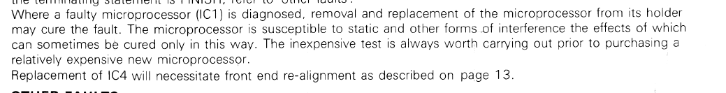

Hmmm. I thought it worked OK tbh without the battery 🙂 from the earlier post or has the fault changed a little:
So... I think you have to try a chip to prove it one way or the other.
without battery goes to tune at power on as it should, with battery back on it behaves as before

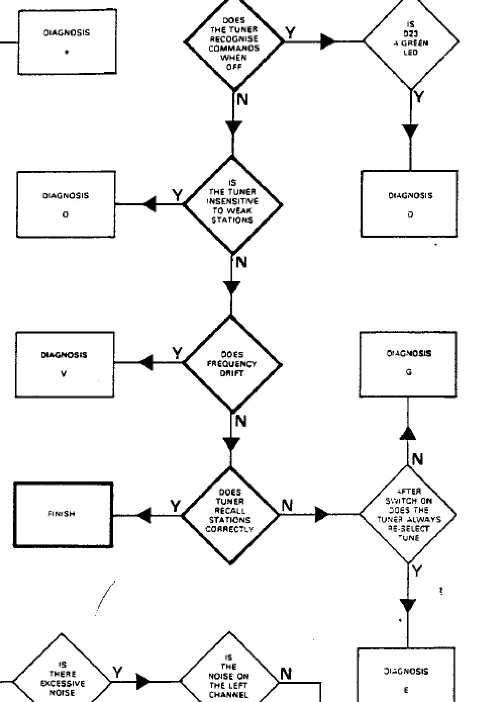

Have you tried the FM4 service manual diagnosis chart?
The Sevice manual is in the public domain, and look at page 9 for a chart of differential daignosis
https://www.dadaelectronics.eu/uploads/downloads/02_Quad-Service-Manuals/Quad-FM4-Service-Manual.pdf
I think the problem lies in this group (extract from chart below), and what follows in the manual are pages of the fine details on assessment and fix.
ATB!
ATB!

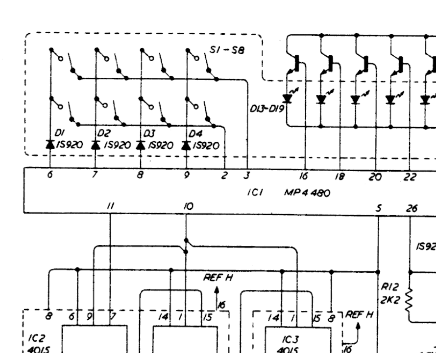

Could it be something as simple as a problem with the keyscan to the uP? Something like a leaky diode (DI-D4) or a leaky switch or conductive goo on the switches?
Might be worth desoldering the four diodes D1- D4 and also pins 2 and 3 of the uP and seeing how it behaves.
Sorry for late repply but had a problem with my net, so, i´ve done everything, changed all diodes changed ic5 dessoldered the pins 2 and 3 and is allways the same. So my guess will be ic1 unfortunately
I think you do have to start to suspect the chip at this point unfortunately 🙁 Perhaps keep a look out for a damaged FM4 going cheap.
