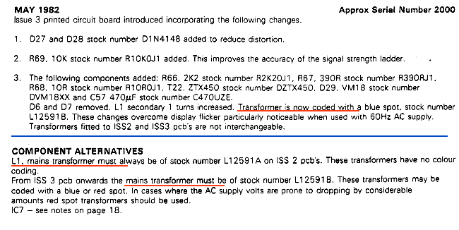

PRR Member Joined 2003 Paid Member 2019-11-03 5:39 am #21 2019-11-03 5:39 am #21 Mikeymoo said: ...This will be the 3rd one ... Click to expand... Tell QUAD. The service manual lists several changes in the power transformer. While it is not clear any of them relate to burn-up, they would/should know best. I'd also wonder about wall voltage, yours and any previous owners. Attachments QUAD-PT.gif 19.8 KB · Views: 99
