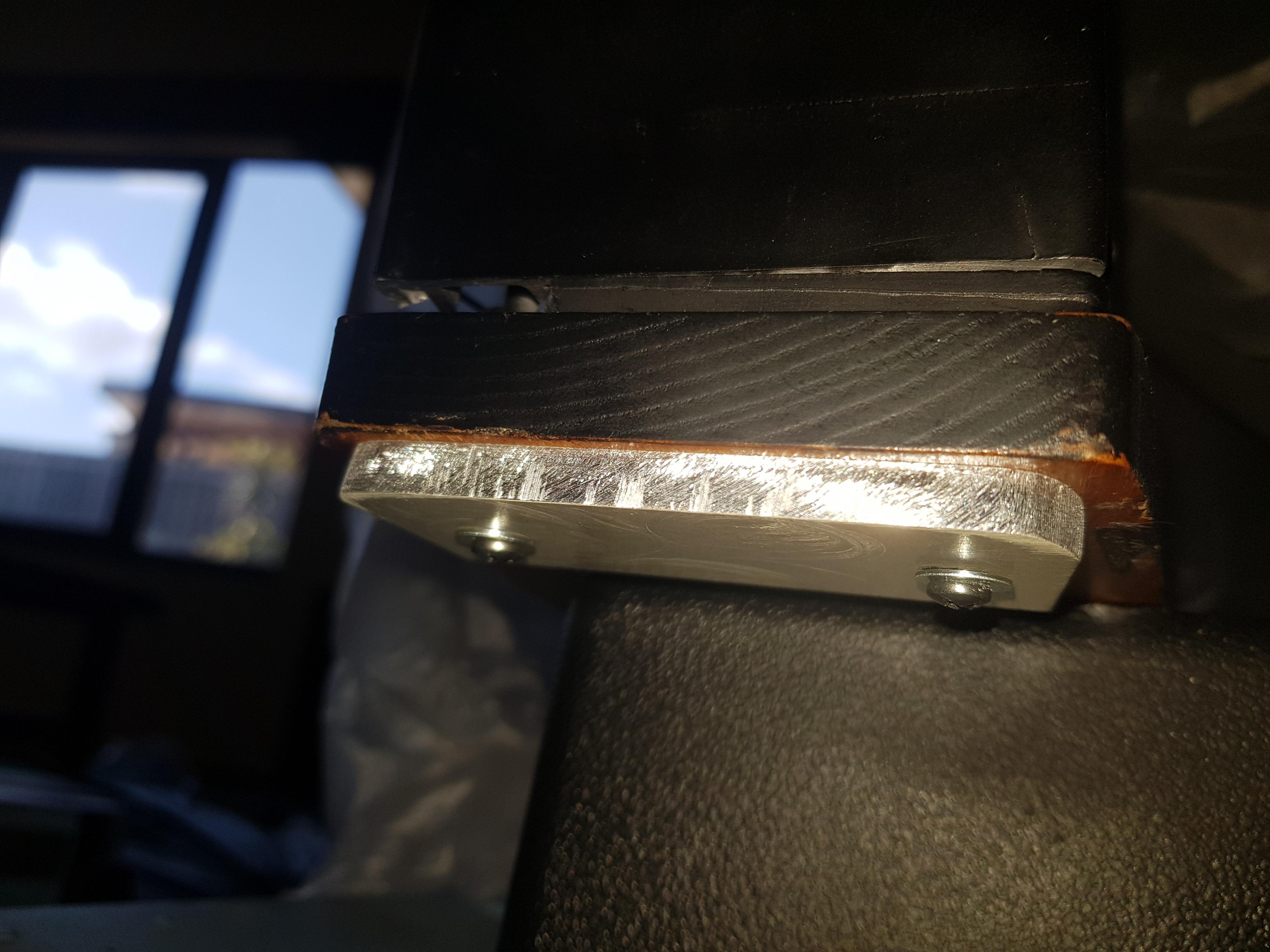

Sheldon, I bought some Spandex material and made a 84cm diameter sock. Its a fairly tight fit and I had planned on fixing it to the base of the wood and then screwing an oak trim around the edge of the wood. The top would be as the original. Can you see any issues with this? The picture shows how I fitted the aluminium plates to the underside of the base wood panel. The previous owner had put screws through the wood on one side. You can see the missing edges of the plastic base plate which I need to fill.
kffern

Ah, the plastic base you are talking about is different. You are talking about the bottom piece of the panel assembly. I thought you were talking about the speaker base or plinth that houses the electronics. Yes, the corners of those end pieces break when they are roughly shipped. It doesn't help that the metal vertical pieces are held to these plastic end plates using flat head screws which pre-stress that plastic in tension and get it that much closer to yielding when the speakers in their boxes are dropped. Those should be pan-head fasteners with counterbores instead and molded in alignment features.
Yes, I have those parts, but not many of them. Let me know if your other deal is too expensive for your taste. Still can't help you with the dust cover frames though
Sheldon
