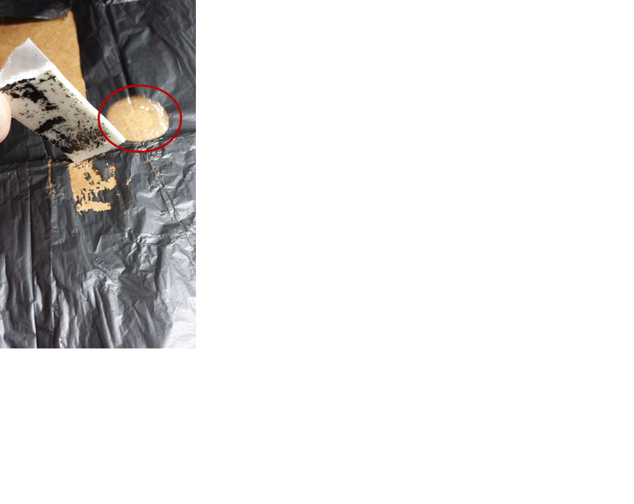

Hi im on my way refitting all menbrames. workes great untill now.
I ran in the folowing issue. when bass is played i get light sound of stuf vibrating, i could jnot find the problem but i think its the holes i made in the menbrane for the screws that go trough the panel.
i used an iron to make these howles with a template , but i can hear some tiny left overs of the foil resonating. any ideas ? to clean that up ???

the sound i hear is not the cracking they are fresh panels, its like candy wrap resonance only at higher volume with say around 55 hertz. my guess is that the tiny leftovers from making the hole with a solder iron for the 3 support screws in the middle, touching or vibrating at higher spl. mostly around the resonant frequency since it has the highes excursion there. the hole looks prety clean but the original 3 micron holes look cleaner. i tried with a heat gun to clean it up a little. FAIL, should have know to screw up the mechanical tension i aplied. when heating up in the middle the menbrame relaxes.. now my resonance frequency got down from 55 to 30. way to low, also excursion at 30 is even higher. so that panel is a bust. have to redo that one.... its funny and frustrating rebuilding panels im not familiar with, but in the end i will get it right.
someone uses other method then solder iron ?
i might try the screw, or maybe even a smaller tip then i use now ? , i can imagine 3um mylar leaves less molten mylar at the edges. someone mentioned the tiny hairs as well when using the solder iron, there are miniscule hairs you stretch when pulling the iron back. i must take a look with magnifing glass if i can find one 🙂 beacuause i did see some bigger ones every now and then and tried to remove them.
you have protected the holes when you sprayed the Licron?
This is an important point.
You don't want the edges of the holes driven by the electrostatic forces.
Note that Quad left a wide margin around the holes.

yep i aplied licron , then after i cleaned a circle, because i could not find any round stickers 🙂 i know licron is removed easy with alcohol, im pretty sure it wont condyct there, i think it where the rugged etches of my hole tiny it may look its prety anoying soundwise. i refoiled all but one of my panels with 3 Um hopefully i can do a comparison test soon, between 6 and 3 Um then we cleared that question once and for all 🙂

the topic was purely about the holes in the mylar that made noise, in the end it was some hair thin melten mylar. i use solder iron on highest setting to make the holes with the help of a metal thin template.
later i discovered that some leakage noise whas from a bit of old glue that landed on one of the spacers, so the alumnium strip did not contact the mylar all over. this made verry smal hissing noises (when listen to it closely) they are all solved. they are dead silent now when i put them on. sometimes i leave them on for a week and they sound exactly the same as if i turned them on 1 min before use.
