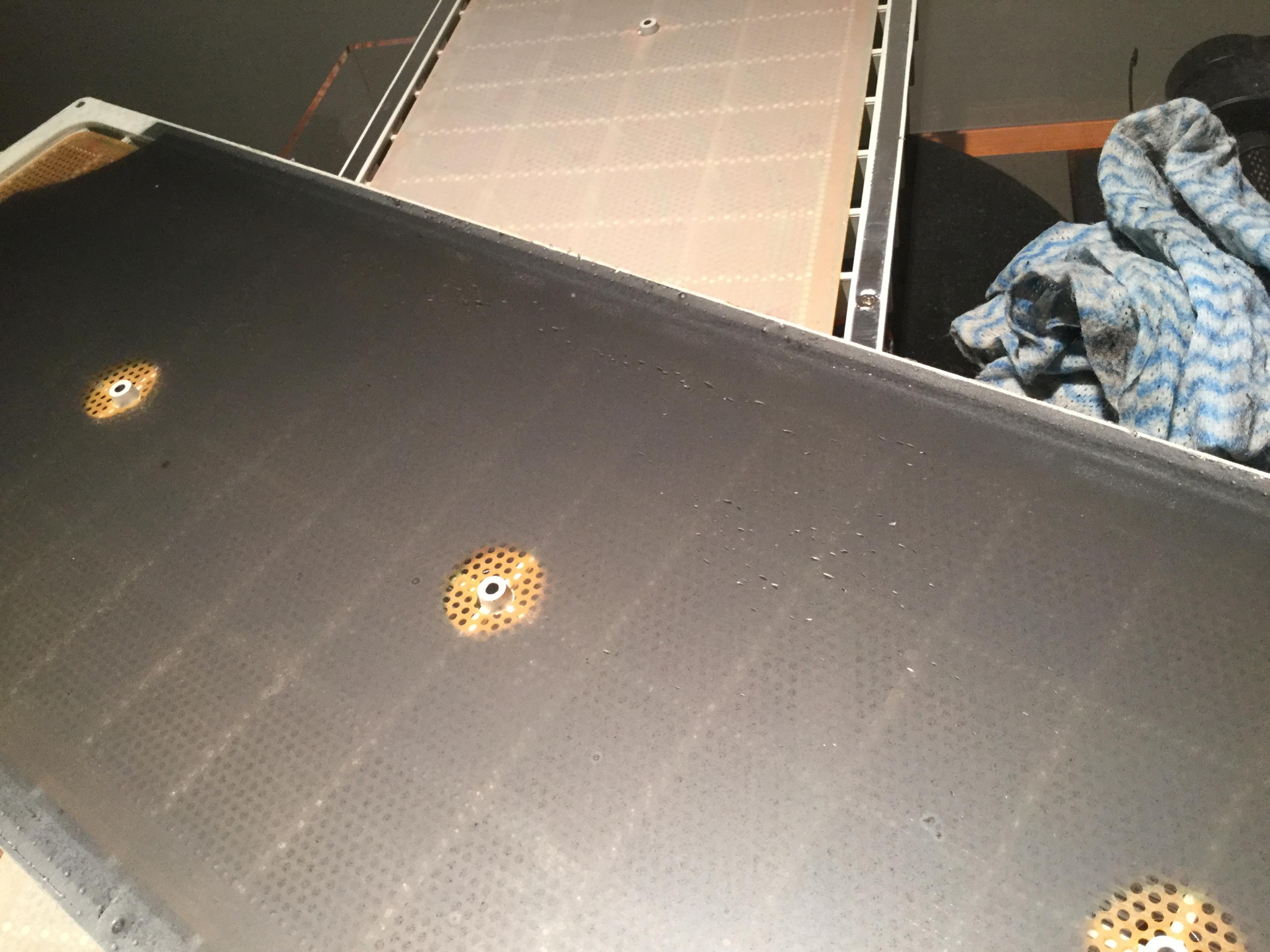

I can see a couple of little white circles on the diaphragms at the tops that look like mold growth

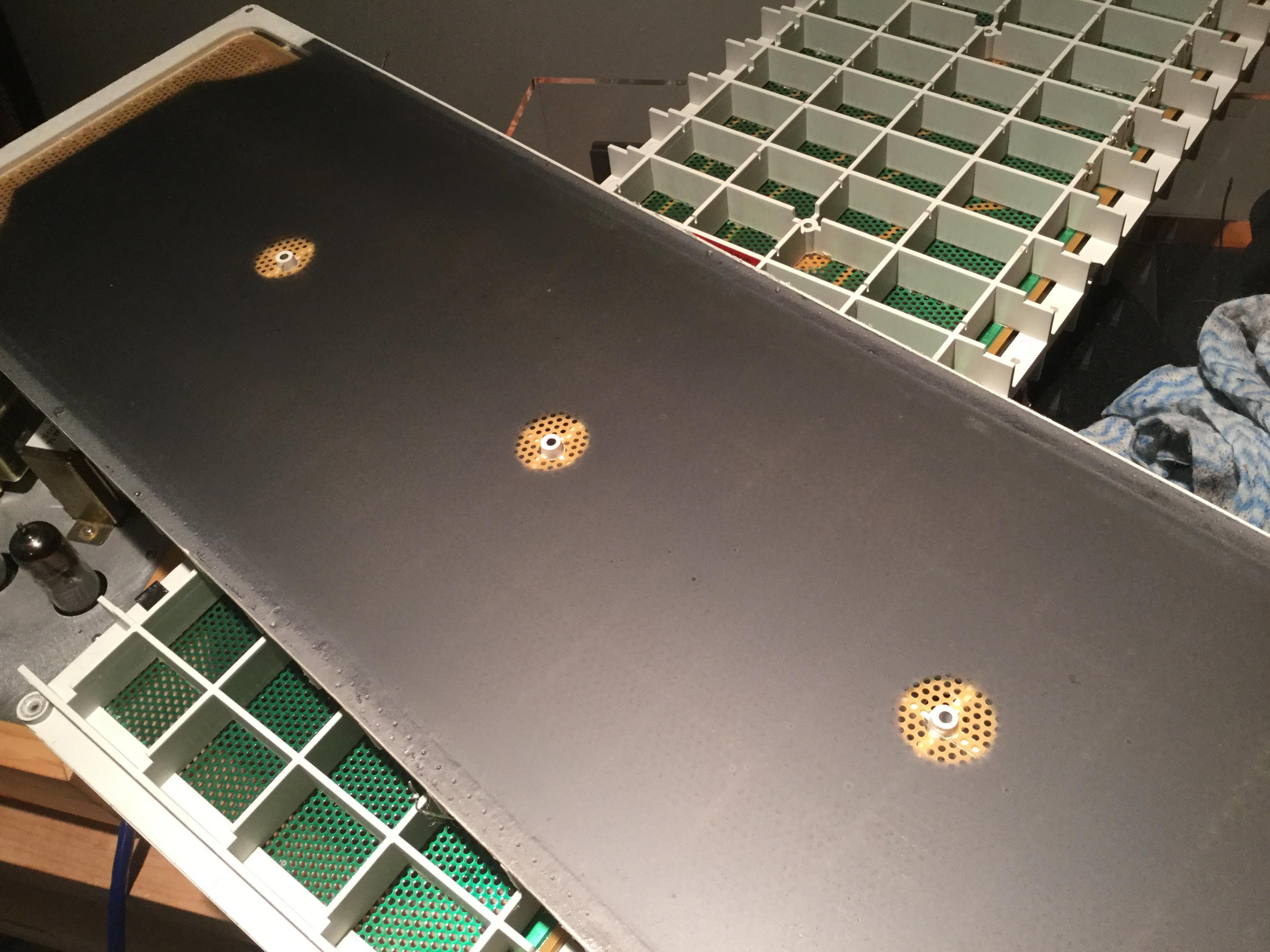

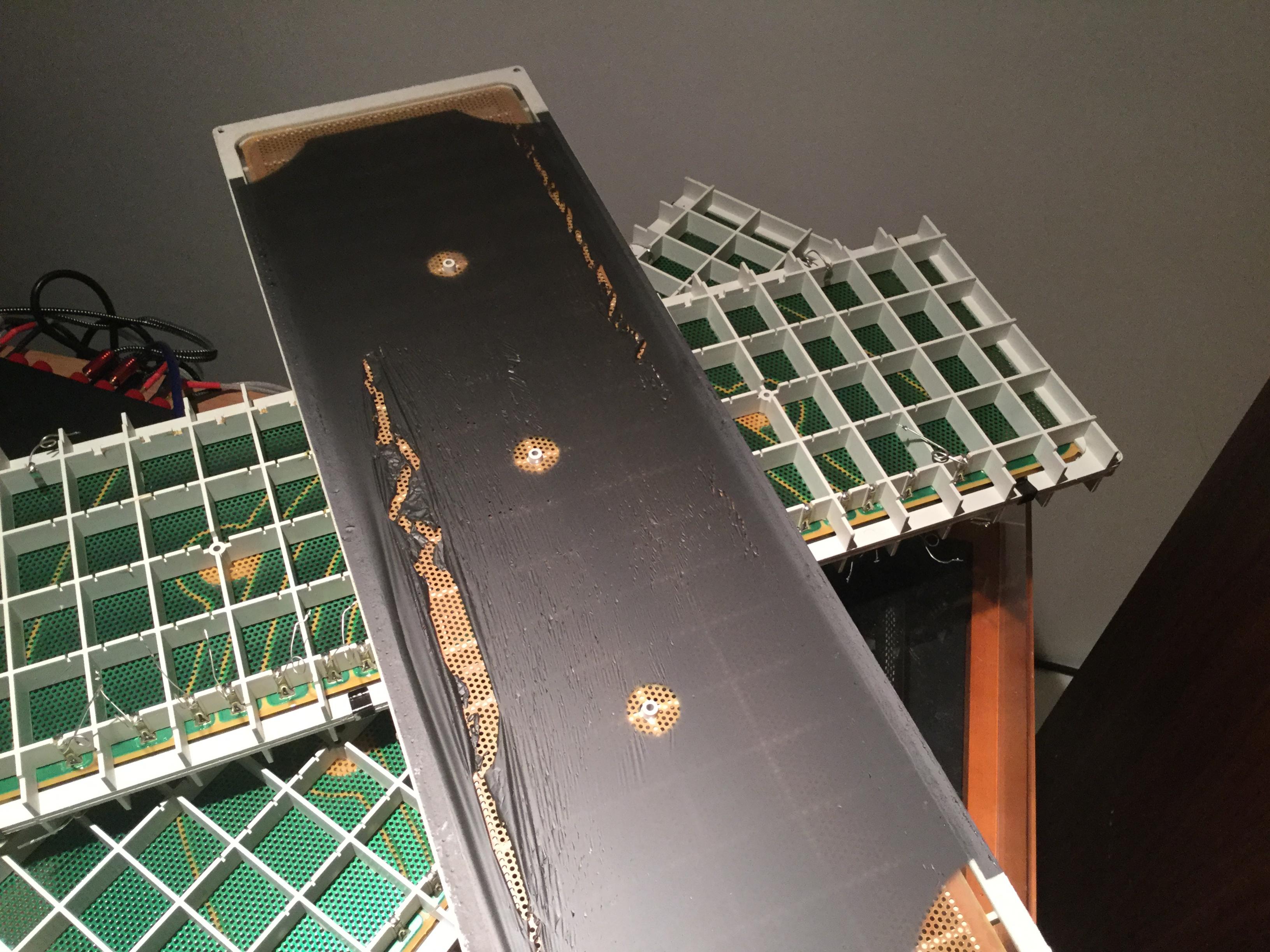

Here are some photos
1) The one with the spots is a mid panel
2) The clear one is the second mid panel
3) The destroyed one is a bass panel which I had bypassed
The difference between series of panels is virtually non-existent. You will be fine with any of the white (or off white) support structure panels.
You most likely have diaphragm rot problems with your panels.
Sheldon
Sheldon
I didn't refresh before I replied, and I see you uploaded photos. Yup, that's diaphragm rot. Not sure what makes is so prevalent in the newer panels, but it is happening like crazy now. Expect to lose your others sooner or later, I'm sorry to say.
