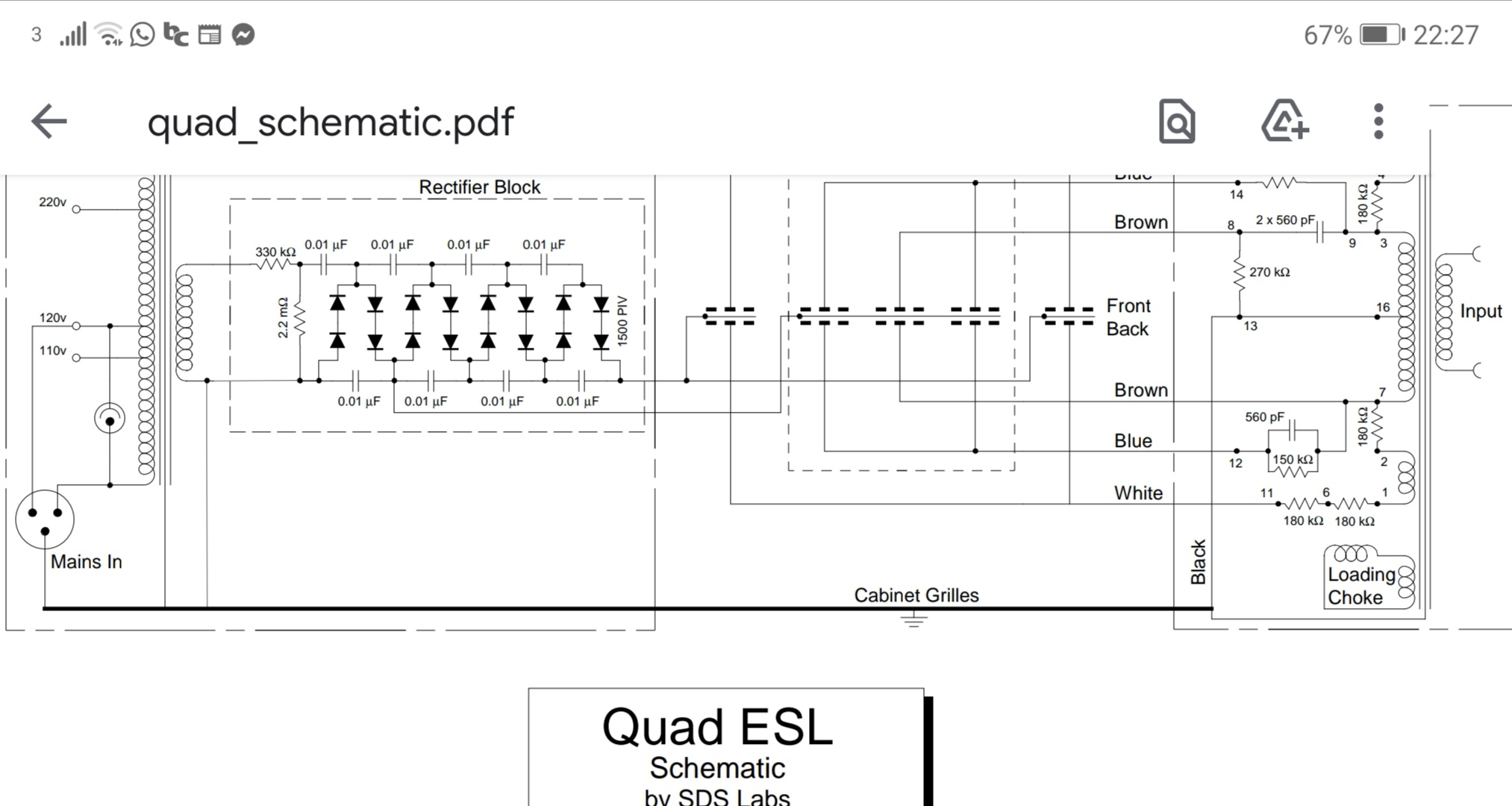

I'm rebuilding the EHT power supplies in my ESL57s. Do the 330k and 2.2M resistors need to be high voltage parts or will standard resistors do? How about the resistors in the audio transformer box?

That depends very much on where the resistors are in the circuit. If they are on the primary side of the transformer, most probably not.
Is there a schematic where we can see the resistors?

It was a long time since I rebuilt mine, but if I remember correctly, the secondary side has about 600V across the resistors, but since it is a voltage divider the 330k sees about 1/8 of the voltage. Better be on the safe side and select 1500V resistors.
I did not rebuild the crossover so no idea for each resistor except that the transformer is something like 110:1 and max 17V input which should end up with max 2kV across the network.

Here's a schematic for the power supply and crossover sections. It looks like the two resistors in the power supply are all on the 'low' voltage side (which I think is still 610v), and if I understand it the resistors in the crossover are at a much higher voltage.

The input resistors on the EHT see the output voltage of the transformer which is either 610v or 590v RMS nominal depending on which tap is being used. Voltages are typically a little higher here in the USA. I can't speak to the performance on the other input voltage taps.
I use these for the EHT:
VR37 330K Resistor
VR37 2.2 meg Resistor
These are good to 3500V. So no worries.

For the Input transformer, I step up a series to the VR68. These are good to 10KV
VR68 150K Resistor
VR68 180K Resistor
VR68 270K Resistor

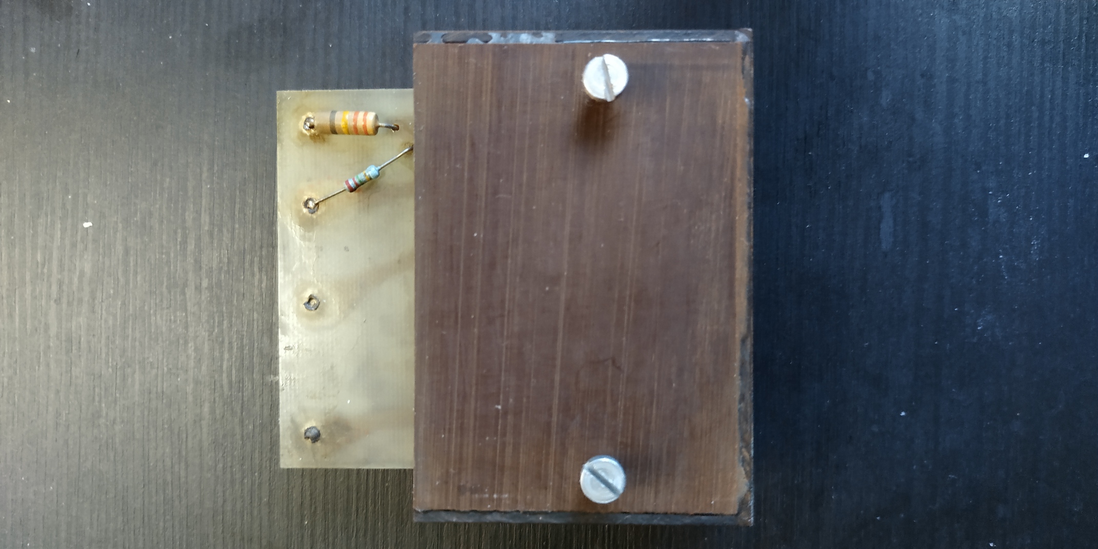

For your amusement, this is one of my EHT units, 40+ years of age and still going, complete with the original resistors; the little one sees about 900Vpeak and I seriously doubt it's a HV resistor. Of course, you should use those mentioned above.
- Planars & Exotics
- Quad ESL57 EHT resistors
