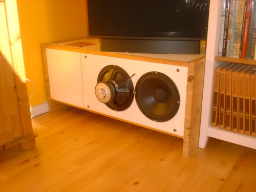

This is my solution.
Two Peerless 831727 10" woofers. Under the grill at the left there is the amplifier. Linear fase active filter crossing at about 95 Hz with 12 dB/oct.. One for each side. They couple perfectly together. All in all there is good powerfull bass and all the tones are played.

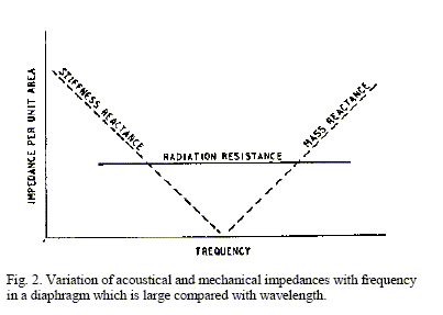

You raise an interesting question that I have pondered in the past. To what degree does the Quad speaker act as one panel mechanically rather than as independent rings? In other words, to what degree does the motion caused by the forces from one driven delay ring propagate to other regions outside or inside this ring? If there is ripple propagation, what is the propagation velocity compared to the sequential delay line timing? Of course, the Quad design complicates this question because it actually uses four panels cutting across these rings, breaking up modes.
What follows are my thoughts based on intuition rather than a solid mathematical proof, so I reserve the right to be wrong. I hope others will add to this discussion.
I think what you're asking about is longitudinal versus transverse modes of vibration, and the coupling between those two modes. As a related case in point, the old Suma Aria (now sold by the Museatex/Meitner/Melior folks) was a single large membrane excited in the middle by a voice coil. (Moray James, didn’t you say that you co-designed that speaker?) The center excitation propagated outward longitudinally as well as transversely, as would ripples in a pond. Edge terminations provided mechanical impedance that approximated the impedance of the membrane, absorbing most of the energy to keep edge reflections from returning toward the middle again. This ripples-in-the-pond approach is analogous to what the Quad does, although by a very different technique. An ESL uses quite different membrane material, much lower in mass, as I understand it, compared to the Aria. Furthermore, any ESL, even the Quad with its various rings, exerts electrostatic influence on all parts of the diaphragm, even where there is no driving audio voltage. If you tried to move the diaphragm, it would have to work against the forces provided by the stators and the output Z of the driving transformer or delay line (think of it as a reciprocal microphone in that case. Yes, the Quad, or any ESL, can be used as a large microphone.).
At most audio frequencies, the stiffness (spring constant) of the ESL diaphragm is entirely negligible compared to the air’s radiation resistance (see the figure from a Walker paper below). Only at very high frequencies does the diaphragm’s mass reactance start to intrude, rolling off highs (we strive to make it start above the audio band). In other words, over the audio band, the air’s radiation resistance has more control over motion than will the diaphragm’s own material properties, a very important point to this discussion. This situation would not have been the case with the Sum Aria, I think.
By similar thinking, we have the fact that over most of the audio range, a large uniformly-driven ESL diaphragm will move as a flat plane, not as a curved drum-head-like surface. Almost all bending will take place at the outer edges only. At low frequencies, there will be transition to a curved surface displacement, as the relevant impedances trade in relative magnitude, and stiffness becomes a factor. The tighter the diaphragm is stretched, the greater its stiffness, and the higher the frequency becomes where this transition takes place.
So, I believe that the longitudinal ripples would be suppressed in an ESL to a great degree, although not entirely, of course. In other words, the membrane’s motion is under the tight control of the nearby local electrostatic field and of the air. A longitudinal ripple component, coming in sideways from an adjacent ring would be attenuated by the other “stronger” controlling forces. I expect that there is still some mutual mechanical leakage between rings, and that Peter Walker, being no dummy, must have accounted for that nit in the tweaking of his finished design. At worst, this would have had a smoothing or blending effect at the edges of the various rings forming a more continuously varying spherical approximation, perhaps even for the better. But I would not expect any major deviation from expected “theoretical” performance due to longitudinal ripple propagation.
