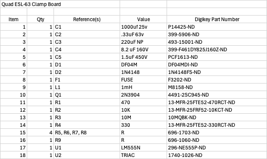

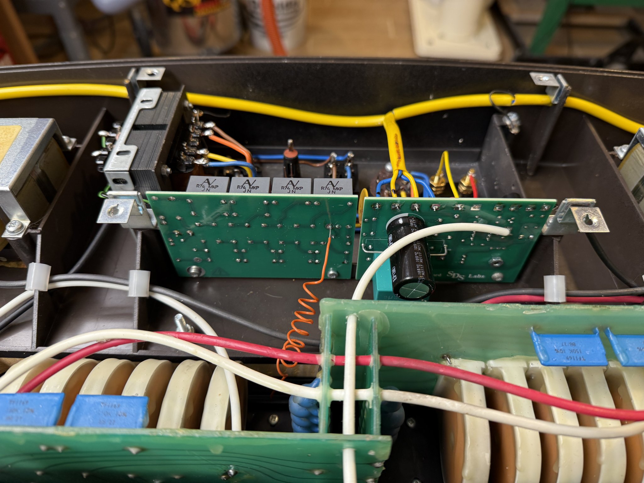

- Input/Clamp Board: Has the input ballast resistors as well as an antenna and RF clamp circuit. In my board I have provisions on the back to mount the input cap and resistor for the audio signal as well as a healthy sized film bypass cap.

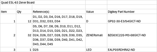

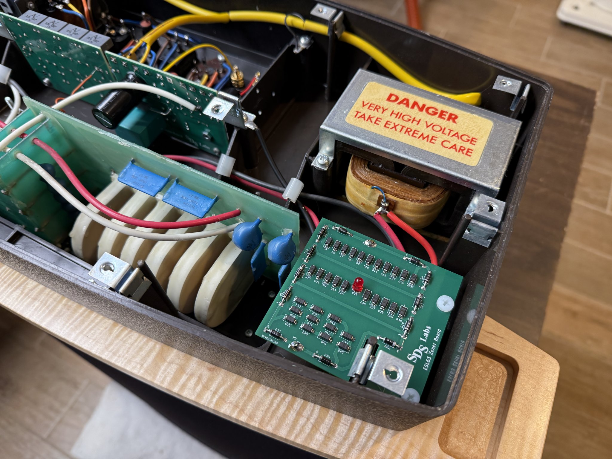

- Zener Clamp Board: This clamps a signal large enough to damage the panels. It's a weird triple stacked diode bridge arrangement with zeners across the bridge. It's weird, and I cloned the weirdness. Works well though.

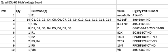

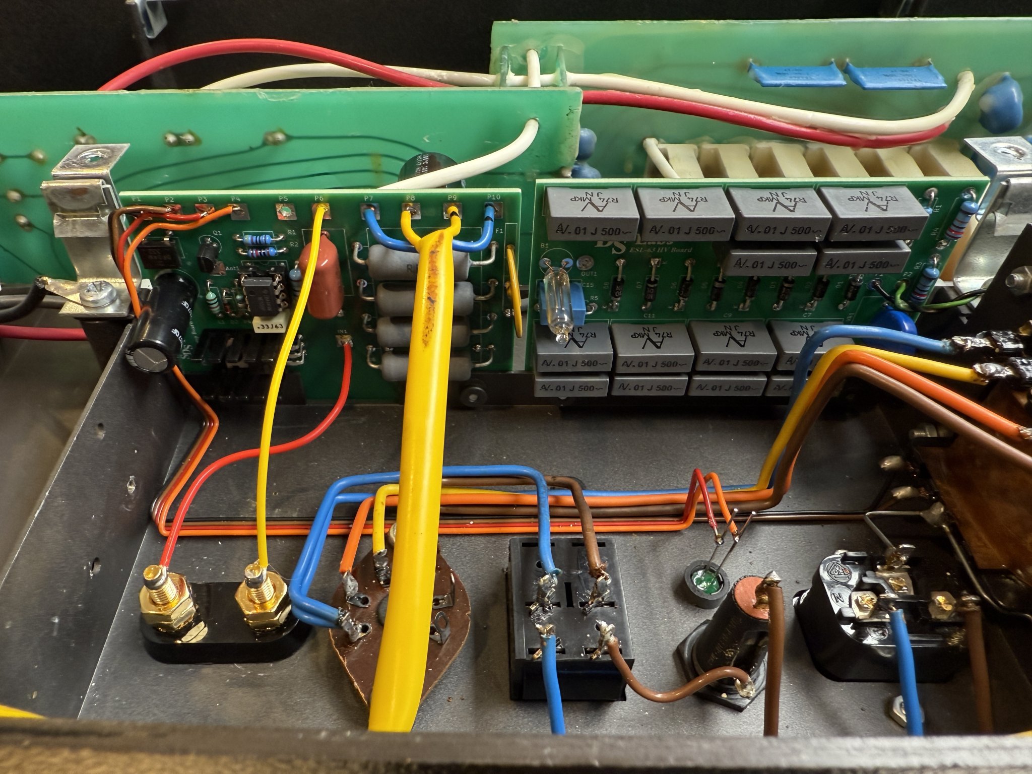

- High Voltage Board: This is a Cockroft/Walton voltage multiplier. It includes the MOV based regulator at the input and the neon isolator at the output. Mine is a clone of the current circuit but I used film caps instead of ceramics.

Here's the BOMs

On the Input/clamp board:
- I socketed the 555 timer using one of these: 123-AR08-HZL-TT-ND. That allows the RF clamp to be defeated just by pulling the 555.
- I also added a heat sink to the Triac: HS107-ND
- The triac and the heat sink are held to the PCB with a 4-40 nut and screw
On the Zener Clamp Board:
- I used nylon standoffs to hold the board. This is exactly what quad did but I'm using an insulating standoff: 36-25535-ND
- And I also used a nylon fastener to hold the PCB to the standoff: 145-50M040070G012-ND
- I used 10KV test lead wire for the zener board hookup: 501-1282-ND
