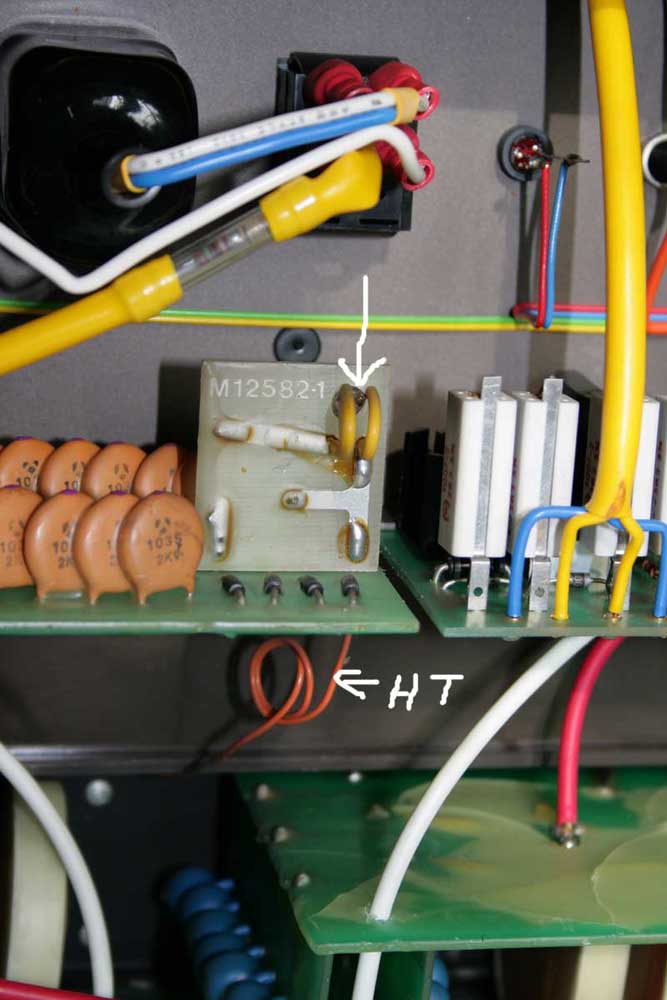

One of my ESL 63s has just developed a problem as follows:
When I switch it on, after a few seconds it crackles like an old fashioned radio warming up, then develops a regular (approx twice-per-second) clicking noise.
I've had two of the panels repaired several years ago and recall clearly the noise they made when they were going. It was much softer than this, a kind of background fizzing. I can't see any arcing when I remove the cloth.
Coincidentally or not, the channel on that side of my Quad 34 preamp has blown at the same time.
Also, perhaps coincidentally, we had one of the worst electrical storms in living memory last week, and this was the first time I had switched on the equipment since then.
I'd appreciate any tips on how to isolate the problem and if (hopefully) it's not one of the panels, how to go about fixing it. If it's a panel problem I know the route to go, but I've never taken on anything in the base of these speakers. Oh, and I have only rudimentary equipment - your basic multitester and a soldering gun, so if we can stay away from oscilloscopes and the like, that would be great.
Many thanks.

The speaker problem isn't generated by the amp. Loud clicking noises happen whether or not the speaker wires are connected. Just firing up the speaker causes the initial crackling then regular clicking. I stripped down the speaker to bare panels to watch what happens and you can see the mylar of the top two panels vibrating to produce the noise. Simultaneously there's a burbling coming from the speaker base. I'd go straight to dismantling the panels, since this is a route I've been before and I recognize that most of the issues with these speakers stem from mylar deterioration. But the noise is nothing like what I've heard previously from panel breakdown.
When I put the preamp in for servicing I asked whether coincidental speaker and preamp problems could indicate a single cause, but I got nothing useful there.
Opened up the base, supplied power and observed. Regular ticking sound manifesting itself where the HT wire joins the second top panel. Now here's where my astounding ignorance comes in. There's a square board at right angles to the printed circuit board where the HT wire connects inside the base. I've arrowed it in the accompanying photo. Between the two yellow wires forming a loop in the photo is the glass bottom of what looks almost like a tiny valve, and it flashes in synch with the clicking noise in the speaker. Which is cause and which is effect, I've no idea but I'm sure it's all as plain as day to someone looking at this thread. Your indulgence and help would be endlessly appreciated. I have pics from other angles if this one doesn't do it.

That's a neon bulb and it's function is to serve as a HT leakage indicator. You already know you have a leak (the ticking) but for a normal operating speaker it can be used as a health indicator. Normally it should blink perhaps once every ten seconds or so (depending on air humidity). Once a minute would be even nicer.
Thanks, arend-jan, I think you've answered my question. So if that's an indication of a leak rather than the leak itself, does that point to a leakage in the panel, e.g. a tear in the diaphragm, or is it still possible that I have a leak somewhere among the base components?

I have repaired 2 els 63s. The problem was that the glue holding the circuit board had failed and the boards had curled inwards against the film.
To check you can cut the ht on both sides and make new connection for ht for the other panels. If the clicks dissapairs you probable have a bad panel.

So, I've discovered it's the second-top panel that's gone, and I'm about to set about fixing it. First task is to get the materials and mylar film seems to be the biggest challenge. So far I've found MT Audio in Europe who has all the bits and probably reasonable prices though still not cheap. I've also been in touch with Grafix Plastics in the States who sell a 25' roll of Dupont Dura Lar, .001" thickness (25 microns if my math is correct?) and 27" width, for $10 or so. So the only question I would have is: are Hostaphan mylar and Dupont Dura Lar just about the same thing?
go for the Hostaphan in three micron if you can get it and six if you cant. The stock 63 is a three micron diaphram. If you use DuPont use "C" grade Mylar. There are available sources of suitable film on line such as http://www.eraudio.com.au/ but I think that he has only six micron. Twenty five micron film is way too thick don't do that. If you are really just interested in rebuilding so you can enjoy your speakers there are two of the top rebuilders in North America who will rebuild your panels to better than stock for around $300.00 a panel. Give the actual amout of work involved this may sound like a lot of money but it is in fact very reasonable. If you have not done this kind of work before and do not have a weighted stretching jig to work with there is littel chance that you will be able rebuild on your own to equal a stock panel. If on the other hand it is the project itself that interests you then enjoy yourself and have fun learning to do this most valuable job.

Tosh, it's one of the four panels that's gone and although I've yet to take it all to pieces, it looks like a classic mylar tear or glue failure. When I fire up the speaker in the dark, there are clearly visible blue sparks roughly in the centre of the panel, accompanied by a crackling noise. We had all-time record temperatures here this summer, which may have been the last straw. Both speakers are about 30 years old and one has never been serviced.
