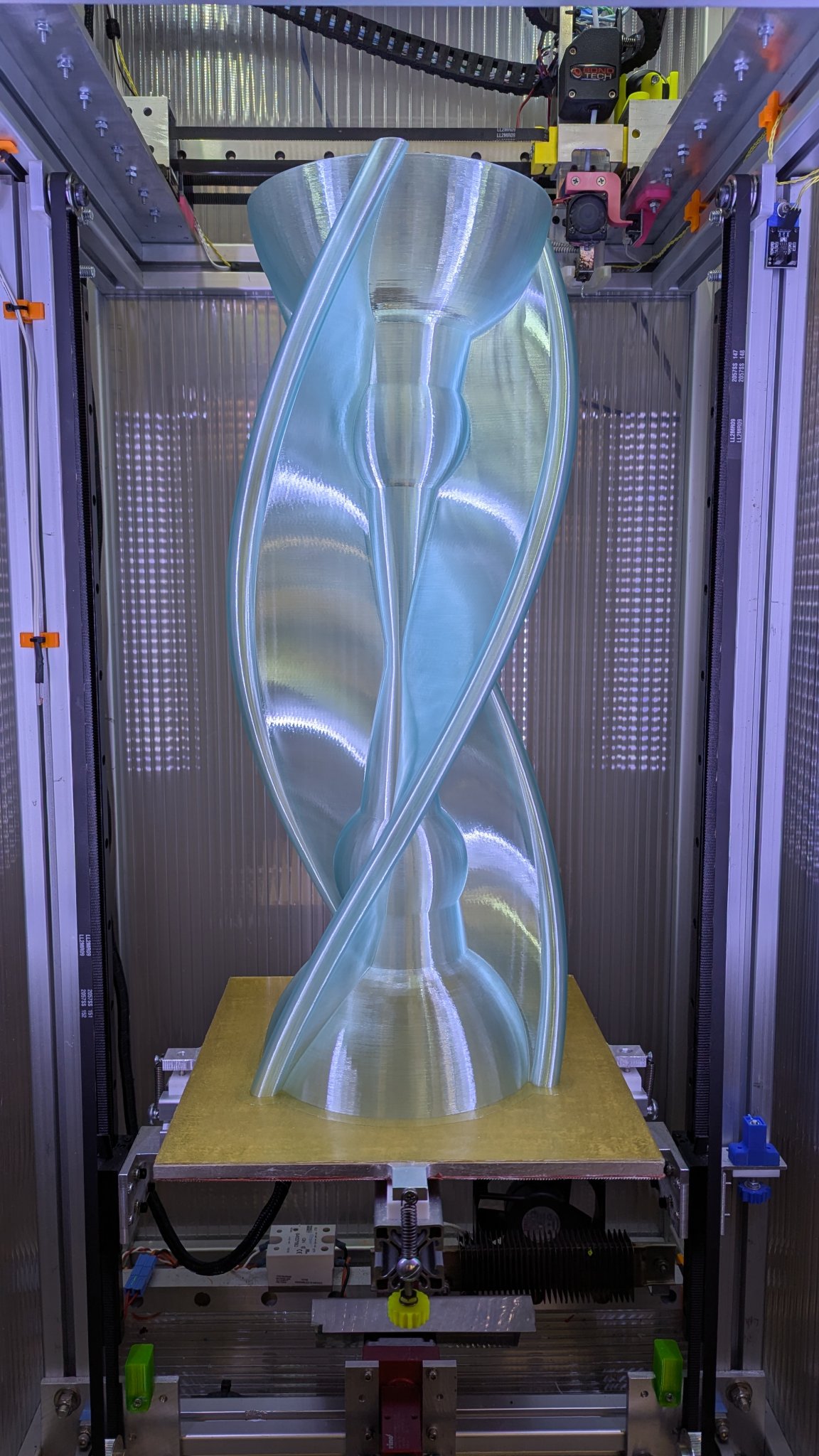

This is an electrostatic speaker that I am building:
It doesn't use stators, radiation is omnidirectional at all frequencies between 20Hz and 50 kHz, and it sounds great!
Now lets have a discussion about it, but don't ask me for any details.
