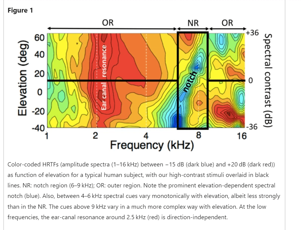

I understand the working principle of the quads. Are ears/brain are able to pick up a sense of height from frequencies starting at +/- 300Hz and we get more sensitive to height location of an audio source when you move up in frequency. That nicely lines up with your statement on the cutoff points. That means that most of the height information is coming from the 2 full range panels in the middle of the stack. Hence my curiosity to shift them on top...ALL panels and all segments is reproducing low frequencies. So the whole speaker radiates like one single membrane and it starts from 30 Hz and up to 300Hz where the filtering starts to kick in but the bass panels plays up to 1kHz. You can easy sheck this with a microphone.
I have place a dipole sub below the QUADs.. but i agree with you 100% that if i would have them on the floor i would shift up the center panels to get the sphere in the height of my ears.
Hi, if nothing else works one could try HRTF equalization. Apparently humans are very bad at detecting height, other than from some variation in frequency response. See this https://www.nature.com/articles/s41598-018-37537-z
Perhaps your system has unfortunate frequency response, which makes your brain perceive it from below? If it is this, you might be able to tune this just with adjusting toe-in. Or, perhaps try with some simple EQ.

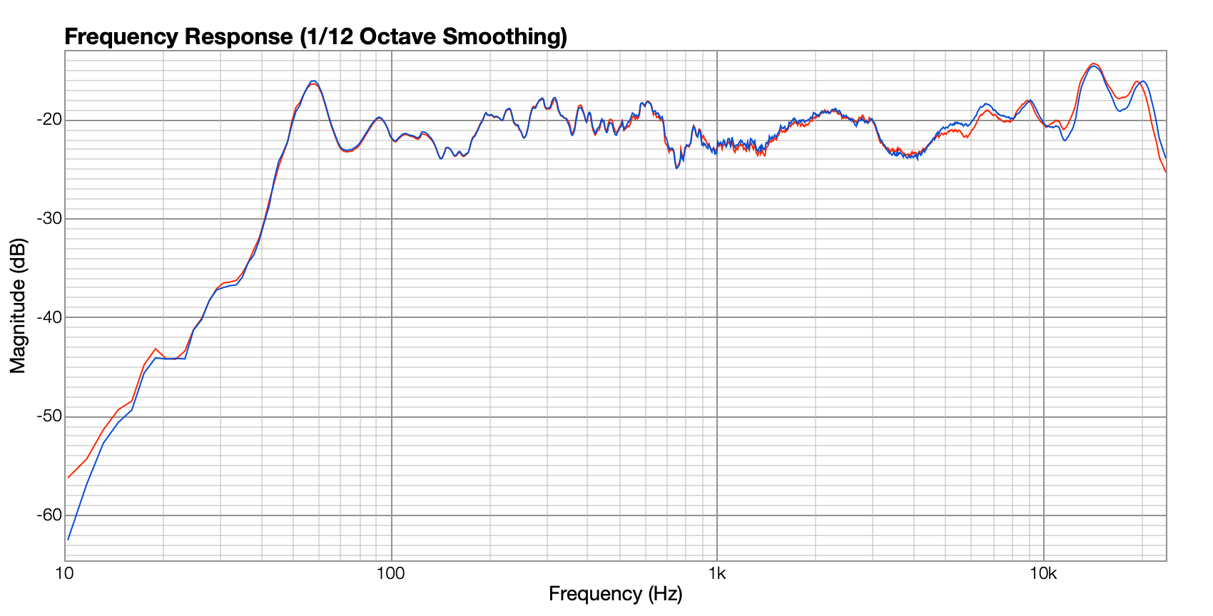

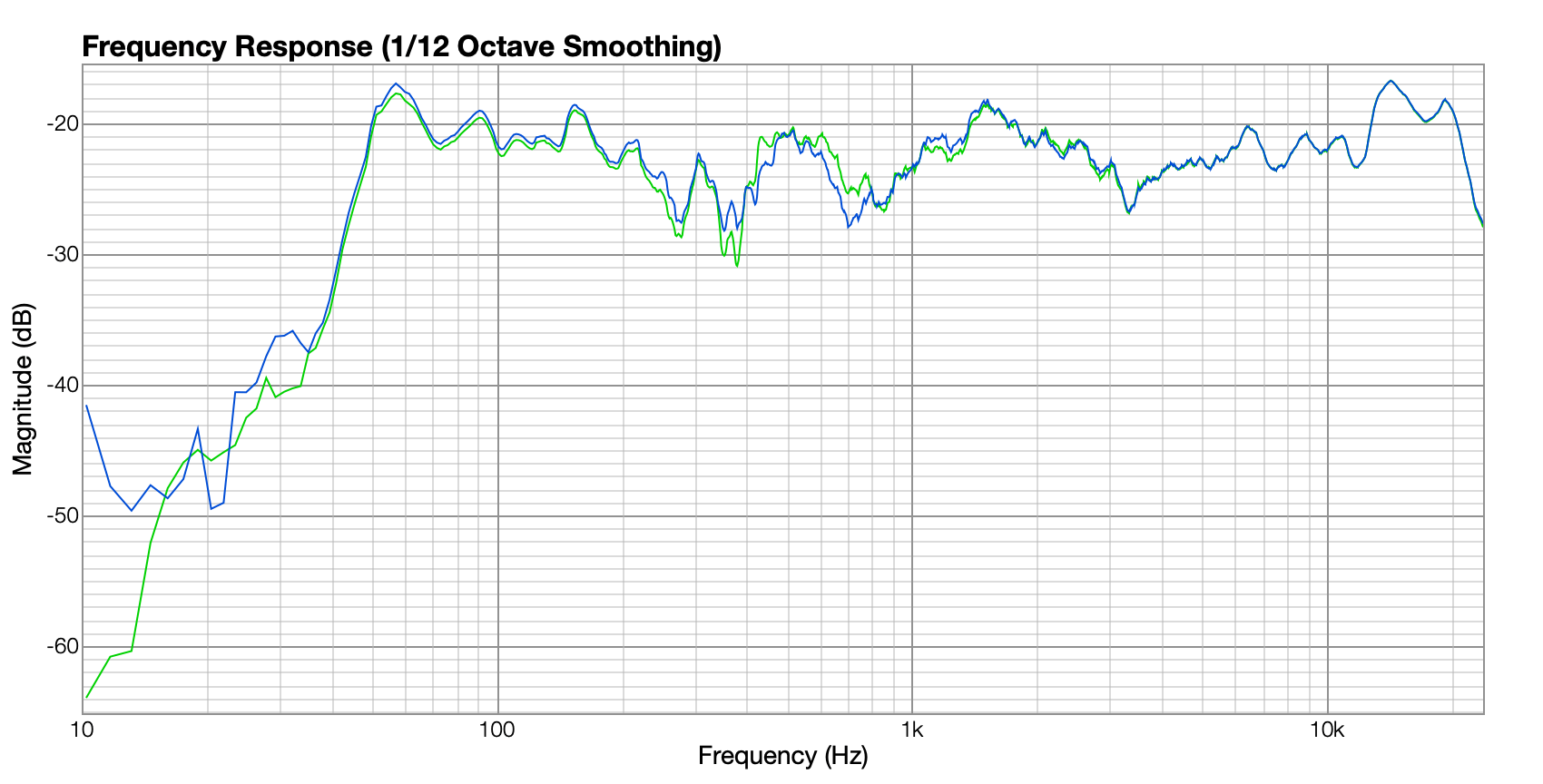

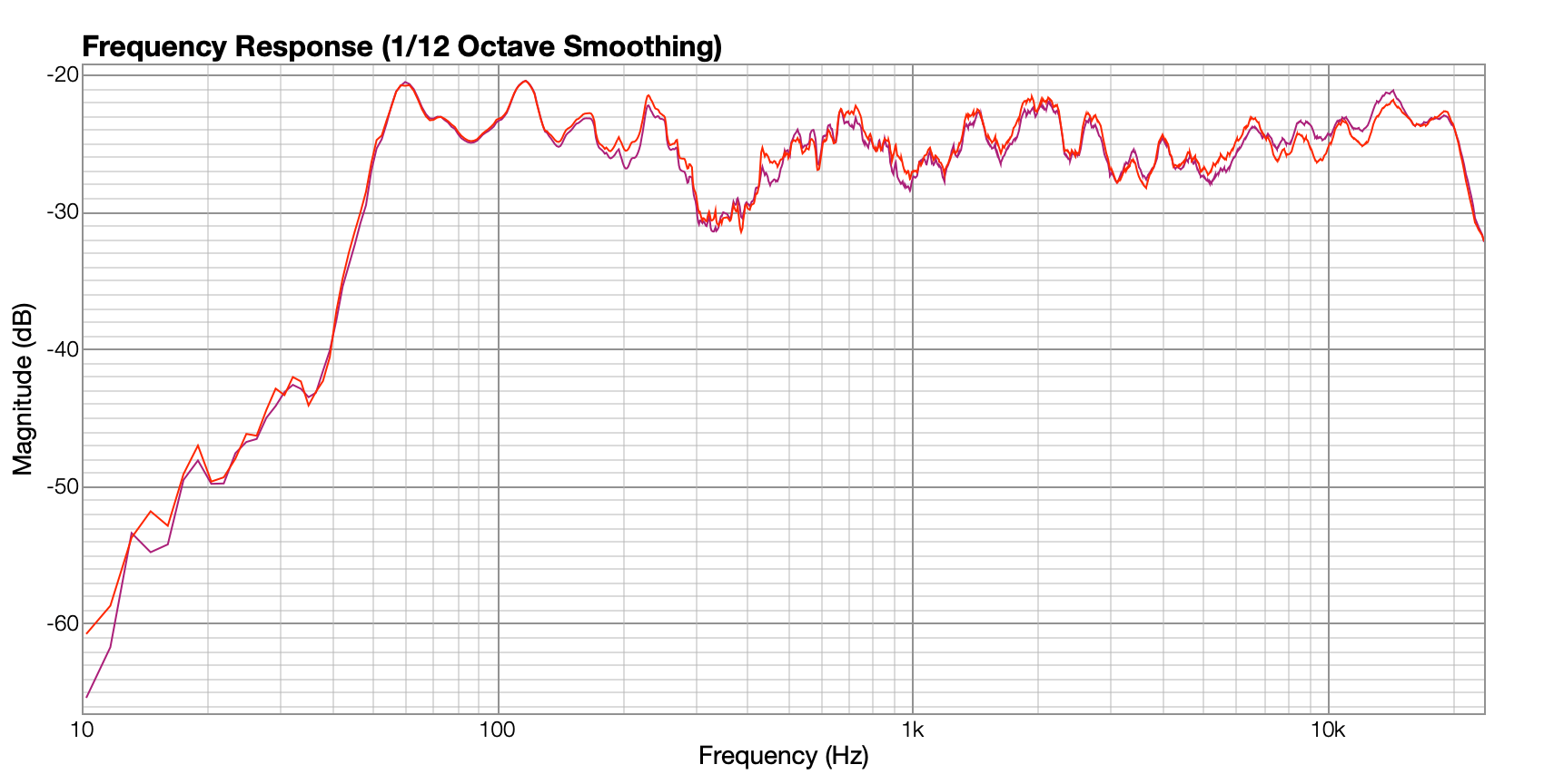

Back in April of 2018 I did exactly what you are proposing. I put the two mid panels in the top two positions and the bass panels in the bottom two positions. I did a bunch of testing to see if the higher mid panels caused any pressure feedback around the top of the speaker at midrange wavelengths. I put a panel sized board on top of the speaker with the high mid panels to block the pressure feedback and took measurements before and after. I don't have nearly good enough notes on everything I did to convince myself this was a viable panel ordering but It did sound fine to my ears and did exactly what you are trying to do.
If I were to try this again I'd take some more detailed measurements and really show the changes in response, as it stands I've only got about 60% of the story.
With this pair was was also playing with 3M VHB adhesive transfer tape in place of my usual diaphragm adhesive. The VHB tape doesn't stick well enough to the stators to be viable in my testing.
Here are some ungated measurements of speaker response. I use these to assess my panel rebuild performance and also to verify proper electronics function. There is room response buried in these plots so don't read too much into them. They are only a tool for QA'ing my work, not a definitive response measurement
Here's the speakers with the normal panel order:
I then took a response shot of the re-arranged panels (sadly I'm not sure if I raised my mic or lowered the speakers. From the looks of it, I raised the microphone as evidenced by the dip at about 350 hz, which would indicate that I'm now closer to the midline of the room from floor to ceiling.
Here's what it looks like with and without my blocker board:
I was expecting much larger changes than what I saw. It makes sense, at low frequencies where pressure feedback is happening, the entire surface of the mid panels is active.
I'd suggest that if you are willing to go through the effort it's worth trying.

About your measurements;
As long as you keep the mic at position (😁) and you tilt the speakers in a way that the mic remains on-axis with the center of the high freq section, for both the original and the alternative panel sequence, I don't expect big changes in the spectral balance (aside from a shifted cancelling effect from the floor).
What was/is your experience with the elevation of the stereo image?
Many thanks for sharing your experience and detailed measurements!
Michel
WRT the measurements. I took woefully inadequate notes, so I don't have a good feel for if I changed the mic position. It appears that I used two different height stands and kept the mic constant. But I also suspect that my position accuracy from one speaker to the other could have been better. I can tell distance from the impulse delay, but not height.
The image got higher, just as you would expect. The stand and deliver stands elevate the speakers a bit and my goal here was to get the acoustic advantage of the stands without the ugliness of a pair of hovering speakers. Arcici stands elevate the speaker even higher, so a simple panel swap doesn't quite get you there. But the Arcici stands are also ***-ugly and damage your speaker frames and grille cloth.
Sheldon
