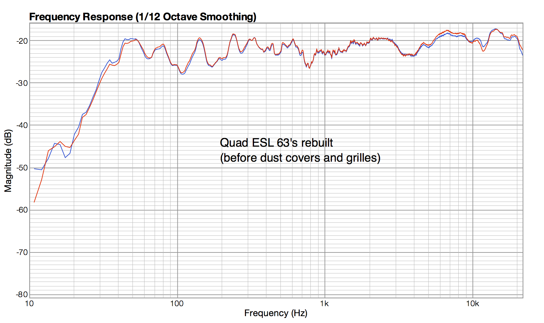

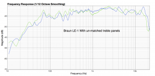

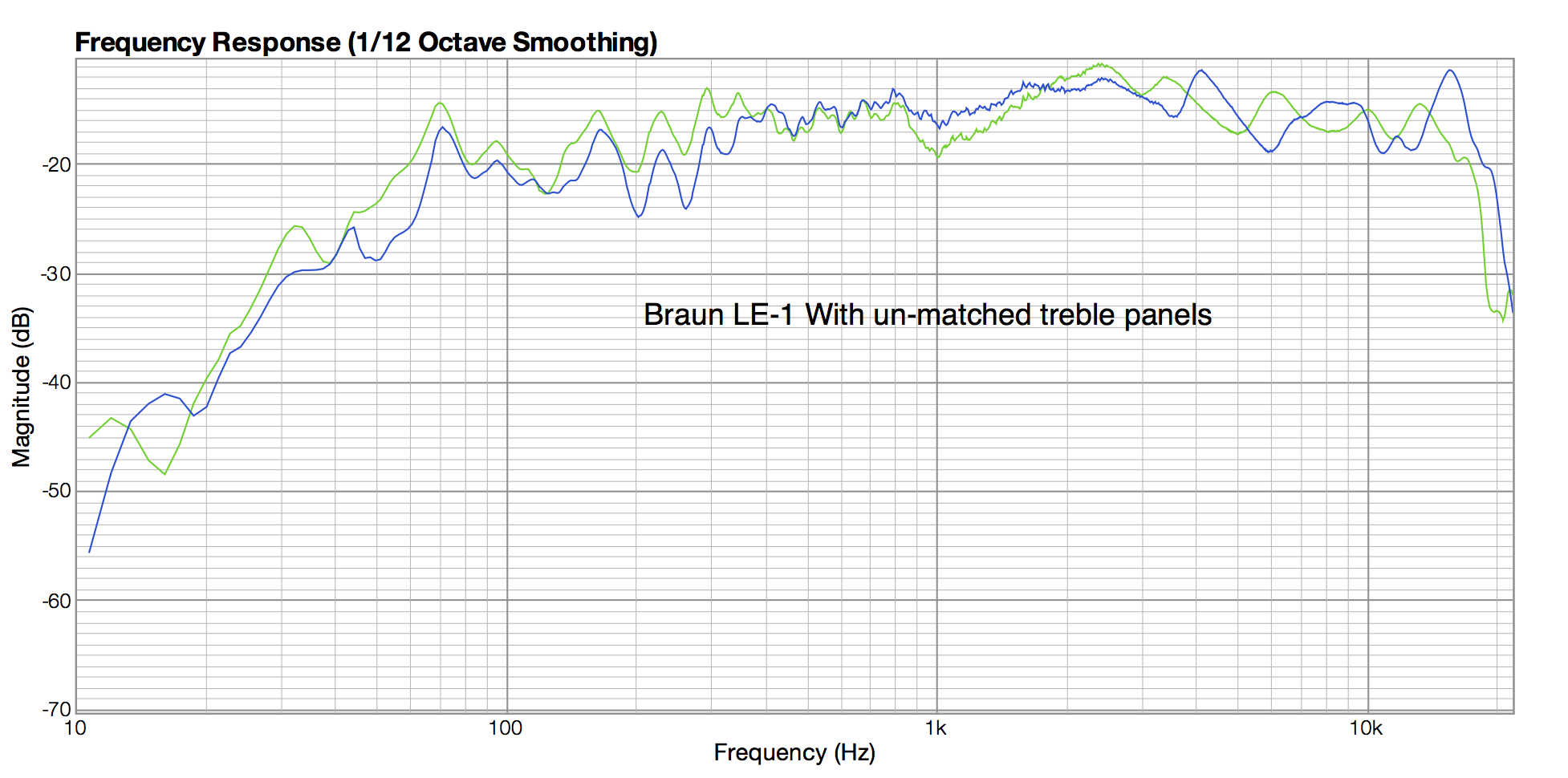

Here's some plots of rebuilt ESL63's and a pair of Braun LE-1's. The Braun measurements are typical of randomly selected treble panels rebuilt carefully, but stators that were made at different times.
Sheldon
