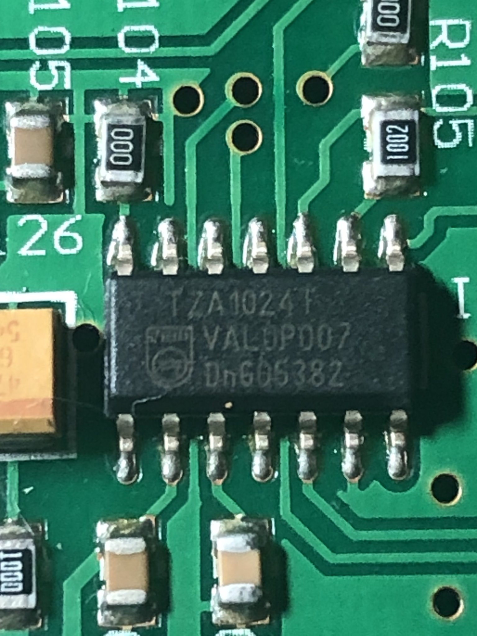

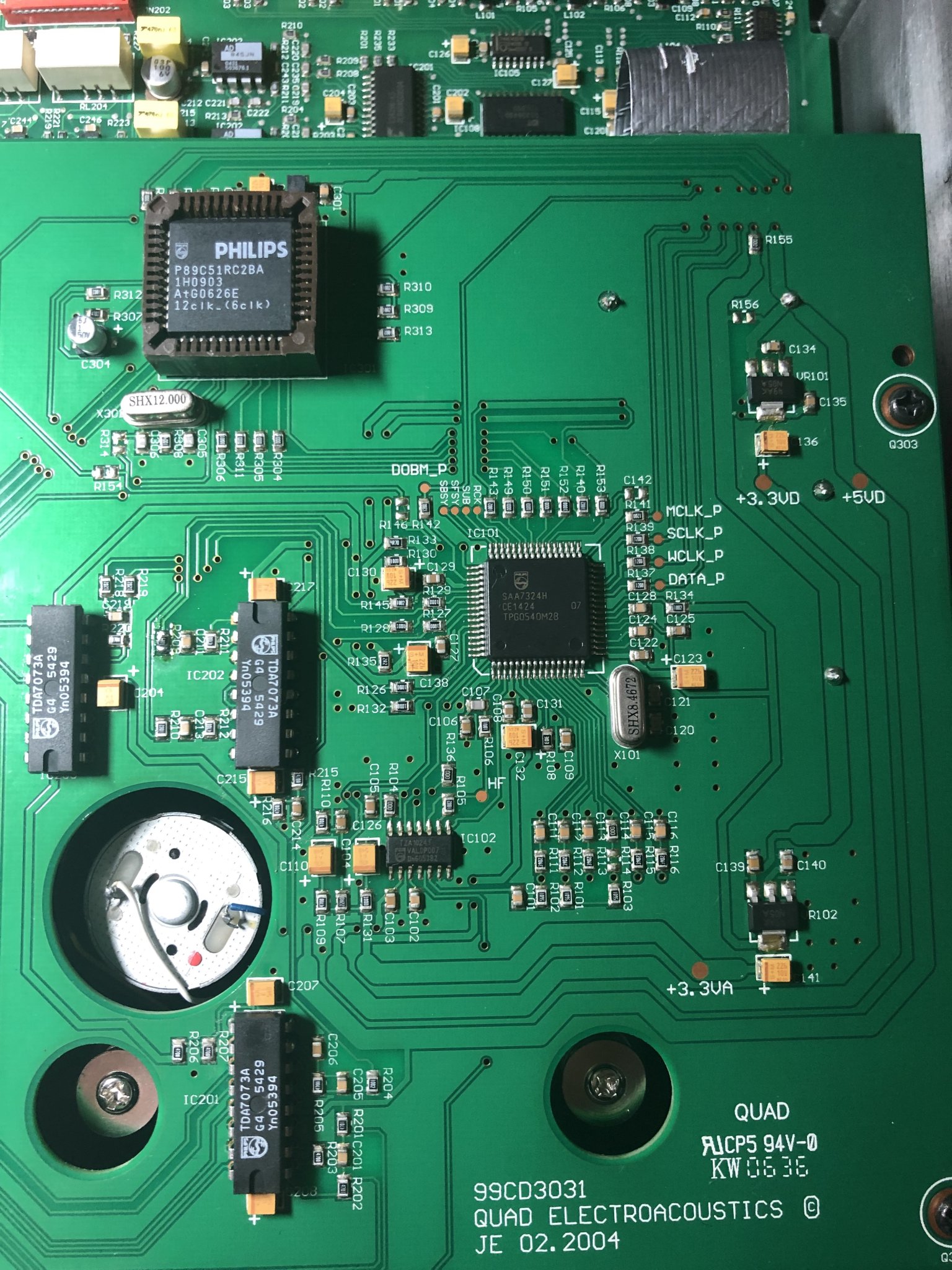

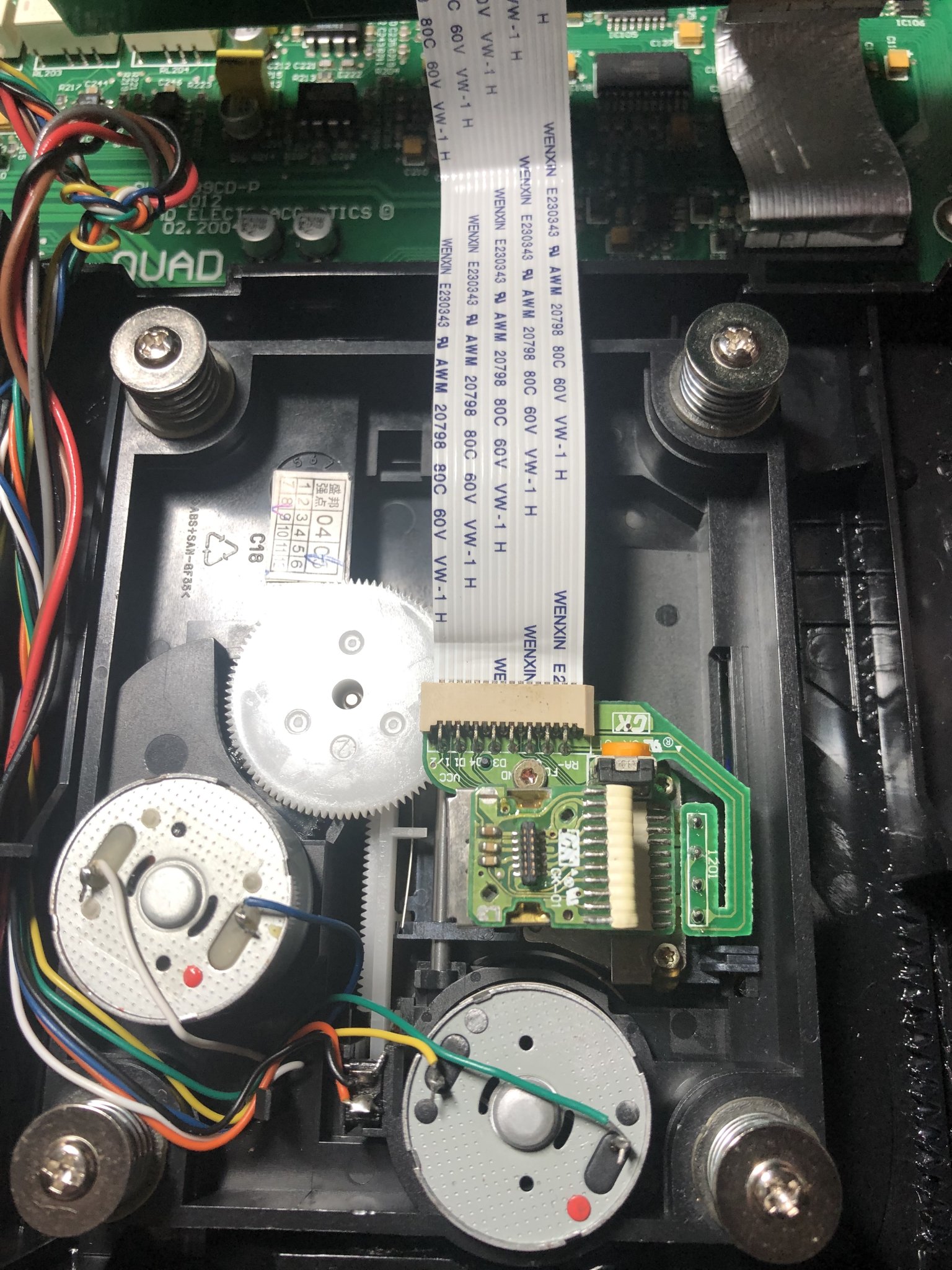

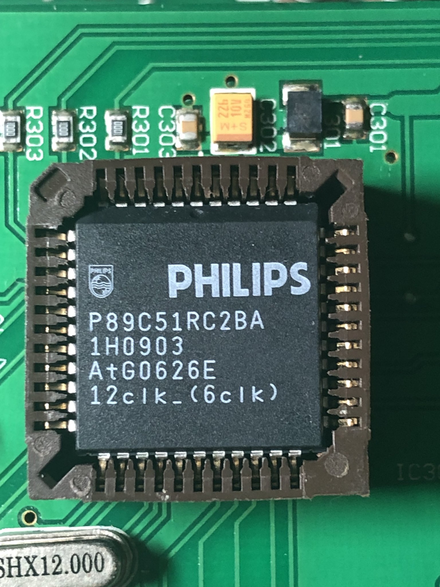

The mechanism is labelled VAM2202A/B and it looks like images for a VAM2202 on the internet. It has a Quad specific controller board attached to the drive which has local voltage regulation, the power drivers for the motors and I assume the logic circuitry for the drive - a Philips set of chips. There are two micro switches, one for the laser sled and one for the drawer - I’ve cleaned both and checked electrical function. No sight of schematics anywhere…

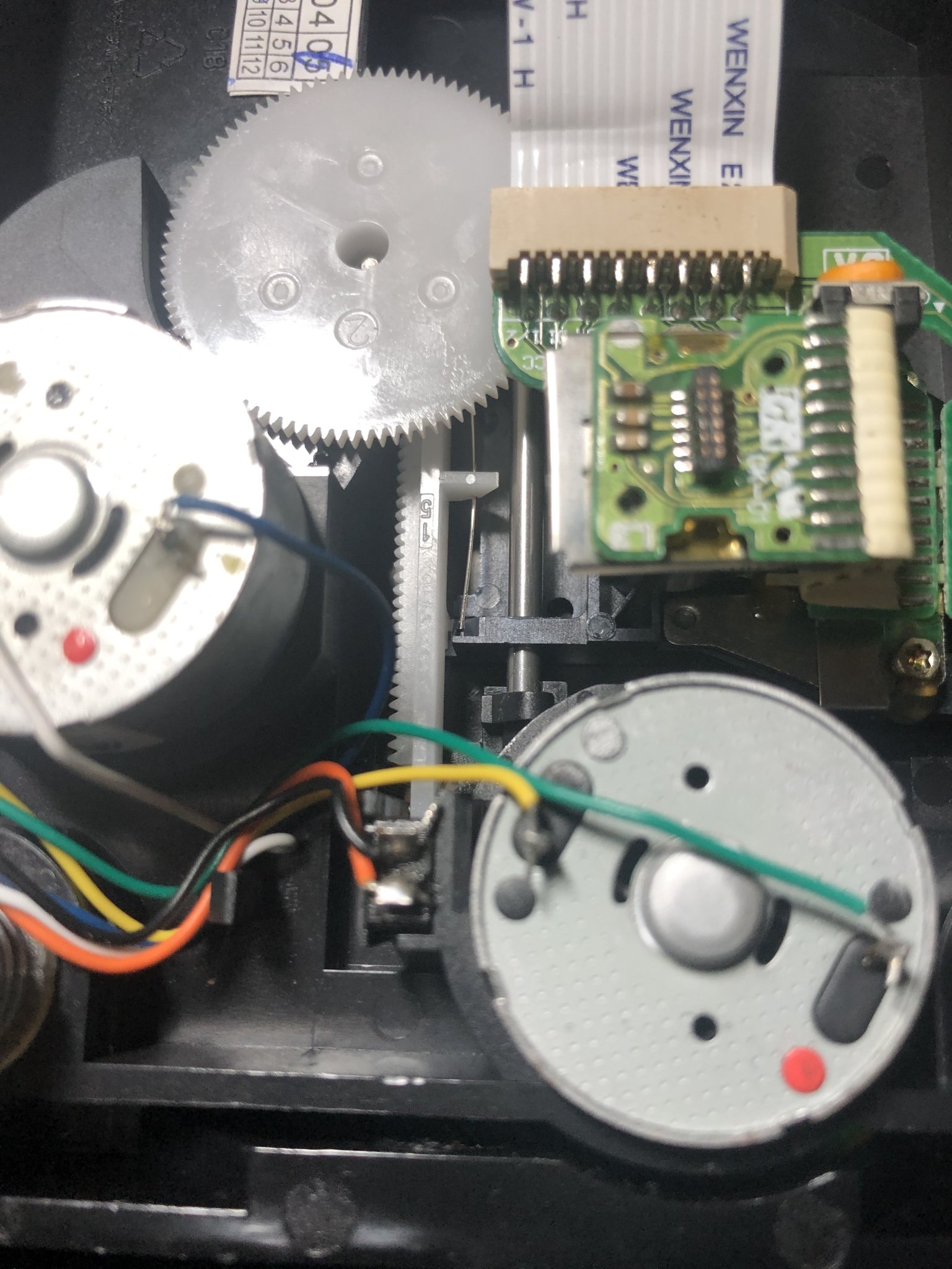

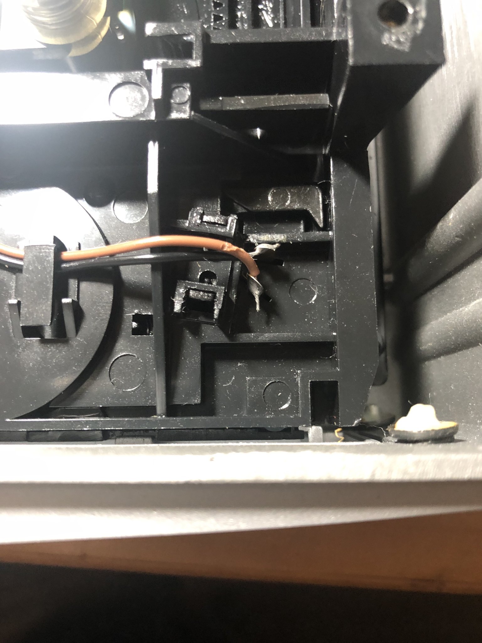

Images attached show the drive mechanism, PCB attached to top of board which contains the BTL drivers for motors and (I assume) associated logic control, and ICs except the BTL. Two microswitches are identified - drawer switch has the brown and black wires attached and sled switch has orange and (different) black wires attached.

It is a mystery. Have checked the operation of the microswitch for the tray. It definitely makes/closes when the tray is fully out. I also checked the resistance on this switch when the drawer was fully closed in case there was some sort of mechanism I couldn't see which closed the switch in this situation - it was open circuit when the drawer was closed. I have however followed your helpful thought on the service manual - the Marantz CD7300 uses the VAM2202 and has a detailed Service Manual on line. In this manual the tray microswitch is called a 'limit switch' which seems appropriate. Haven't yet found the sled(ge) microswitch but there are a lot of very small lines and writing on these diagrams 😢I really don't know on this one. I was trying to think of a way one switch could work and there might be a way but it relies on the mech knowing the initial state and it never altering or getting confused.

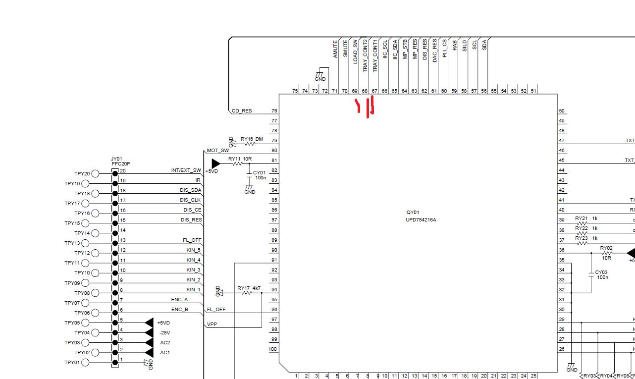

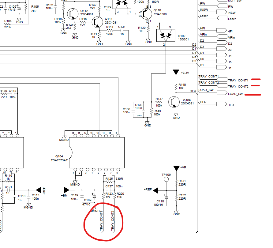

So, and just skimming it over very quickly... this looks to be the area for the tray. All those IC's seem to be some kind of H bridge driver for all the motors, pickup and so on. Puzzled why there is no R/C network shown across the motor output on pins 9 and 12. There is on all the others.
Random thought. Noisy (electrically noisy) motors can generate lots of spikes. Could that be glitching the chip in some way?
Pins 6 and 7 look to be the inputs.
More random thoughts... if its intermittent try a low value series resistor to the motor and a small non polarized cap across the motor.
Load switch... is that the sled do-dah or something else.

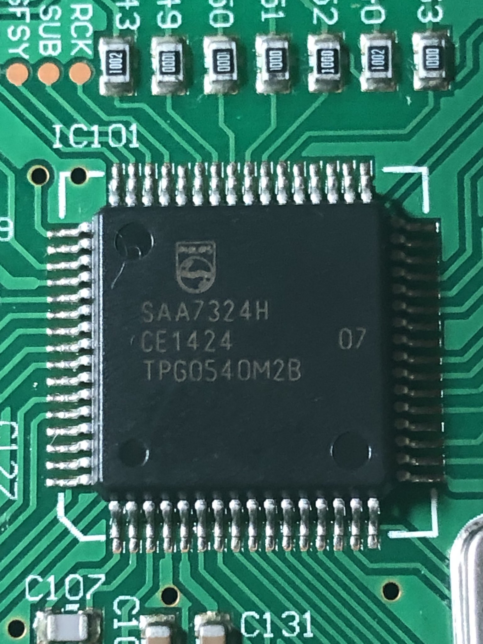

So I got it wrong. LOAD_SW connection is to the micro switch for the tray, and limit switch connection is to INSW onto the SAA7324. Haven’t traced TRAY_CONT1 and TRAY_CONT2 yet.
