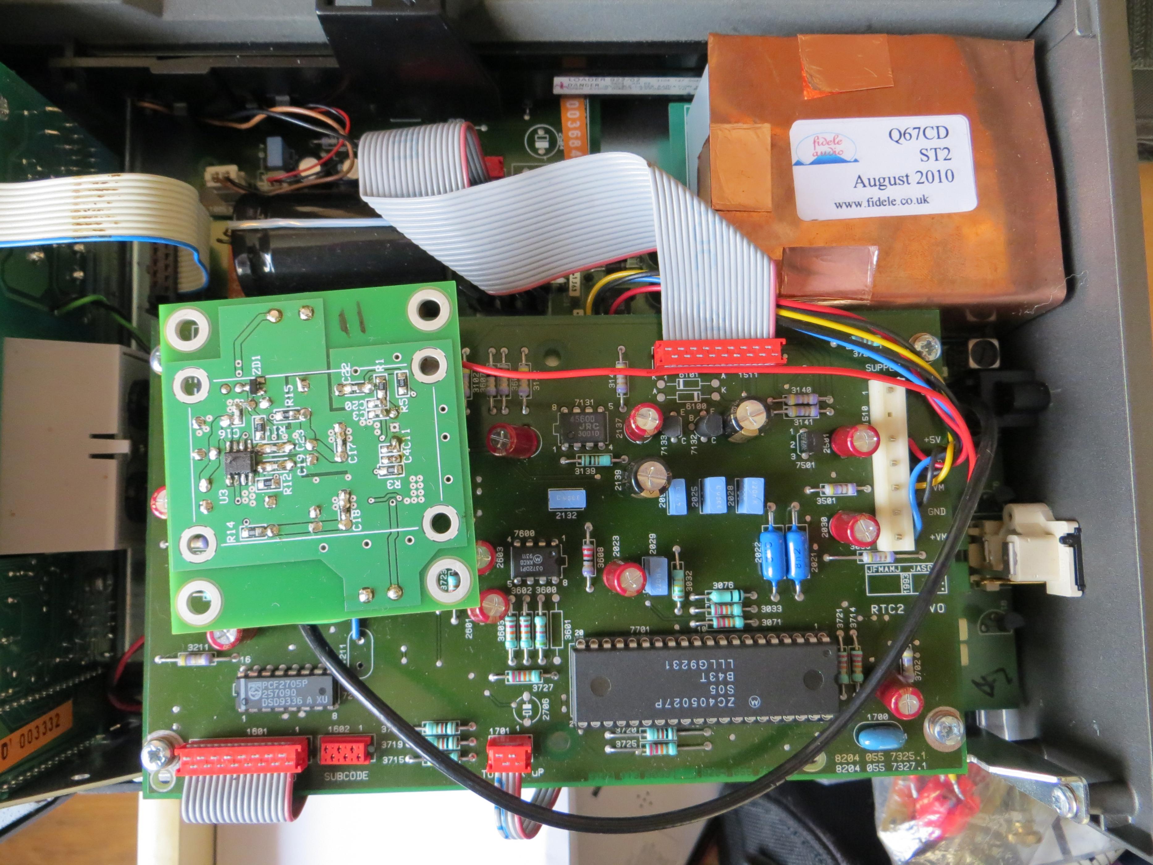

ST2 details
Hi, thanks for the picture. ST2 in 2010 (2010!!!). How time flies. This has the following:
Power Supply - upgraded electrolytic capacitors usually larger capacitance and new regulators. Some copper sheet over the mains transformer for shielding.
Audio - upgraded electrolytic capacitors , new op amps, in this case I believe they are OPA1611.
Digital - New electrolytic capacitors and Net Audio Rock Clock. (The large module on top of the digital board.)
The electrolytic capacitors are mostly ELNA Cerafine or Nichicon Muse ES for any non-polar caps.
The Quad 67 is mainly a Philips player with a Quad audio section. Nothing has been done to the transport or the display or control logic.
If there is anything specific you would like to know just ask away.
P.
hello there
i have a quad 67 cd
the cog wheel for the tray has broken again (2nd time)
i had some mods done a long time ago and am now looking to further upgrade as the player is getting old (like me!)i i was thinking that the electrolitic caps should be replaced from the photo on here i can see you did the very large one
i have some elna starget 22mfd which i thought would be good in the audio section psu (4) x 10mfdi after the regs can you help please?
