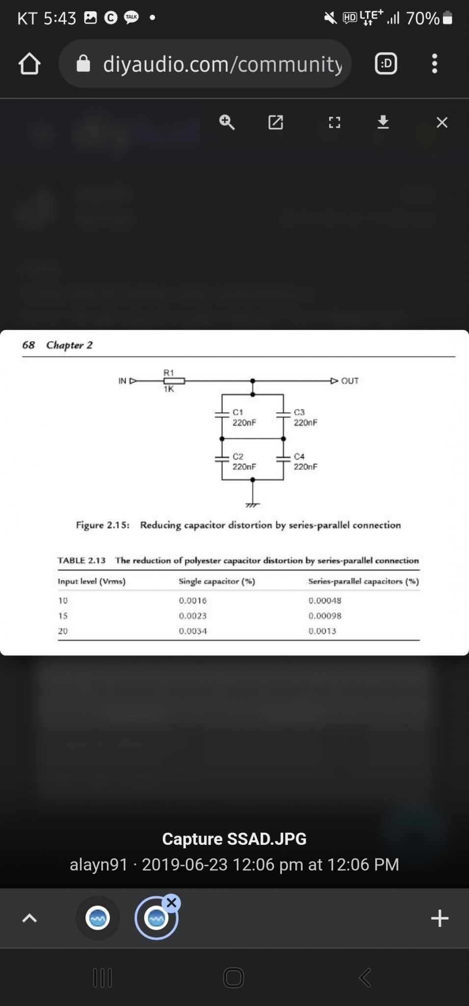

Quad caps for less distortion?
Found it 🙂
Found it 🙂
The series-parallel configuration halves the voltage on one cap, which is why it can reduce distortion. Typically non-linearities increase with voltage amplitude.
You don't need 4 caps though, just 2 caps of double the value in series will work the same way.
Whenever connecting electrolytic caps in series you have the issue of the large tolerances they have though - don't expect them to share voltage precisely (and don't expect the leakage currents to match if they have DC across them - usually a resistor string is needed in this case to keep balance).
Can it still offer the same benefit by paralleling 2 caps of half the value?
Distortion due to not entirely ohmic contacts might depend on the current. With series-parallel you halve both the voltage and the current, so distortion drops independently of whether it depends on the voltage or the current.

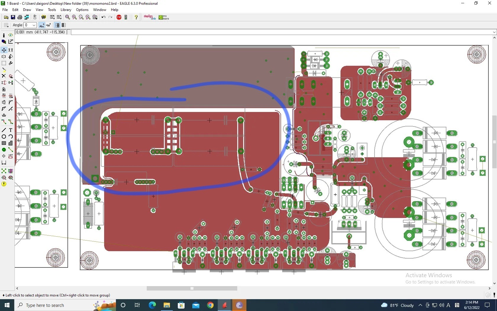

Ive started working on a layout with this string resistor 'trick' implemented. Its a 3x gain so i only need 4 equal pieces. However the visual intuition tells me that the increased loop area from this trick might negate its mechanical benefit in terms of overall performance.
In addition to the increased inductance, wouldnt the bigger loop area mean more rfi/emi vulnerability?
Ill post some pics of the pcb next time im using eagle
Yes, it would. Can you make a twisted layout (figure of 8) where one loop compensates the other?
In a class-B or class-AB amplifier, magnetic coupling from the output stage currents to the signal path can cause extra even-order distortion. For an amplifier driving 8 ohm or 4 ohm loudspeakers, unless you have an exceptionally good layout, it probably contributes more to distortion than resistor distortion (but it is even-order while resistor momentary temperature variations cause odd-order distortion).
Reactions: SonocusEric
Twisted layout such as the feedback r's overlapping the output trace? I might be able to.
Heres another idea. Quad input caps, for the composite amp im working on. The cap quality will be better but once again, rfi susceptability becomes more obvious cuz now its a 4x bigger antennae. One could wrap them and ground them in copper tape tho.
