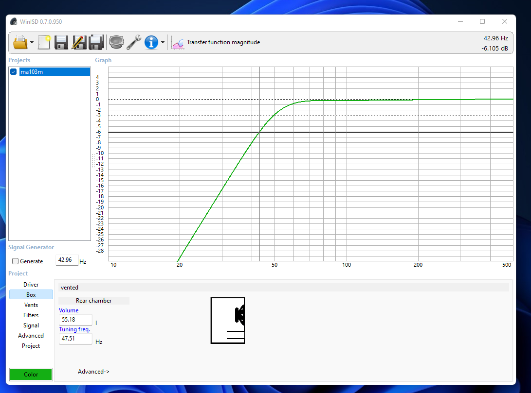

Hi everyone .Some while ago I had a pair of alpair 10M in a vented pair of 15 liters and because I've loved it so much I built another pair of speakers with 2 pcs each (30 Liters) . Even better , stronger powerful , just perfect . Almost perfect , because I thought my self " what if I make a new pair with 4 drivers for each speaker ? " Honestly I was inspired from Eikona but I believe it's risky to just copy that plan because it might not match ; so I guess , classic vented will be enough .Can someone help me with winISD ? I'm not lazy but I'm just not very good with it .I'm open to suggestions . Thank you

I just read it shortly . So you think I should't go for it ? The difference from one driver per box , to two drivers per box was really positive .I didn't expect to see a negative on with 4 drivers .

It is certainly doable.
Maybe something like this?
http://wodendesign.com/downloads/Quadrapole-P11-MLTL.pdf
This for the P11, so not suited to the A10.3.
The drivers have been arranged EPI Tower style to give an omnidirectional response and avoid combing.
2 on the front and the other 2 on the sides would work as well, if you are happy with the combing in a pair.
Otherwise some method to relieve some of the driver sof their top end would be nescessary.
Would give more bottom (not lower) and be 5 dB more efficient (sensitivity depends on how they are wired.
This shows the alternates to straigy parallel, series, or series/parallel.
http://www.planet10-hifi.com/downloads/Quad-Driver-Wiring.pdf

You may find it works for you, but you will likely need to play with a filter.
Toole has shown that combing looks worse than it sounds, but it is quite individual.
The further you are from the speakers the less the issue is.
I would go with something that has max 2 drivers firing forward running FR, and some find only 1 is best.
Do you have an amplifier happy with either really low impedance (2Ω) or high (32Ω)?
dave

I found 2 x 4" (5" frames) very difficult to stay in vertical sweet spot.
Slump a little and you lose s's and t's.

This discussion is relevant here: 4 x 5” FR� flat array ?
The W14s are spaced in the subject about the same as you could get A10.3, so except for the differences up top, much applies.
