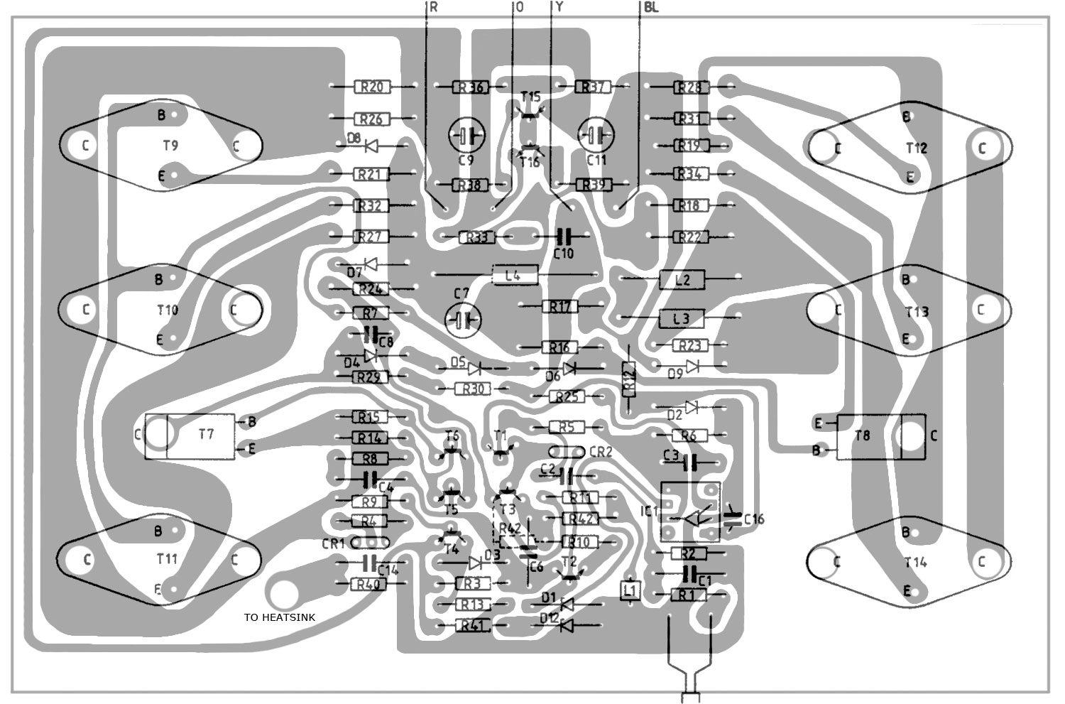

I found 2 errors in the pcb drawing which i've now fixed. (CR1 legs joined together and T2 legs joined together)
I've been looking at copper clad boards for making the pcbs. I've found a 203x114mm glass epoxy board with 35μm copper thickness. (1oz/ft) Will the copper be thick enough?

that depends on the length and width of the PCB trace and how much current you have...Will the copper be thick enough?
There are on-line calculators for determining the recommended PCB trace length/width for any current. It is worthwhile using these for the few high current traces on the board.
But in general 35um copper should be adequate for this design - unless you do soemthing really dumb like feeding the power rails through 0.2mm traces...
Traces are identical give or take 0.5mm or so to the original quad design. I have no idea how thick the copper on the original quad pcb is. Would help if i knew current levels for specific tracks at full power.

Yes the PCB design is derived from an image of an original pcb. It is an exact replica drawn 1:1 scale. I've test fitted 6 TO-3 devices just to make sure the holes were lined up properly. The original circuit overlaid on my tracing. I've also got a 707 pcb which looks like a computer designed version as the traces are all straight lines and constant widths.

Did it exist on the 606 PCB? (i couldn't see it in any of the images i have) The computer generated 707/909 version does have a top layer for ground plane that i can see.
707/909
606, can't see any top layer.
707/909
I have a 606 board in front of me M12910 ISS3 and it has a ground plane, it looks identical to the first photo in post 54
Stuart
Stuart
I've got the ground plane layer on file as well it seems.
I am a tad confused as to why they did it as the original M12910 1 and 2 boards don't appear to have the ground plane layer yet the pcb layout is no different. (i've overlaid the issue 3 pcb onto the issue 1/2 pcb. The only difference i've found is the track positions in the bottom right corner. The connections are the same though.)
Spent the past 2 days reading up on this ground plane and its purpose. It seems it was introduced on issue 3 pcb's to help reduce interference from other appliances.

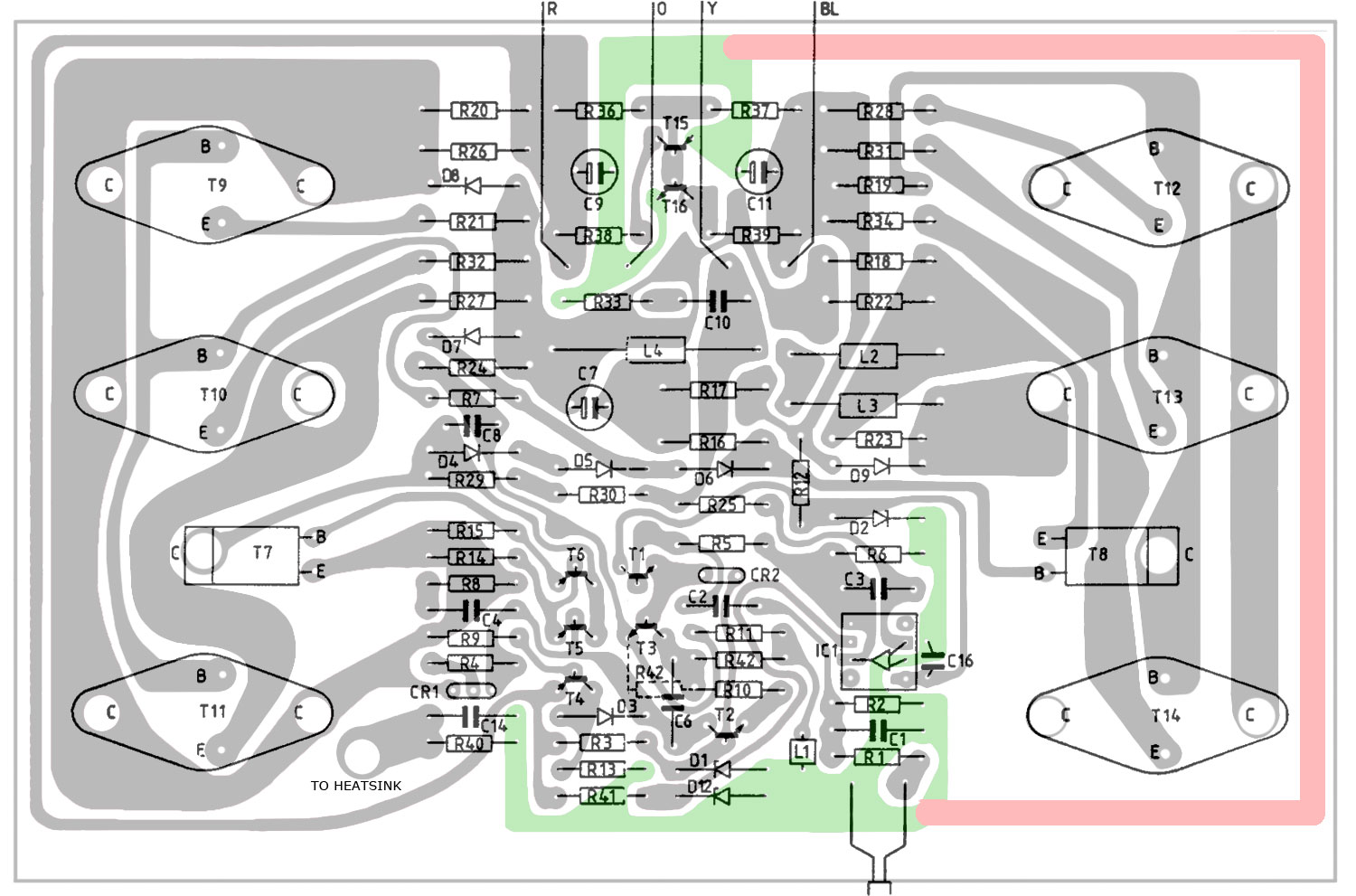

Here's what the service manual states for modifications:
(9) June '87 (SN 4500 approx) Shorting link of 16 SWG (1.5mm) tinned copper wire connected across PCB track earths. (see page 13) 330nF (C330NXA) capacitor C20 fitted across mains transformer primary. To reduce interference from electrical appliances (thermostats etc.)
(10) November '87 (SN 5700 approx) PCB iss. 3 introduced to improve screening and reduce interference from electrical appliances. R14, R15 and CR1 taken to R20 and R26 supply rail to improve performance.
Page 13: Fitting link to Issue 1 & 2 PCB
Mod 9 In cases of interference from household appliances, thermostats etc, connect a link across the track side of each amplifier printed circuit board as shown below.
(a) Scratch the protective lacquer from each PCB at the two points marked 'O' adjacent to 'C9, R3' and 'IN' respectively, and connect an insulated piece of 16 swg (1.5mm) tinned copper wire between these points as indicated.
(b) For very severe cases a 330nF 250V AC working capacitor (C20) may also be connected directly across the mains transformer primary connections.
These modifications were incorporated in production models with issue 2 PCB, from S/No 4500.
Wouldn't it be possible to just add a track like the attachment or is that poor design. If the track is not a good solution, is the quad wire mod any better?
