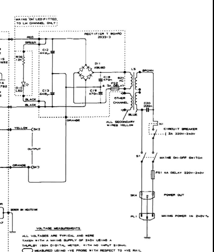

QUAD 606 MKI
Looks like it. See attached schematic.
