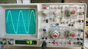

A CRO is a cathode ray oscilloscope, sort of a TV for looking at waveforms. Nowadays they are usually LED or USB / PC based. You would connect this to the output of your preamp and look for disturbances when you are prodding around inside.
CRO Cathode ray oscilloscope - YouTube
