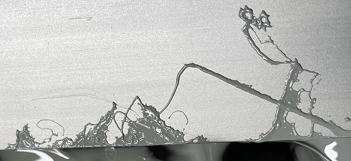

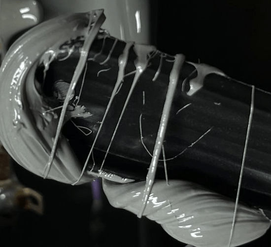

BTW, Quad service advised me to junk the unit. The guey mess is everywhere inside.
I’m sorry, did not keep the pictures. Individual who had the unit previously is not communicating after I sent him the pictures of the meltdown. Probably thinks I may return it for a refund.Interesting, can you please post those pictures, for a before/after comparison?

That does not come out of a transformer, what it is, is the previous owner experienced a mechanical noisy transformer and decided to pour epoxy over it to try and reduce the mechanical hum.
There is no epoxy inside a transformer that can be released with heat. Just a case of an ex owner unsatisfied with the mechanical humm and noise and decided to pour epoxy over it to "glue"the laminations together.It's a real one. Those PSU capacitors are genuine, and also the transformer. You can't get either of them this century. I would worry about the transformer: it must have severely overheated, and may have internal shorts. Replace with a toroid.

That is NO meltdown, which would be a "solid mass" and pooled at the bottom of the unit, gluing cover to cabinet, the works, but an incredibly incompetent "gooing" or "gooping" process, probably to "cure buzz" .

Look at the pictures again and think of the Law of Gravity: that grey goo did not melt inside and flow down, but the amp bottom cover was removed, it was put upside down on a table and goo was poured from a can inside, over PT and some wiring, reaching transistors and heatsink.
A MESS.
The telltale signs are the hair thin "threads" around the main mass, not consistent with melting and fully explained if poured from a can.
Spiderweb thin threads .... even a perpetrator´s hair caught in the mess.
And the sheer amount of it!!!!!
A transformer may take, say, 50cc impregnation varnish, as the many distinguished transformer winders in the Forum may attest, and there you have half a liter.

I think there is an insulating product called "liquid tape" , it might be that.
You say it sticks to your hand and you had to use solvent to remove it?
Which solvent?
Transformer varnish dries hard and does not re-melt (it expects a hot transformer 🙄 ), that was NOT Quad applied by any means.
