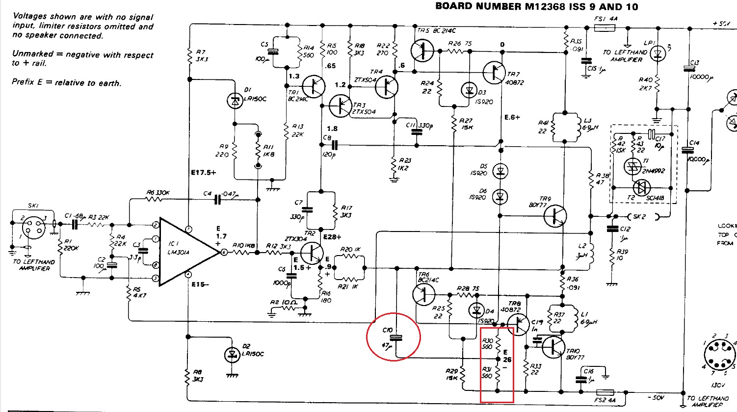

Quad 405, R31 overheating

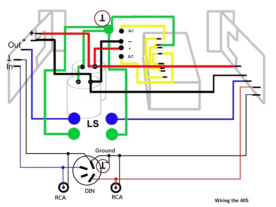

The DIN input must not be grounded. It must be connected to the PCB via the shield, from whence it is grounded to chassis via the 10R ground-lift resistor R2. Same for RCA sockets if fitted: they must be insulated from chassis ground.
Yes, we usually design an amp with input ground floated by a 10 ohm resistor from the power supply ground.
But Quad 405 amp is a little bit different, the input op-amp also function as a DC servo control circuit, if it connected as original Quad 405 ground wiring, it will control a nearly 0v dc output, but if the input floated, it will has a small DC voltage output, both ground connection have no different in sounding, but for the 0v dc output, Quad 405 user better connected the DIN input ground to chassis.

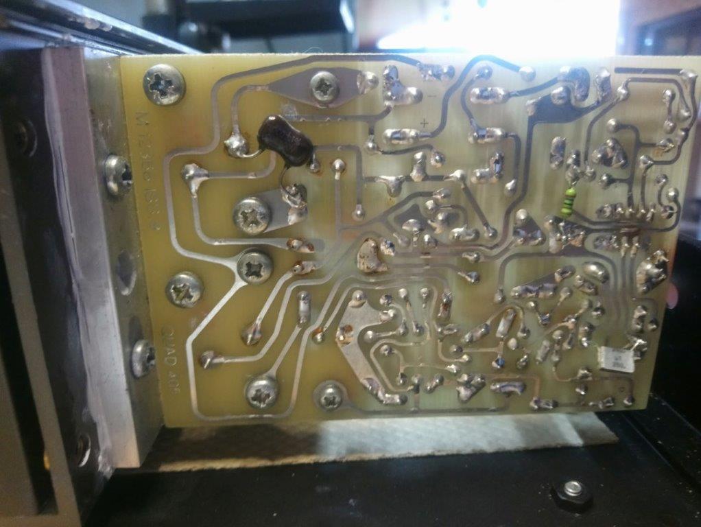

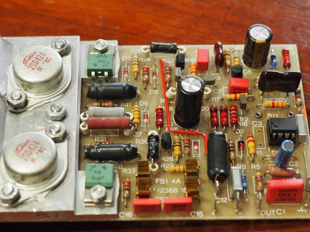

Hi, Kffern
What power supply cap you are using and please show more pics of your amp, thanks
Currently I'm using a pulled pair of 10k uF, 63V Rubycon caps.
I had initially fitted a pair of these : KEMET ALT22A153DE063 Electrolytic Capacitor, Long Life, 15000 µF, 63 V, ALT22 Series, 26000 hours @ 85°C, ± 20%. I put them in the original clamps and silicone.
I swapped back to these which explains the messy fit and single screws on the clamps. It was a bit easier to work on with these smaller caps. I even tried the best of the original caps which I used very tentatively. As expected the problem didn't change at all.
I will tidy up the wires once I get the new caps in. I have bought some screened coaxial cable to rewire the input wires. Hopefully that might get rid of the left channel hum.
