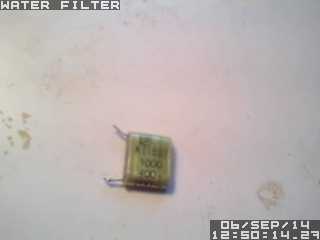

Getting ready to replace the caps, i have one which i need to know the voltage and capacitance of, please see attachment. It is the ERO KT1807 series, light green in colour and square, flattened. It is labelled as
ERO KT1807
1000
400-200~
+-10%
J5
Thank you. John.

That's a blurry picture. Can you relate it to the Quad circuit and see what value its meant to be ?
Those type of caps rarely fail in my experience. 1000 at face value is 1000pf or 1nf.
I can quickly see two on the Quad circuit, one near the opamp and one across C and B of the lower output transistor.
Hi. Thanks for the reply.
One nano-farad it is then. Thought since i'm replacing them all then may as well include this one

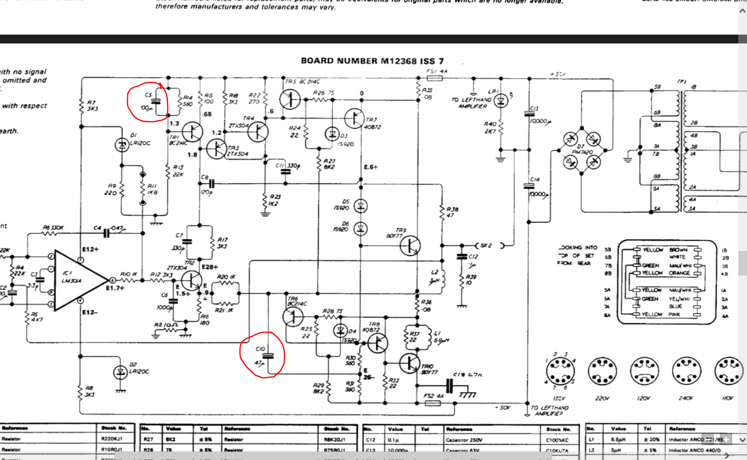

There are two 100uf caps on the board, c5 and c10, are these the decoupling caps for the output transistors.
Thank you. John.
Thank you. John.
Hi Mooly. Thanks for the reply.

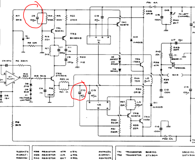

I followed the tracks and noticed c5 and c10 may be acting as decoupling capacitors for the output transistors.
c5 right output transistor c10 left
If i wanted to add some extra decoupling could I solder a 100uf capacitor to the collector (case) of the output transistor, then run the negative of the 100uf capacitor to the respective c5 or c10
Thank you. John.
Thank you. John.
You are describing something totally different to what the circuit shows. C5 and C10 on my diagram aren't decouplers. Even on the first generation Quads they were labelled the same and as you can see, the collectors of the outputs mustn't under any circumstances be decoupled because they have circuitry in the collector feed from the rail (top output). And the lower output collector is the audio output.

Just checked, there is zero impedance reading on my meter, between the positive terminal of cap c5 and the right output transistor collector and also zero impedance between c10 and the left output transistor.
Thank you.
Thank you.
Hi Thanks for the reply.
Thank you.
I can only go off what the circuit shows and it shows that those two caps are not decouplers. Replace them by all means but you must stick to the original values and points on the board they connect to.

@Mooly Is it possible to place decoupling capacitors very near to the output transistors and / or driver transistors in some other I want to create a local power supply for the components to tap into, rather than having to wait for the main power supply.
Thank you.
@Godfrey. I make it 0.03 ohms, may be my crappy meter
Thank you.
The only place to add anything would be from the fuse/R35 junction to a suitable groun, and getting a correct ground point would be vital, otherwise you could be making things worse by injecting rail noise. If you look at the circuit there is decoupling from the emitter of the lower output. I would like to think there is a reason why its not done similarly for the top section too.
You need to be very very careful. Just adding parts in hope could reduce the overall performance.
