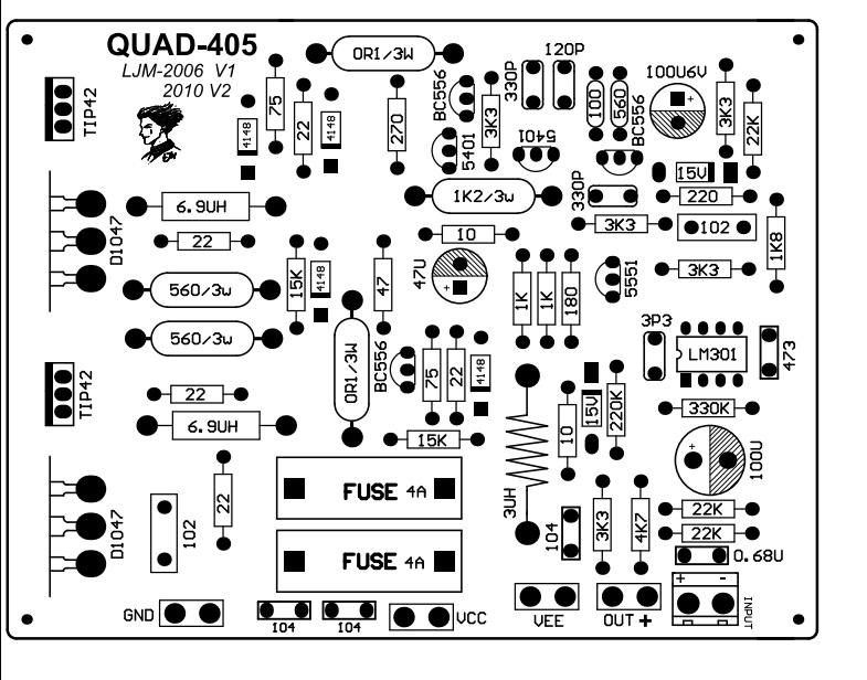

Hi, I recently bought a 405 amp with 34 pre-amp. One channel of the amp was faulty (both fuses blow at turn on). With the 405 came two Ebay clone boards. They are similar to the ones I've seen on Ebay except that they have a heatsink fitted and the output transistors are of the can type. Anyway... I decided to keep the 405 as quad intended and sent the amp module off for repair, meanwhile whilst I'm waiting the clone boards kept crying out to be tried.. so one +/-50v supply later (and with only one amp connected, just to be on the safe side) I turn on. All seemd fine until I connected an input. Then much distortion and hum and then came the smoke (not a lot and I can't see the damage). I have since tried the other channel and all is well. The first channel however remains loud and distorted but not smoking. I'm certain that all wiring etc was ok, the only two things I can think that I might have done wrong are; 1, overloading the input on the first attempt and 2, not running a separate 0v to the heatsink. Any ideas what I've done to my project??

I have a lot of experience with 405......clones...originals....
Can you post some pictures..? There can a lot of things go wrong. I suspect that you somehow miss the ground conection. Original board have a bolt which connect ground to the heatsink.....If there was no ground on the board it oscillates.....and probably burn the 10E resistor at the output zobel network...

Brilliant!! Many many thanks! R10 had indeed gone down to 1K. Smiles abound once more!!
R10 ?
It is 1k and it is connected to the output of the ic1 .
I meant R39....and sometimes even R2 which connects both grounds...
They should be 10E both...
Regards,Taj

If you get a humm when you join channels, that is a ground loop.
If the 10R resistor which appears to be part of the Zobel network is getting hot, the amplifier is oscillating.
Signal earth should not be on the chassis. Connect that to safety earth. The input sockets should be isolated from the chassis. Connect both signal grounds at one point only, and then connect this point to 0V star earth at the main supply capacitors, via a 10 ohm resistor. Somewhat like this:
Hi sorry for late reply...I have a lot of job, I'm trying to rent a flat in London....
Well quad. There you have 2 10E resistors at the each board. One is a part of output zobel filter. The other connects both grounds. The power ground and the input ground. And what I think is.....
You have no power ground at your boards so they oscillate and burns zobel resistors....and because amp wants ,,to ground itself ,, it is happening through those 10E resistors (R2) it is even worse if you have unisolated rca plugs bolt to the chasis ......
So you need to connect the power ground to the both boards. It is for an example the opposite side of zobel output network which isn't connected to the output. You have there 10E resistor in series to 100n cap. I don't know which goes to the output and which to the ground but one side is ground and the other is speaker output.

Original quad 405 have ground connection on each board. It is connected to the heat sink directly via bolt.....This is power ground which goes to speakers and to the 0V on power capacitors......
The other ,,ground,, goes only to the inpput connector which is isolated from enclosure.....This is signal ground.
Both grounds are connected with 10E resistors. On each board.....
So those ebay boards seems ok to me....if I find right item.....

The eBay kit is for a 405-1 using an LM301 - its not a good version. They make a big deal about 1% resistors etc. where the whole point of the design is that it doesn't care (mostly) about component tolerances.
They even point out how accurate the 3uH L2 inductor is - in actuality, it should be 2.82uH to balance the bridge.
Odd that they went to all that trouble to make a clone board, then chose an old revision that even Quad themselves heavily updated 20 years ago, let alone everyone else.

All is now well and no need for any more help. I knew it was something stupidly simple. When I finally sat down and got a look at the circuit diagram I realised that the cloners had managed to reverse the lables for the signal in and earth! I hang my head in shame. I'm really sorry to have used up your time, but at the same time really glad to know that there are some really helpful people out there!
At original 405 it was done like that. The centre point of the poer caps goes to the chassis. Speaker returns goes to the centre point. Boards are only bolt to the heat sinks and that's all. No wires no anithing......just bolt. The signal ground goes from board to the input connector....
