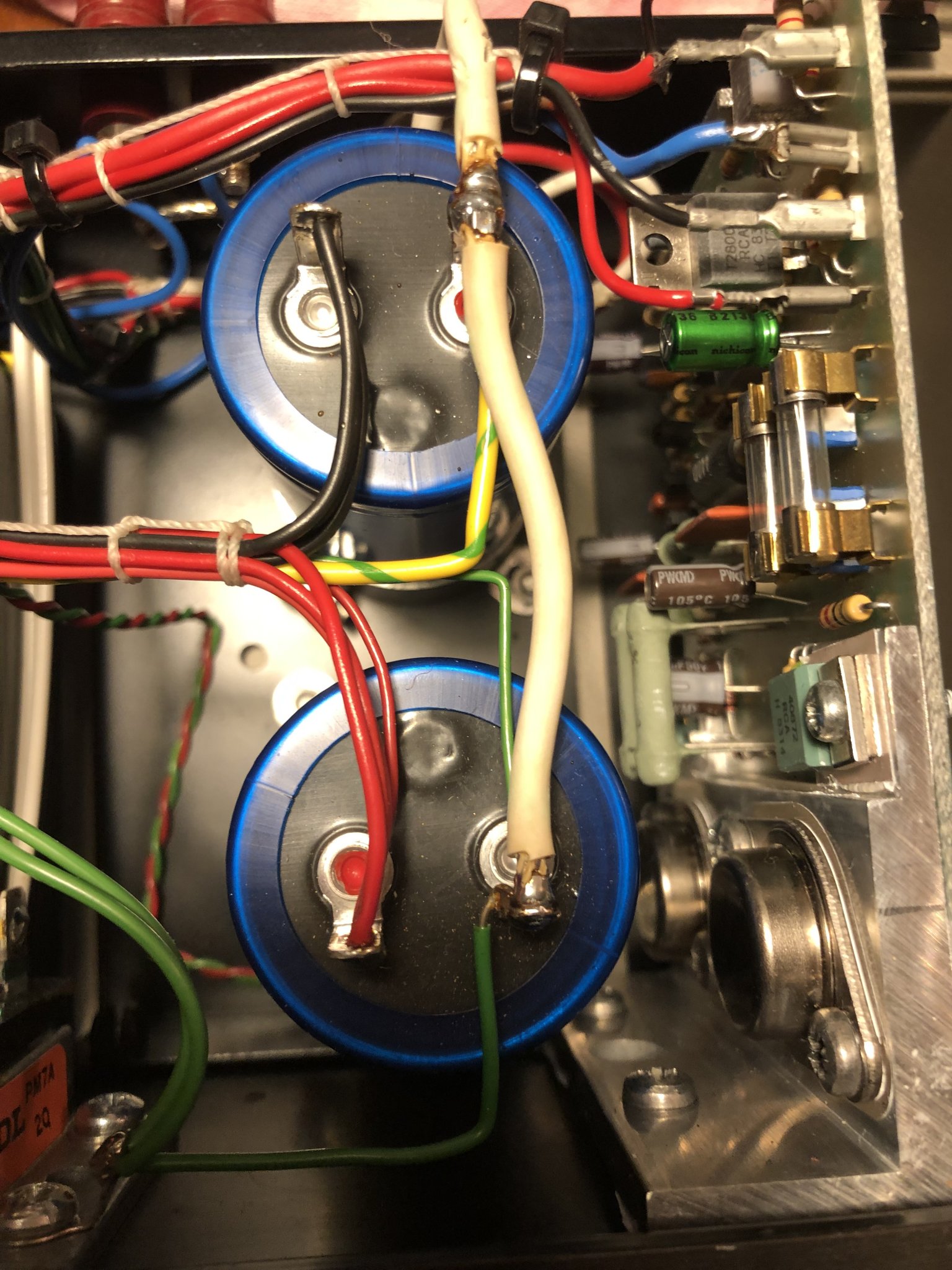

I’m helping a friend refurbishing his newly acquired 405-2 amplifier. It has had prior work, capacitors replaced at various points in its life, new speaker terminals and cabling from the negative speaker terminals replaced. I’ve now replaced the all capacitors on the boards with Nichicon PW & an UKL instead of the tantal, two Nichicon KG Super Through for the PSU. Both R7/R8 have been replaced with 1w resistors. After testing I now have a low level hum on both channels, I would say it’s around 100khz, so guess it’s rectified. It’s only noticeable when pressing your ear close to the midrange. I did some testing before doing work on it, but didn’t notice the hum then, not sure if it was there or not since I didn’t listen that closely. DC-offset was low and still is, 0.45mV and 1.5mV respectively. I’ve checked all grounding and as far as I can tell it’s all good. Can the new routing of the cabling cause this interference? Some before and after shots.
It is possible, particularly if something like the input cabling is routed near something carrying high peak currents such as the PSU wiring. The peak rectifier currents even when idling are very high and that can radiate from the wiring and be induced.
Try with both inputs shorted and nothing else apart from speakers connected.
I'd be leaning towards ignoring the problems subject to test equipment availability, ie, do you have an oscilloscope, if so confirm 100Hz hum rather than 50Hz (mobile phone apps can do this). If 100Hz then I'd be checking for "excessive" ripple on any regulated psu, ie, a tired transistor/regulator. Rule out PSU if it feeds both channels and hum only in one.
