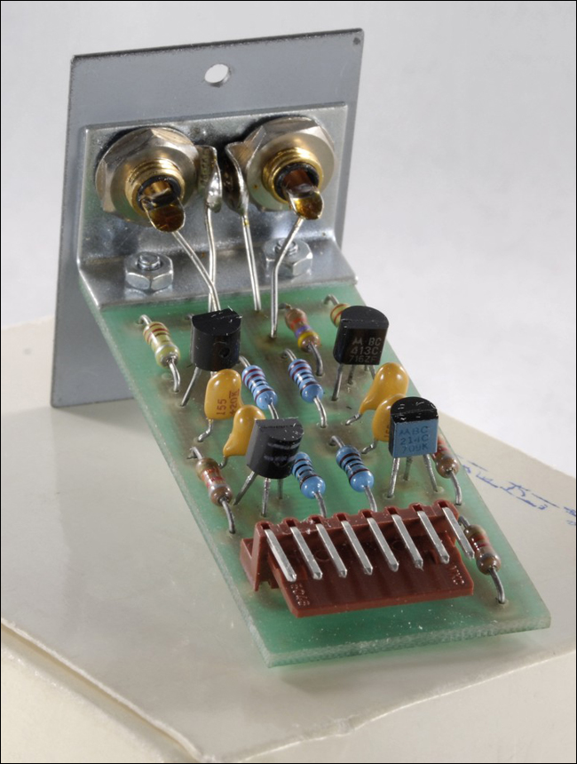

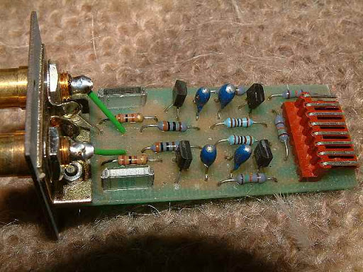

Thanks - no, it's MM, a new AT-VM95E with recommended load capacitance 100pF-200pF total. As there is probably about 100pF in the arm wiring I think 47pF on the module is a safe bet.
I can't use ANY of the existing components because the board is an MC board and all values are different so all components will have to be removed. I will need to buy a full set of components, including new tantalums, the BC550C/BC560C, the 47pF and all resistors.
Below are photos of both versions. The MM one has 220pF ceramic capacitors that look like resistors. The one with the stacked film caps (22nF) is the MC one.
Not so keen on those stacked film capacitors they come away from the ends pretty easily and too much heat from a soldering iron and they fall apart and melt .
Buy low noise metal resistors ( or better ) as this is a sensitive input position , personally I would replace all the capacitors with polystyrene but D.Self likes COG whereas I am a JLH man.
Low ceramic ( COG ) goes up to 330pf after that there is a big difference in the value of "D" and stability , keep with tantalums and I also spend as much money on the input as I do on the output active devices I buy---buy quality it does make a difference.
As far as I know, 100 nF C0G / NP0 capacitors are as good as 100 pF C0G / NP0 capacitors, but until the invention of the multilayer capacitor, 100 nF NP0 capacitors simply didn't exist. Back then, all ceramic capacitors above a few hundreds of pF were made with X7R, Z5U or other lossy and nonlinear class 2 dielectrics.
