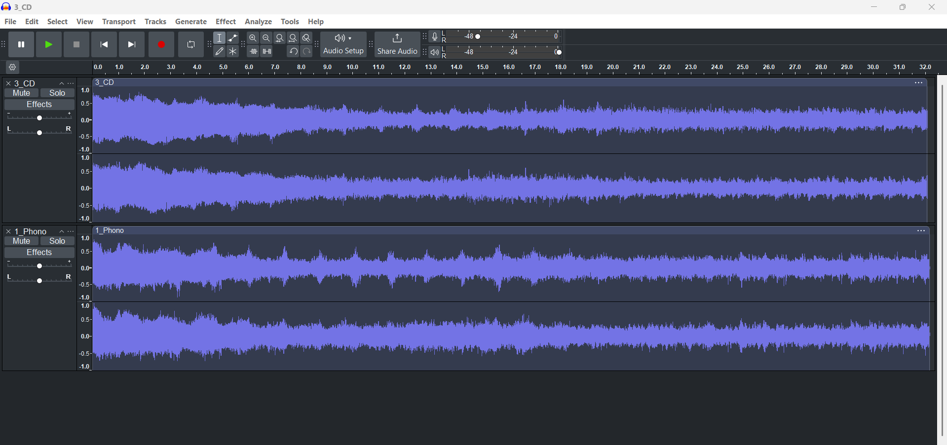

Failing all the above... if you have means of recording the line out of the preamp to a PC (Audacity again 🙂) we could have a listen to a short 30 second or so clip on phone vs line in. A 192kbs MP3 would be fine.

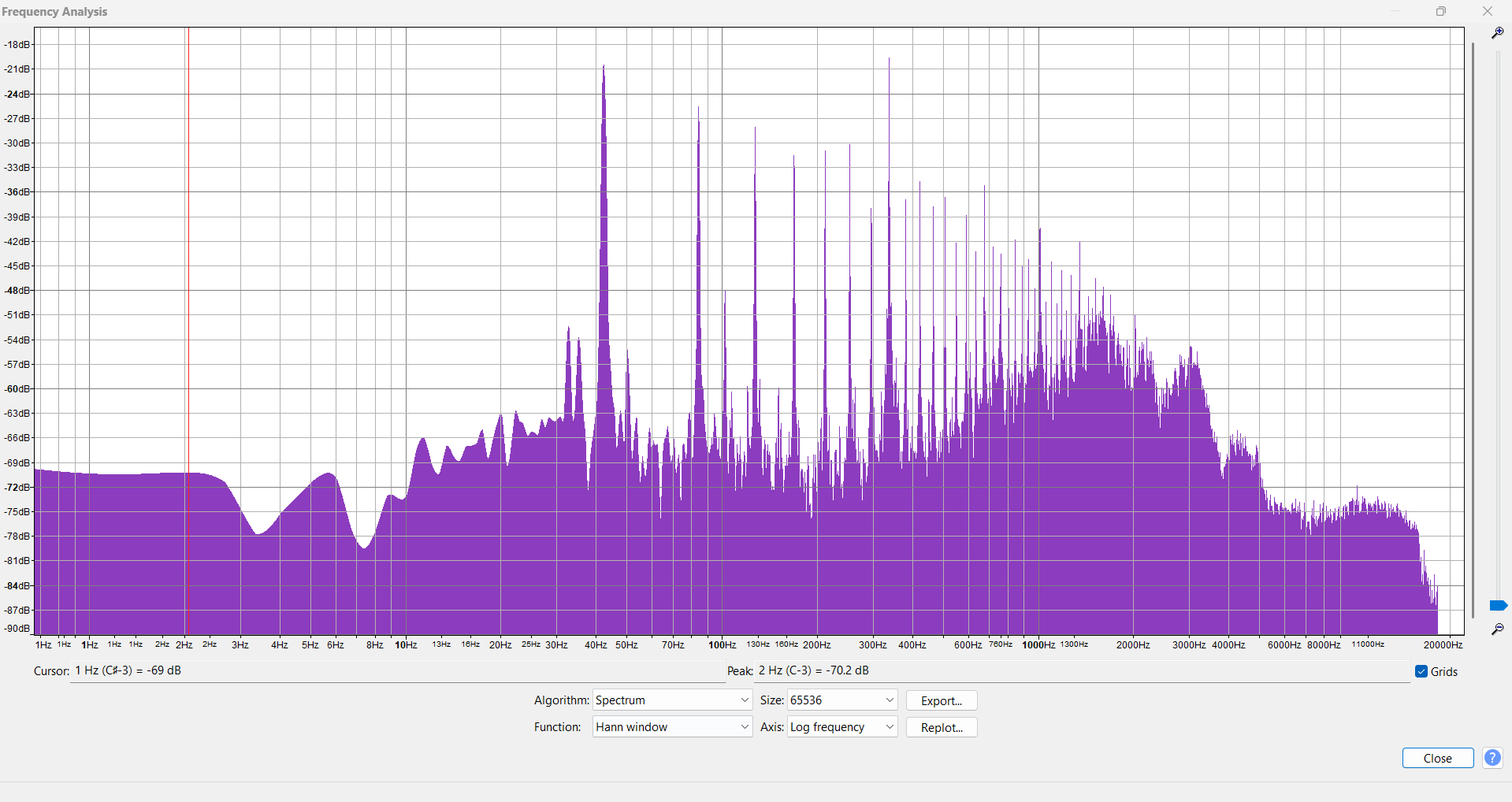

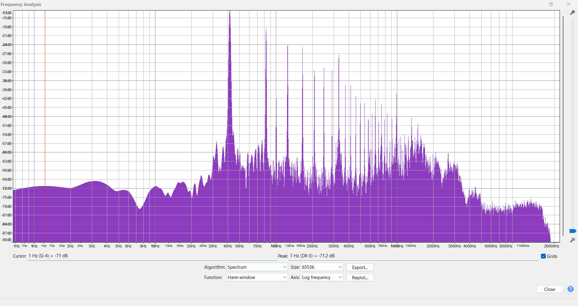

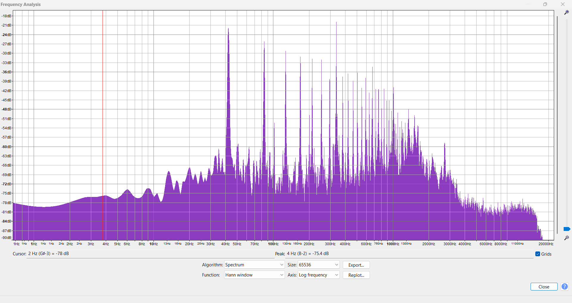

Quick plot of the first 5 seconds of the left channel from each to look at bass line amplitudes. Nothing jumps out somehow.

All records sound bass light - sadly I seem to have very few recordings both on LP and CD. I doubt if the Pink Floyd was mastered with LF cut, and it sounds good using the Kenwood preamp. Here are a couple more recordings....
Both the Pink Floyd and Santana recordings were made using a JVC L-E5 and not the Garrard 301/Shure V15III which is usually used with the Quad 33, but the differences between CD and Phono remain the same.
...........but the differences between CD and Phono remain the same.
Yes up to a point. Obviously still different but the earlier tracks were much more bass heavy.
