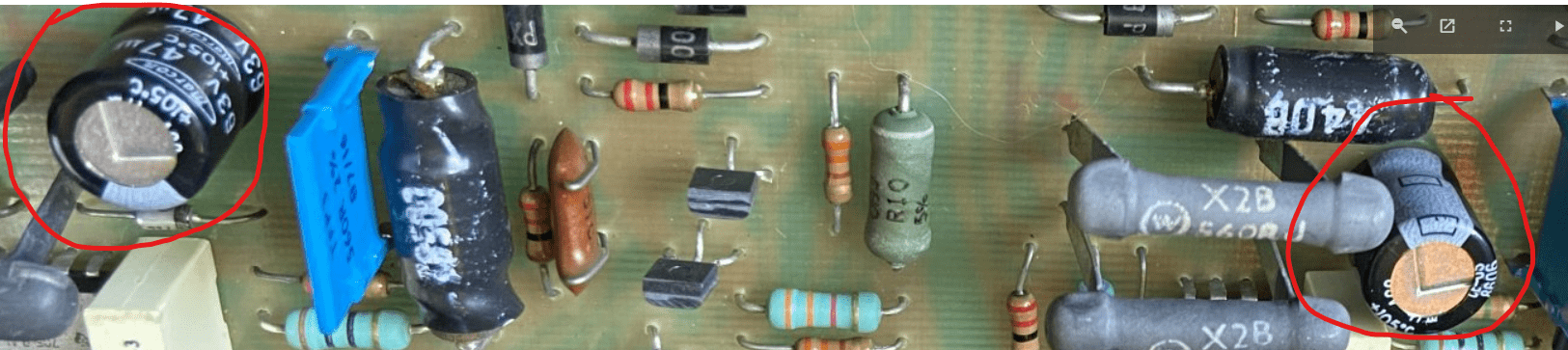

Easier get idea with scope waveform.
Amp looks clean and gone through.
So likely end of life semiconductor or related circuit.
Current source ,input stage etc etc.
Its only guesses without data.
very unlikely a cap issue. looks gone through.
Ok, interesting.
The fact that the seller mentioned that he'd recently replaced the caps also backs up your point about them looking fine.
Totally understand that you need the data to really figure out what the issue could be. Sadly, I wouldn't really know how to collect that data! (useless, I know)

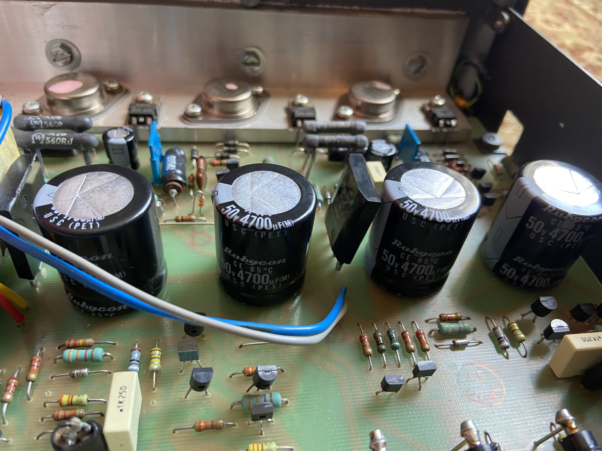

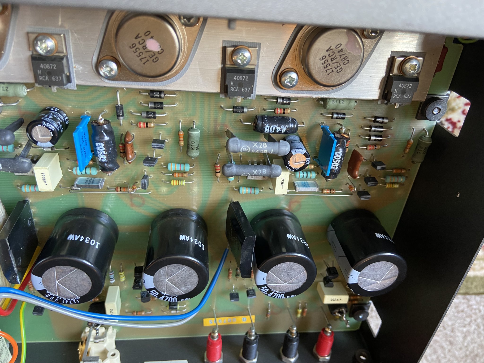

The 306 PCB uses unplated holes, so dry joints are very likely.

Hi everyone,
So I sent my amp off to Amp Labs - thank you for the recommendation!
I thought there might be some people in here interested in what was going on.
This was part of the report I was given at the end. From what I understand - in my very limited knowledge(!) - it was a driver transistor that needed replacing, amongst some other bits.
It's now working perfectly, in fact, I think it sounds better than it did before!
I'd like to continue the recommendation of AMP LABS, as their engineer, Rob, did a fantastic job and I'd highly suggest you get in touch if you need a vintage amp servicing. ALSO, the prices are very, very reasonable.
Find them at: www.amplabs.co.uk
Action taken:
Full set of smoothing and other electrolytic capacitors tested for ESR and value;
Main smoothing capacitors measure 100% with low ESR and well within
tolerance. Checked bootstrap capacitors for value and tolerance Measure 100%
Checked for dry joints on input sockets and Driver transistors–all ok.
Carried out full signal analysis on both channels to isolate fault/s:. Driver
transistor on right hand amplifier section o/c –replaced. Associated heat-sink
washer replaced. Checked L & R bridge components for THD on both outputs –
result well balanced below 0.07% @ 5W rms/8 ohms on both channels.
