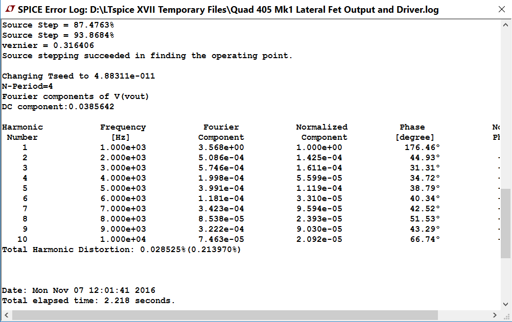

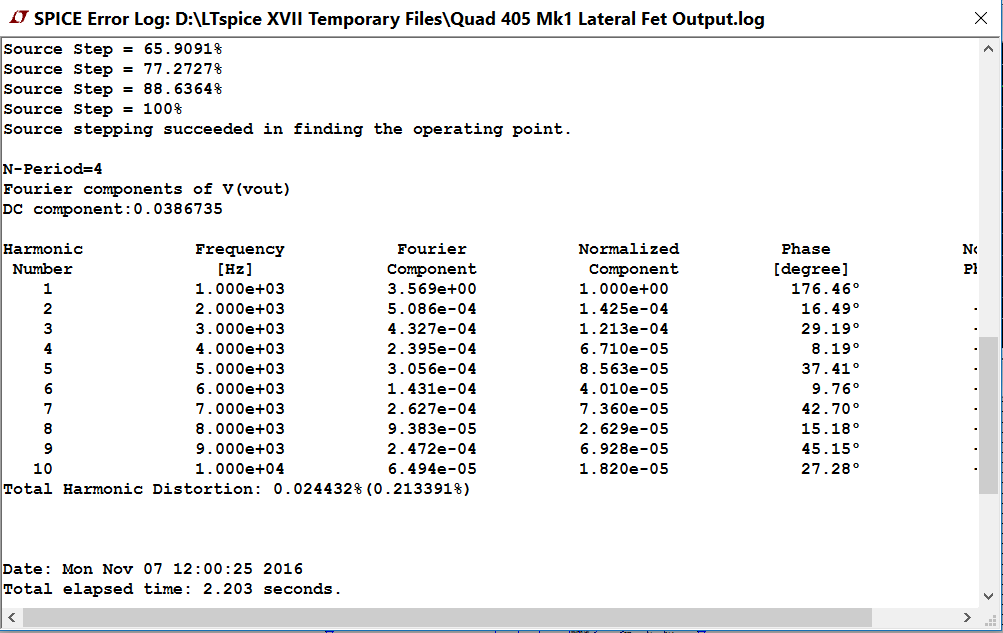

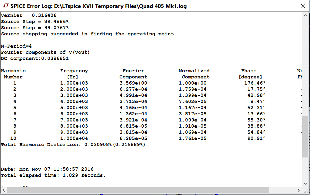

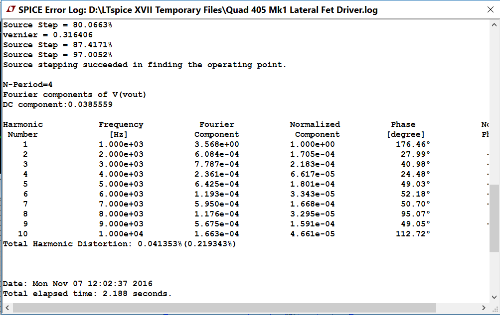

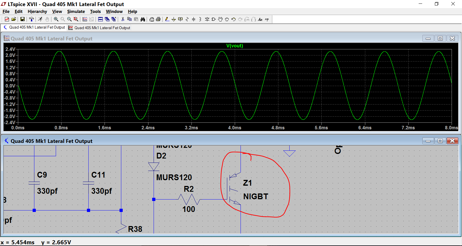

Lateral FET's in a 405 is something I have wondered over. Actually replacing just the Class A driver could be the one to go for sonically.

The 405 class A side. I wonder if the op amp used in the 405 could be pulled into SE class A using a current source ? There might be enough spare current to still do it's prime job. OK the book figures might look worse due to more second harmonic ( 0.05 % ? ). At least it would be all class A up to the 5 watts limit. If DC off set was a tad higher I could live with that. 405 is the mother design. The 303 is not of the same type. it is a masterpiece ( spectrum ).
I recently did the class A op amp trick on the LM324N op amp. It is a chip so bad that it nearly didn't make it to production ( it has crossover distortion ). It's designer said it was made cheap to hide their shame ( that's me adding a bit of colour ). I built the LM324 into a State Variable filter. I was very surprised how well it worked if hiss wasn't the prime question. I took it to very high frequecies also. It sat with a NE5532 mostly. Now that is not important except to say it works. My friend made a current dumper in the 1970's for his BSc. He used a 741 with that trick. I would guess 5 mA would sit in the right place. It might be less. BTW. If you are as perverted as me and want to improve a LM324 make all your stages inverting. It won't make a scrap of difference stage to stage, it will keep 2nd harmonic down.This is more true if using single voltage rail and typical biasing. LM324 is my favourite comparator as it can both sink and source current. It costs about the same as half a cigarette UK prices in small quantities. 4 devices in the chip and bomb proof. Sometimes something needs to be bad so as to get real data. Trust me LM324 is bad.
BTW. The 405 can be balanced to have vanishingly low HF distortion ( inductor in the bridge mainly) . Perhaps 20 dB better than claimed. Quad saw no reason to do that. Shame really as some of us would have paid 30% more for a 606 calibration with a nice badge. Dr Smith of Harwell ( UK's brains dept, JET, Diamond light source, Turbo Jet-Rockets nearby ) showed me his work on this. He said he thought he could hear a difference. What I learnt from him is the speed of the output transistors makes no difference to the 405. Devices that can not do 1 MHz are OK and will not change the results. The lower frequencies are dominated by negative feedback as in any conventional amp except they are dealing with a horrible gain notch at a rather low voltage. Hence me asking if FET's like BUZ900/905 wouldn't be better.
My mind says if the 405 current limiting was removed and FET's added the Krell amplifier would not be on my shopping list. Only one way to find out. I will also find the largest toroid transformer to fill the box, the 405 transformer is 200 VA I think I was told. It cooks if asked to give book spec for 10 minutes. The crest factor of real music is never worse than 3:1 ( 6:1 more typical ) which say 200 VA is enough. These days 500 VA is cheap. I suspect the amplifier would be just as durable. Vigortronics are OK for off the shelf.

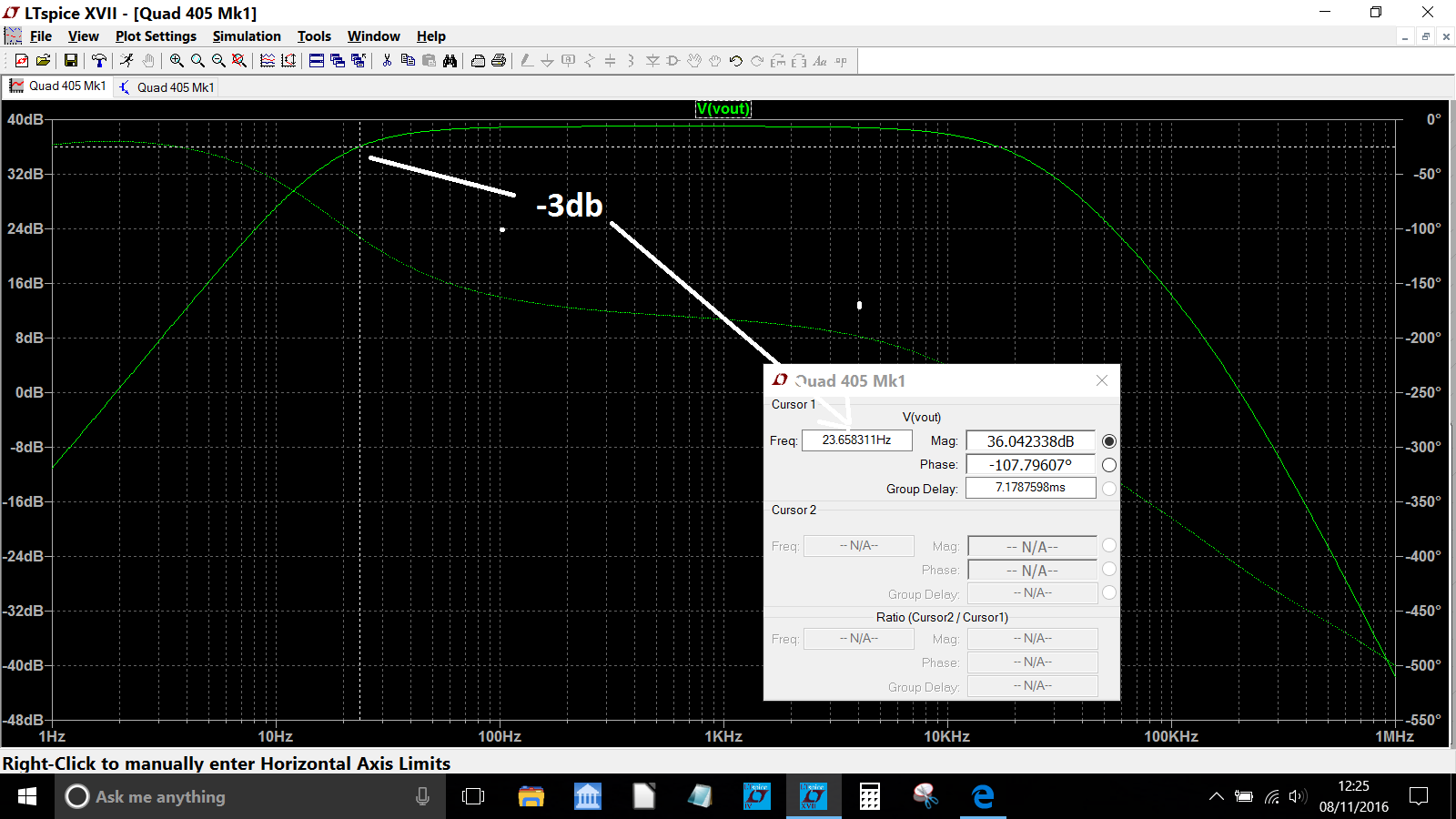

The response of the original 405 does suggest it to be bass light by modern standards, although the -3db point is near 20Hz.

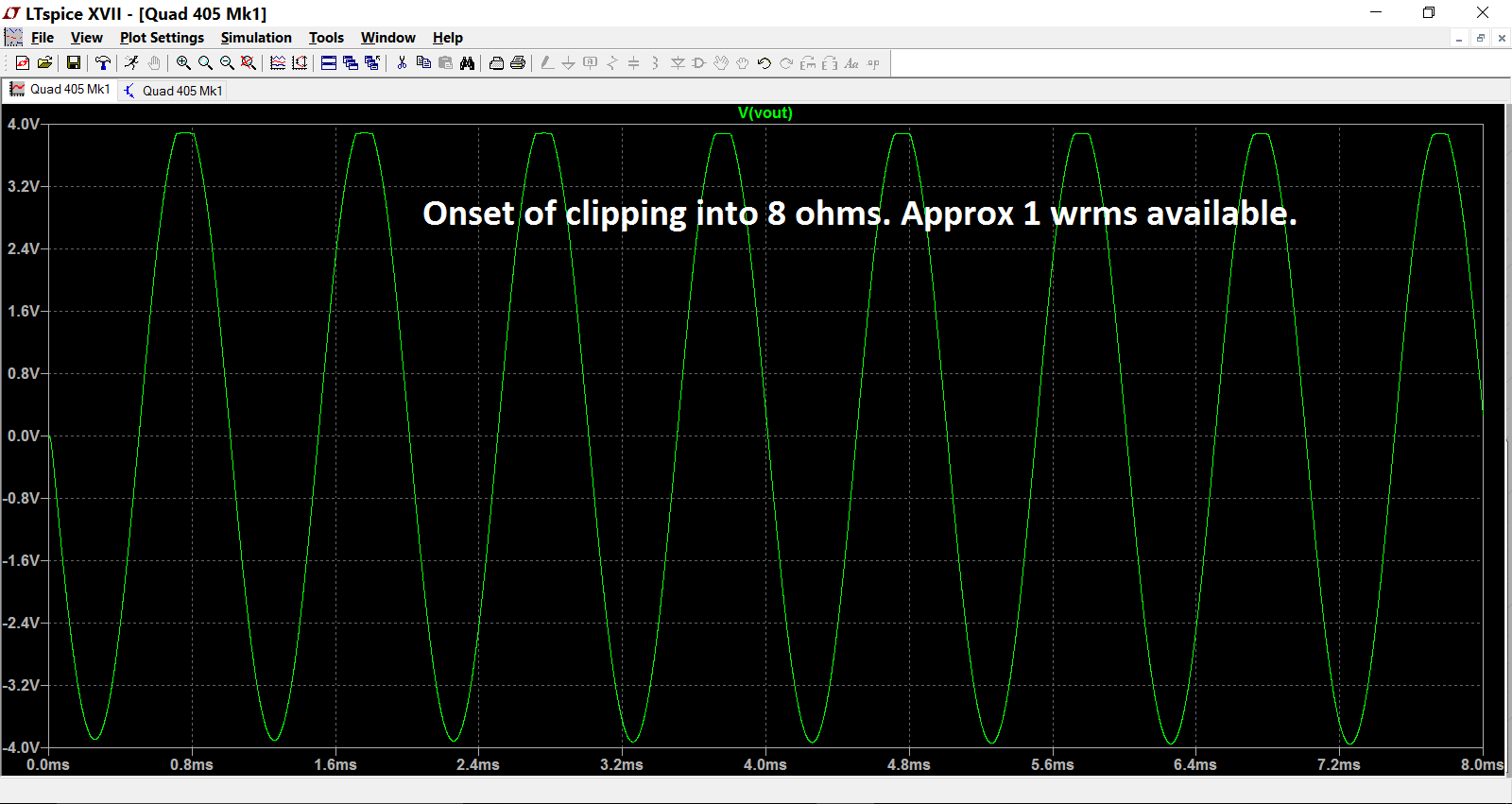

Removing the dumpers shows that around 1 wrms into 8 ohms is available. That limit occurs on the positive half cycle and appears to be driver/device related. The negative limit is set by the two series 560 ohm collector load for the class A output.

Once the dumper transistors are connected the class A amp can only swing +/- 0.6V before they are biased on, so the class A amp will only deliver about 20mW into 8R, you could insert diodes to further de-bias the output stage
Stuart
Stuart
So... on that basis then, using HEXFET's rather than laterals allows more output from the class stage before the dumpers turn on.
In simulation we can get almost 1.3 vrms across 8 ohms before the dumpers conduct. The laterals only around 120mv rms.
I might have more of play with these tomorrow. It would be interesting to compare distortion profiles.
I wondered about using IGBT devices as these have a high turn on voltage, I bought some but have not had a chance to try them yet

The IGBT might work if it has an internal feedforward resistor. I doubt it would. In a Darlington I believe these mostly are fitted to speed the device up by offering a discharge path, the FET will be discharged by the driver stage with ease so needs none. I also wondered if the addition of a diode would help the existing design.
Why the Audio FET might work is the curve never really switches off. I suspect negative feedback could be increased if like other MOS FET amps. Personally I wouldn't bother as first watt is my goal. I would extend the - 3 dB poing to maybe 7Hz and filter my preamp if needed. The 405 is filtered to protect the Quad speakers ( I was told ). It is said that's why Quad 33 adverts show the preamp at +1 on the bass which brings it to a possible user preference. That isn't right really as the curves don't overlap.
