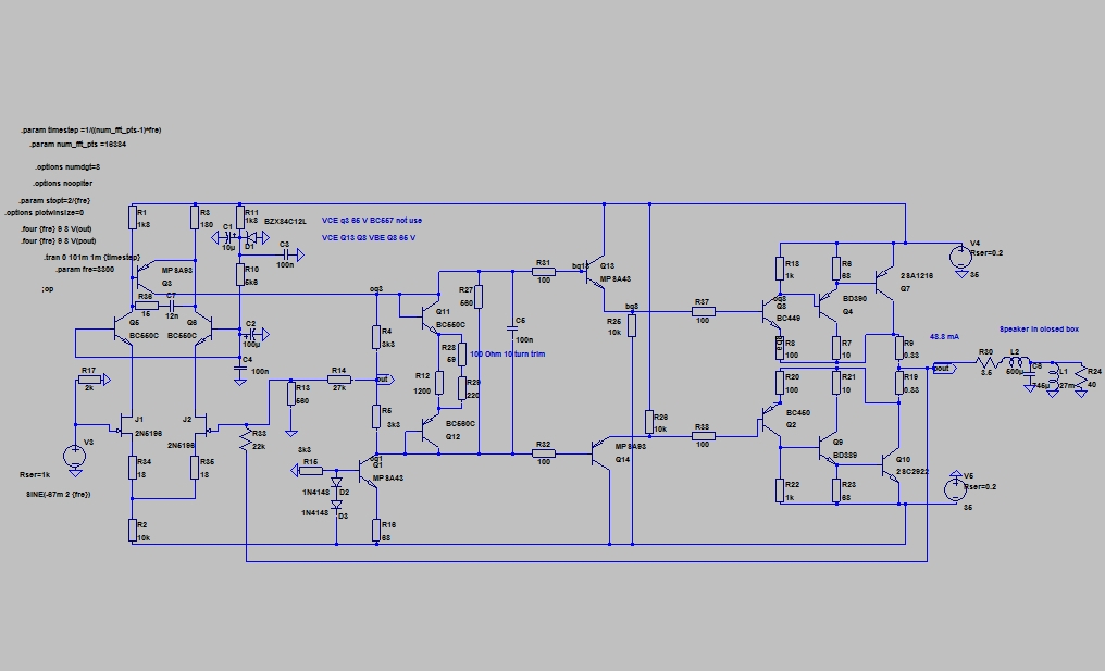

Attached find an interesting amp which I designed with LTSpice.
The design objectives were:
1.) the harmonics spectrum should stay constant ( that is the relations of the amplitudes of h2 to h3...h9, h3 to h4..h9 etc) in db independent of frequency from 20 hz to 6000 hz
2. the harmonics spectrum should be constant from 1% to 90 % of full power
3. the harmonics spectrum should be independent of reactive ( i.e. complex) load
This amp has little overall feedback. The thd is not at all low, in fact it is about 0.3% but objectives 1 to 3 are met. I have been testing with various speaker models, also 4 way with complicated crossover, and electrostatic midrange/tweeter. In simulation, it works.
The really built amp, tested with a spectrum analyzer , matches the Spice sim
closely but has in fact less thd about 0.15% . The sonic quality reminds vividly of good to very good tube / triode amps.

The VAS stage looks like Lender's circuit
http://www.diyaudio.com/forums/soli...age-large-voltage-swings-lenders-circuit.html
What about R26/28? Why are this connect to the supply rails instead the output line?
In general there is no justify to make such complicated topology (my experience). My favorite design is that one from the links by post #13 about
http://www.diyaudio.com/forums/solid-state/99967-anybody-have-scan-483b-motorola-2.html
in an optimized version
If you have build both topologies in high quality standart you will not able to say, which of them is clearly better - for this I am quite sure.
A great disadvantage of your topology is the DC coupling of the speaker and therefore an relais contact in series to the speaker wire for DC protect.
Connecting R26/28 to output has negative influence on OLG as well as on open loop cutoff frequency and thus violates design objective.
Btw the insensitivity to reactive load comes at the expense of damping factor
which is independent of frequency but quite low about 100.
Also btw with a symmetric input the design objectives are not met. The 2N5196
has two jFET on one chip and hence low temperature drift and almost identical
charcteristics there is no pFET available with such properties.
