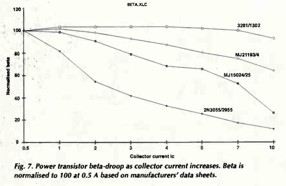

But the 2N3055 is not a very good transistor, because beta is strongly dependent on collector current https://www.onsemi.com/pdf/datasheet/2n3055-d.pdf.

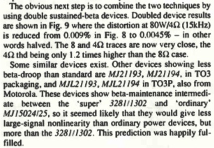

There are far better much more recent modern power devices which have constant beta up to many amps such as https://www.onsemi.com/pdf/datasheet/mjl3281a-d.pdf , alas unsuitable for the 303 because of their fT in the tens of MHz. They are however the preferred power devices for Douglas Self Blameless power amps.
"The 2N3055 is not a very good transistor". Well, there are indeed much better devices today. But again let's be clear about which 2N3055 is being discussed. The old RCA hometaxial types were slow. Epi devices were available by the end of the 60's, and Bailey's 30W design was well respected. The modern 2N3055 is an epi based device with an fT of several MHz (2.5MHz min). It and the MJ2955 can be used in Bailey-like designs with similar or better performance despite the gain droop as long as that is designed for. Compared with Self's Blameless, he used MJE340/350 drivers which drooped at 50mA but the output transistors were MJ802/4502 which only had fT's of 2MHz, but maintained gain at higher currents. His original Blameless swapped droop in the output for droop in the drivers, it appeared to me.
Nevertheless, the modern high gain devices offer better performance all round.
And at risk of repetition, it is possible to use the modern epi 2N3055 in the Quad 303 (essentially the circuit- not as an original box refit). I've managed to halve the distortion and double the bandwidth at the same time, with some optimisation of the frequency compensation. I suspect it would be possible to use 3281's or 5200's in the output with similar considerations, but whether they can be used with existing wiring between the PCB and heatsink in a refit is another question.
You are right about the original Blameless in Self's articles in '93 and '94 Electronics World. The design has evolved quite a lot since, although still retains the MJE340/350 drivers.
But most of Self's work on blameless power amps was done by the late '90s, see for example https://www.worldradiohistory.com/UK/Wireless-World/90s/Electronics-World-1997-01.pdf which is a "load invariant" design which doubles the output devices.

I see the mention of some related transistors:
Looks like the MJ21194G or if you cant find one, the MJ15022/24 could be used for TR3 'duty'.
This explains why the over rated MJ150003G works so well in that role for the main power amp transistors, is unlikely to ever reach max gain.
