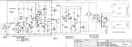

Check that the regulator is working, you should measure 67 volts
approx 33v then on the amp side of each channel of the coupling cap.
Also check R115 as being 2.2 ohms.
Schematic attached

I found a copy of the 303 service data sheets and a schematic and i can see the voltage across C101 should be 9V (same measurement as voltage on the emitter of TR100). These were the voltages i measured at those test points:
1. TR103 Base Voltage 2.2V
2. R114 Voltage drop 0.707V
3. TR100 Emitter Voltage 2.1V
In contrast, i measured the same points on the right amplifier board, giving me:
1. TR103 Base Voltage 29V
2. R114 Voltage drop 0.4V
3. TR100 Emitter Voltage 7.1V

R114 volt drop is a little odd. Can you recheck that and also measure the voltage across the two series connected diodes MR100 and MR101.
Is your amp the version with TR107 fitted or the version with the diode bias network fitted ?

A bit more for you to work on and check. The problem for fault finding on any amp is that the whole amp is a loop, that loop being closed by the action of negative feedback. That means that any basic symptom could have many possible causes. Initially we have to try and determine the cause with as little intervention as possible.
The voltage on the output cap is low because the output stage is not being turned on. The voltage at TR103 base needs to also be around 30-35 volts.
Possible causes.
There could be a problem with the chain R116, R117 (and if fitted) RV101.
TR102 could be being turned hard on which would pull the output stage voltage down. From the reading of 0.7 volts across R114 this appears to be happening.
Possible causes for that scenario...
C105 could be leaky. The only way to prove is to isolate one end of it and measure on a high ohms range. To power the amp up with it removed is risky because it could make the whole thing oscillate. Even then its not definitive unless you are 100% sure of the meter and its ability to measure in the high meg ohms region. Substitution is the answer in that case.
TR101 could be turned OFF. This is easily checked by measuring the base/emitter volts (that's across B and E) and also the voltage across R109. If there is zero volts across R109 then its off. The B/E volt drop should be in the 0.6 volt region.
C101 could be leaky. That would be dropping the first stage supply voltage.
C102 could be leaky. That would just keep TR101 held off.
Something like the above are probably the most likely suspects at this stage.
In fact any of the smaller non electrolytic caps could have developed a leakage. The best way to check these is just to quickly isolate one lead (use solder braid for a quick clean removal).

So firstly my amp is the version with the fitted TR107, with serial number of 66745 (I believe the revision was produced from serial number 11500).
These are the some measurements i have taken, some extras i took may or may not be of interest, I have highlighted measurements you mentioned and ones that showed significant differences between left and right Amplifier boards;

R203 Voltage Drop 11.4v
R204 Voltage Drop 57.7v
R205 Voltage Drop 1.14v
R206 Voltage Drop 0.077v
R207 Voltage Drop 0.5v
MR200 Voltage Drop 15v
MR201 Voltage Drop 12v
RV200 Voltage Drop 14.8v
Test point On schematic at R111 says should read approx. 8.5v
Voltage test point at R111 0.64v on Left
Voltage test point at R111 6.5v on Right
I haven't tested any caps, as i am unsure whats going on when isolate them like that, and i would like to do as least soldering to the board as possible. hopefully some of the above measurements may shed some new light.
Sorry for the late reply.
Well those are pretty comprehensive measurements and they tell us that TR101 appears to be OFF. R109 has essentially no current flowing and so T103 is fully ON. The slightly higher volt drop across MR100 and MR101 also tend to confirm that.
I'm going to go for two possible problems. Check first that R104 is OK at 22k. You must read it with one end isolated in order to get a true reading. If that is OK then C101 looks suspect. The only way to check that is by removing it and substituting. The value isn't critical, anything from 100uf to 1000uf would be OK as a test. Obviously check it for leakage on your meter but with electros it can be a bit tricky to interpret the results. For a DVM you need the red lead on the plus end of the cap to maintain polarity under test( and cap out of circuit).
See what find with those first.
Some interesting results and a step closer, i found that R104 on the left channel board measured 83K ohms, replacing this with a new 22K ohm resistor gave some mixed results, fixing some values and throwing some value way out of line.
9 volts now appears on the emitter leg of TR100 and R109 voltage has risen to a similar voltage to R109 of the right hand channel. But the left channel coupling cap voltage is no 62V! almost rail voltage.
Red highlights show there is a difference in values and Blue shows a very significant difference in values.
Right Channel Coupling Cap 24.8V
Left Channel Coupling Cap 62v (almost rail voltage!)
Left Hand Channel
MR100 Voltage Drop 0.3v
MR101 Voltage Drop 0.3v
TR101 Base/Emitter voltage drop 0.63v
TR102 Base Voltage 0.64v
TR103 Base Voltage 64v
R102 Voltage Drop 9.18v
R104 Voltage Drop 59.7v
R105 Voltage Drop 1.6v
R107 Voltage Drop 0.8v
R108 Voltage Drop 0.02v
R109 Voltage Drop 0.16v
R110 Voltage Drop 5.3v
R111 Voltage Drop 0.46v
R112 Voltage Drop 68.3v
R113 Voltage Drop 55v
R114 Voltage Drop 0.04v
R116 Voltage Drop 2v
R117 Voltage Drop 2v
R130 Voltage Drop 61.3v
Right Hand Channel
MR100 Voltage Drop 0.51v
MR101 Voltage Drop 0.528v
TR102 Base Voltage 1.08v
TR103 Base Voltage 25v
R102 Voltage Drop 7.81v
R104 Voltage Drop 62.8
R105 Voltage Drop 1.7v
R109 Voltage Drop 0.174v
R110 voltage drop 4.3v
R111 Voltage drop 0.38v
R112 Voltage Drop 68.7v
R113 Voltage Drop 19v
R114 Voltage drop 0.43v
R116 Voltage Drop 21v
R117 Voltage Drop 21v
R130 Voltage Drop 62.8v

A bit more for you to go on...
Its worth also checking the other high value resistors R130 and R112 in the same way. With the previous fault R112 will have been subject to the full rail voltage. If the Quad uses old carbon or carbon composition type resistors then those two are worth checking.
Right on the money my friend!!
R130 measured open! replacing it brought all the voltages to spec. Changing RV100 brought it back in line with right channel. And in testing it, sounds just as good as it did before, very glad to be able to listen to my music on this amp once again.
