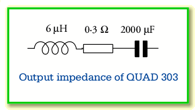

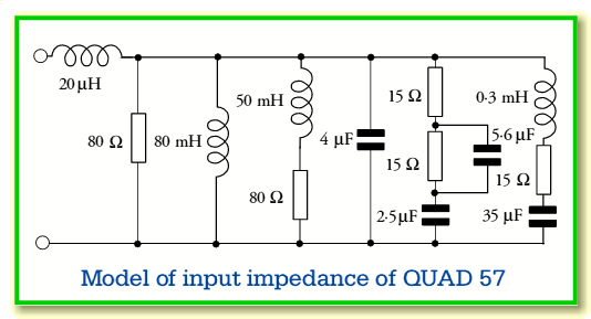

As to the value, I recall that the Quad was designed to be stable particularly with an electrostatic speaker which Quad sold, so that was said to be about 2uF load equivalent.
If you do not plan to use ELS's then you could probably reduce the inductance but if you are still using hometaxial 2N3055's (the originals) I would keep with 6.8uH as they have trouble maintaining high frequencies.
I used 3.3uH but with faster devices although I've never had ELS speakers to be unduly concerned about the loading.
Hi John, thanks for your answer. Yes, I’ll be using the amp exclusively for the ESL-57. I’ll also be using the original RCA38494’s (2N3055) which I salvaged from an older amp. They’re in really good shape. (I’m trying to keep the amp as original as possible.)
The company I’m using for parts has 6uH and 8uH chokes rated at 3A. I think the original was actually 6.8uH. Anyhow, I’m thinking either one would work. Hoping for consensus.
