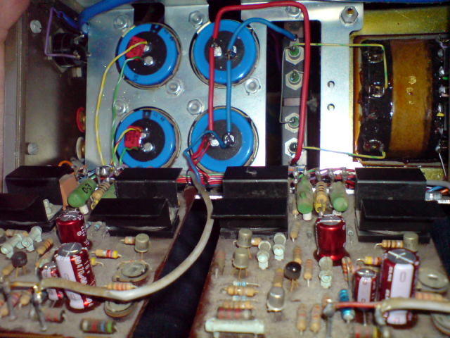

iv bought a quad 303 a little while ago [serial 1568 ] so this is a real old one but sadly the right hand channel has always been really quite 😕
iv changed the audio board capacitors with elna ones and i upgraded the power supply with the main kit from NET AUDIO, it didnt blow up 😀 however the right channel is still really quite, it almost does nothing.
right and left audio boards both have 33v supplys and iv set the bias on both 😕
could it be the power transistors at fault? if so is this a chance to upgrade further?
im 19 and have a limmited knowledge on electronic stuff so please dont blow my mind with anything to complex lol

Hi, nice work so far.
I would definitely change those trim-pots to something better. The values may drift with temperature after all these years.
I'm fairly new to all this too, but I recently sold my upgraded 303. I would compare the voltages on the bad board to the good board and that may help you trace the fault.
Upgrading the transistors did improve the sound for me.
