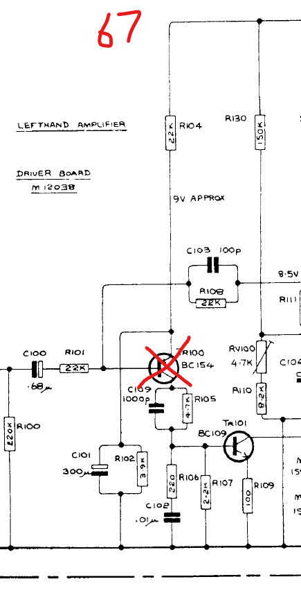

QUAD 303 cannot set center voltage
There is two diode biasing for TR102 here.
As far as I can tell those two diodes are normally either non conducting or conducting so little they make no difference. The emitter volts of TR102 is only around 350 to 400mv. and that plus the vbe drop does not quite equal two diode drops. Its on a knife edge but I don't think work for setting current in any way in normal operation.
