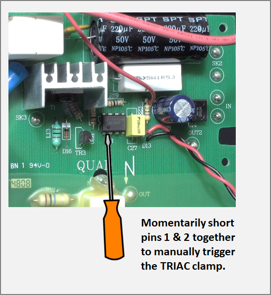

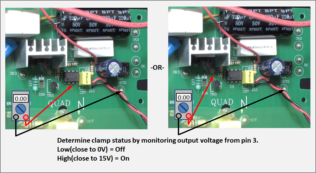

The NE555 timer is operating in monostable mode. 555 timer IC - Wikipedia
When the trigger pin(2) is pulled low(ie to ground) the output pin(3) goes high, activating the TRIAC clamp, and stays high for about 3 seconds after the trigger is removed. You can monitor pin(3) , or it’s connection to R17. It should be close to ground potential normally, and close to 15VDC when activated.
For testing purposes, you can activate the clamp manually by shorting pins 1 & 2 together.

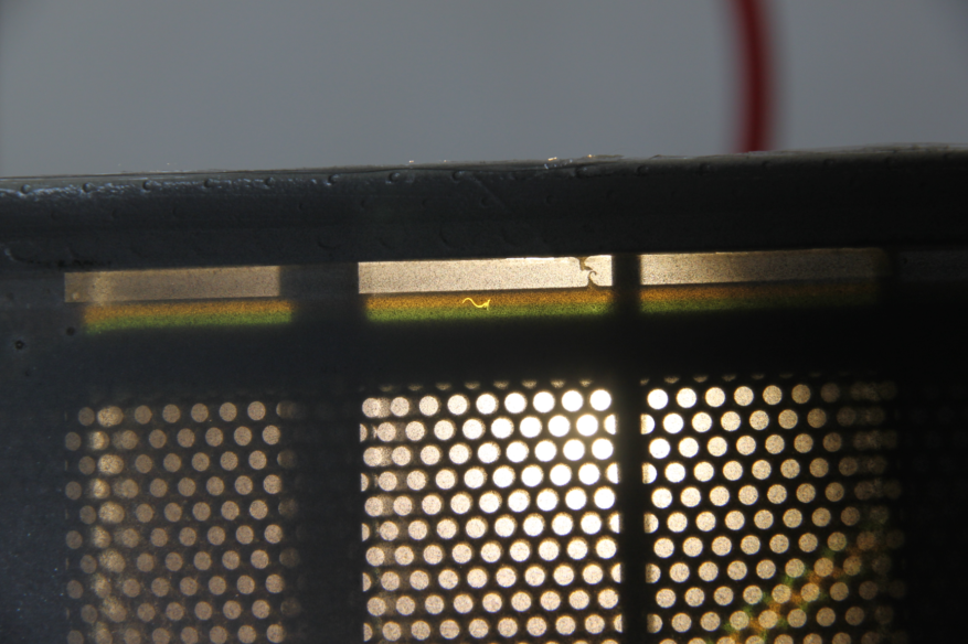

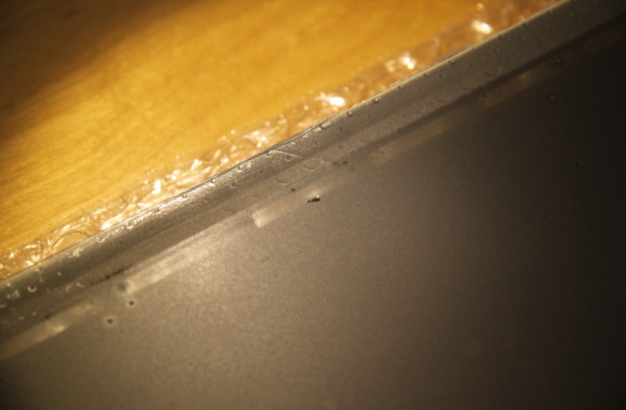

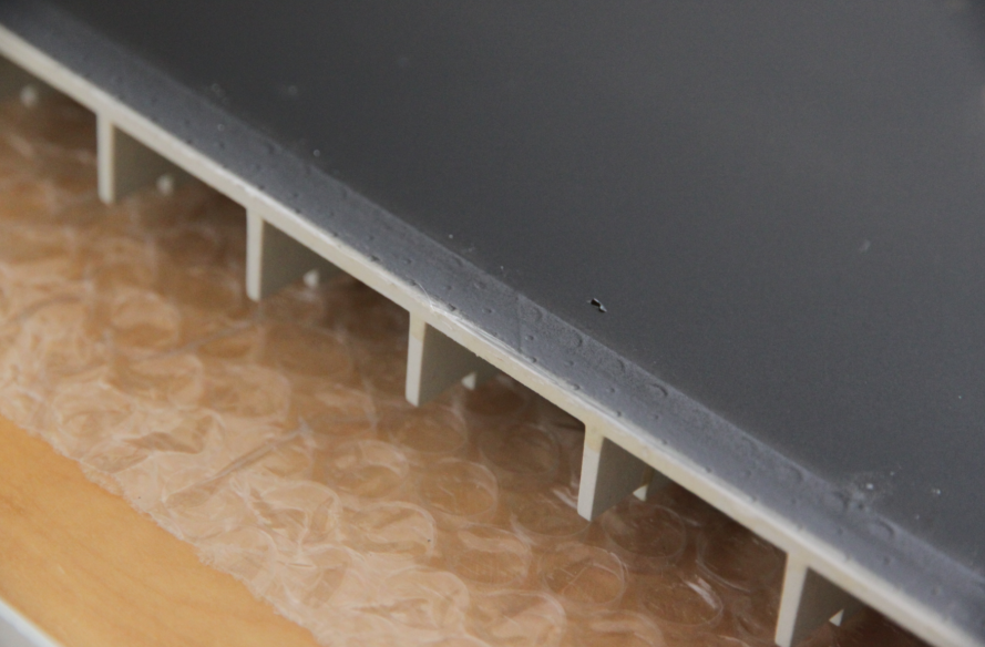

Here's a picture of diaphragm splitting ( this one is pretty advanced), but it can be somewhat subtle to spot if it's just starting.
http://quadesl.com/diyaudio/IMG_2887.jpg

In my limited experience, these intermittent problems with clamping are often a panel problem more than an electronics problem. And it either a stator glue problem, just starting where the de-lamination is very local. But the bigger issue these days is diaphragm rot, where the diaphragm starts to split. It's really hard to spot without removing and splitting open each panel. The split often forms a corona and causes a small leakage, and forms an area that is easy for a corona to turn into an arc.

I asked myself if it was possible to activate the clamp circuit on purpose so that I could check if the perceived distortion was like the distortion the ESL itself was producing on loud music (sometimes). To make matters more complicated the recent days the culprit was behaving impeccably. No distortion at all. Grrrrrr !!
Bolserst showed me how I could activate the clamp. At the same time I measured Vac (the ripple) over C28. The latter because I noticed before that the ripple doubled during periods of distortion. The outcome is that the distortion caused by forced clamping more or less resembles the original problem and that it is indeed the clamp circuit that is causing the increased ripple. Of course Sheldon said all this before

To summarize this thread, one of my Quad 2805 ESL's has an intermittent distortion problem. It's playing fine for hours even days and then at once the sound is distorting heavily. Conclusion is that for some reason the clamp circuit of the Quad is activated. To check the stators and the diaphragms I dismantled the speaker completely. A very time consuming job and you have to operate very carefully not to damage something. Now to the findings. The stators are properly glued to the frames, no problems here. At first sight the membranes are looking fine too, a few stains here and there which look like coating spatter. On a closer look one of the panels has a very very tiny what looks like a small tear at the edge. It's just two or three millimeters. See pictures. Could it be the beginning of what Sheldon calls "panel rot". On the third picture at the left there are two stains that look like coating spatters and in the middle the small tear.
Now my questions: could this be the reason for the clamping circuit to activate and second is it necessary to renew the membrane ??
Aha! you have a bad diaphragm; I warned that it can be hard to find without completely taking the speaker apart. In my limited experience, that diaphragm rot will continue to get worse on the effected panels until it fails completely (see my previous pictures). I've never tried to repair one, because it's so much less effort for me to replace it, and then I know it's good. I've seen quad panels from the factory with tape repairs, you could try a small piece of tape to cover those areas. The problem is that the ragged edges that stick down may still arc and trigger the clamp circuit.
To answer your questions, yes, that is a reason the clamp circuit could be activating. In my opinion, that is THE reason it is activating. And to answer your second question, in my expeerience that panel will continue to get worse.
