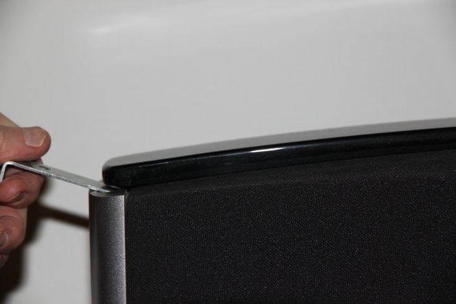

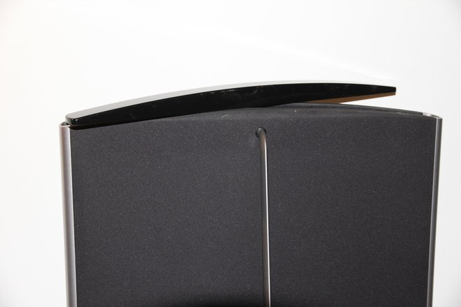

First thing is removing the top bar of the ESL. Following mats31's instructions I used a flat piece of metal (picture) and lifted the left hand side of the top bar a centimeter or so. The same for the right hand side. Then you are able to remove the bar completely (picture).

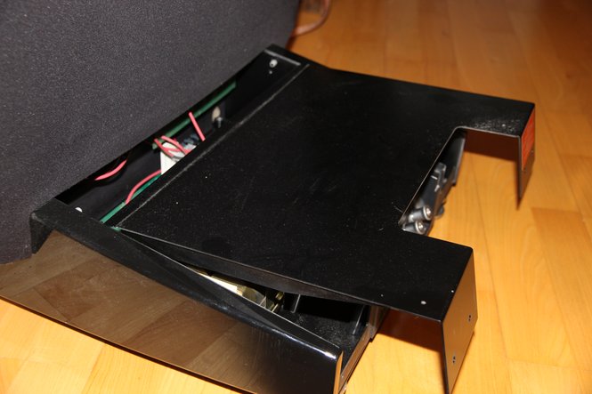

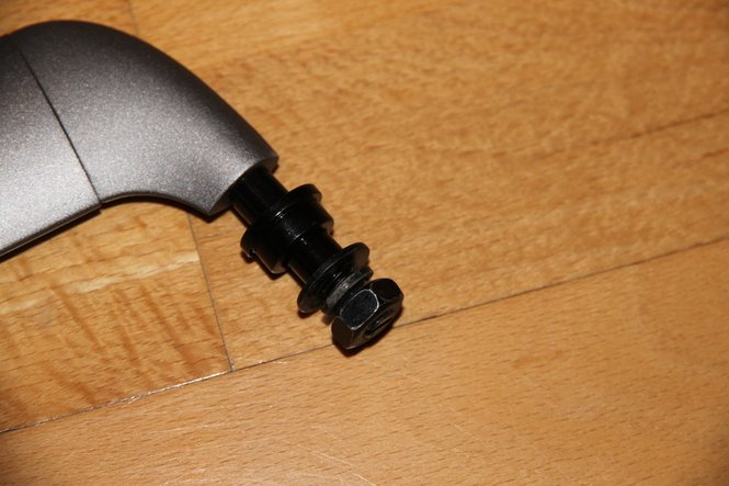

In the resulting cavity (picture) you can see the nut that holds the tension brace at the backside of the speaker. Loosen the nut but hold the brace firmly to prevent damaging the threaded downside of the brace. Loosen the tensioner at the bottom and remove the brace (picture). Now you can remove the four screws at the backside of the base. Lift the cover of the base a few centimeters, slide it backwards and remove it (picture).

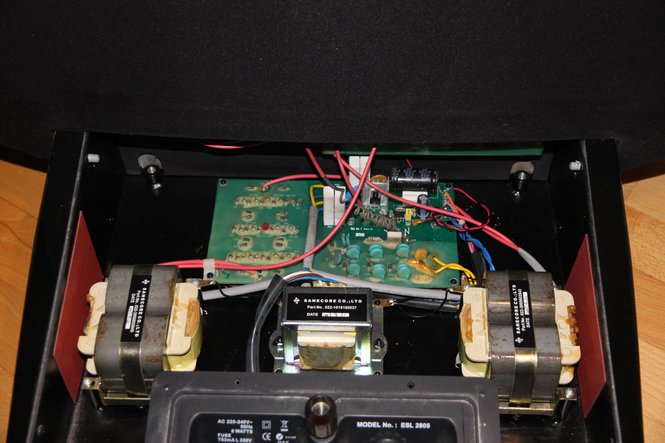

The electronics is located at the base of the speaker (picture).
Well now I am again in newbie land. At the left and right hand side I see the audio transformers. In the middle the mains transformer and just behind it the main board. On the main board (picture) pointing to the power supply the blue caps and the diodes of the high voltage supply (??). Just behind it you can see the cooling fins with the triac and the timer ic of the clamp section (??). Right at the backside of the board two electrolytic capacitors. One of them is the 1000u 25V member mats31 mentioned as a possible suspect. To the left on the main board the diodes which are feeding the audio to the different sections of the stators (??). Please correct me if I'm wrong, I am here to learn, to pass on my findings and in the same time repair my esl with hopefully the help of more experienced members.

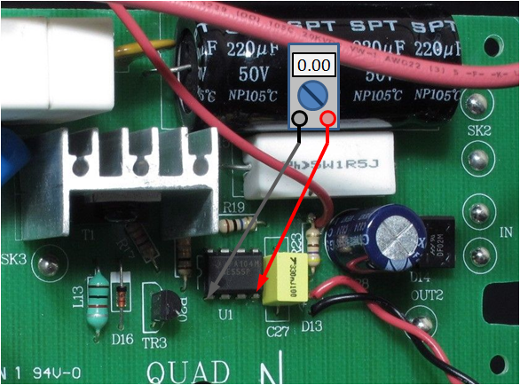

Before removing the board and replacing the 1000uF (C28) LV power supply capacitor, you might consider measuring the supply voltage with a digital volt meter. It is most easily accessed from pins 1 and 4 of the 555 timer IC. Measure both DC and AC voltage. You should get about 16VDC, and very low < 0.1VAC. If you get lower DC voltage and greater AC voltage, this would confirm that the 1000uF capacitor needs to be replaced.
The voltage I measured on pin 1 and 4 of the ne555 is 15,5 VDC. I can’t confirm the <0,1 VAC. The VAC on my dvm is constantly changing in the rythm 38,15,6,2,0 V. Isn’t that the ripple of the capacitor charging and discharging process ? Or am I totally wrong here?
Yes, the VAC reading is measuring the ripple of the capacitor charging from the bridge rectifier output pulses. It should be fairly steady and certainly less than 1VAC. If you are seeing large AC voltages like 38 or 15 then replacement of the 1000uF capacitor is in order.
