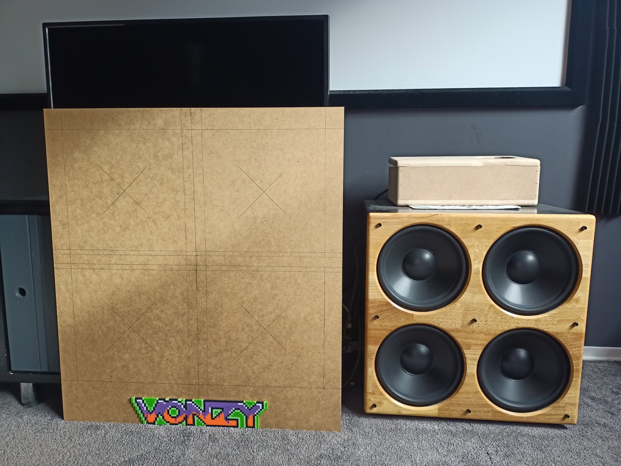

Would having 2 of these quads in the front with EQing from DSP help eleviate these issues of disgust you have with my design?
EQ can flatten the cabinet response, but can't "fix" room issues, other than in one position.
Multiple cabinets can reduce room issues, but little is gained past three cabinet locations.
Your 4x10" drivers are located within 1/4 wavelength of each other below ~100Hz, so for a normal "sub" crossover frequency, phase cancellation (lobing) is not an issue.
The 4x10" center to center distance is nothing compared to the center to center distance between subs and mains in a distributed sub system.
Opposed drivers don't "dampen resonance".
Opposed driver's mechanical force offset is a positive feature as far as reducing structural weight for a given amount of cabinet vibration, though with your driver's relatively light cones and short excursion, nothing to get too excited about- I doubt the cabinet "walks" with asymmetrical input waveforms as it is.
Mechanical force transmitted through the floor gives a more immediate tactile sensation, which also can be viewed as a positive feature- a lot of enthusiasts add tactile transducers.

My plan was too always (hopefully) make each driver work together in the same cabinet to boost playback on all fronts due to the drivers being relatively cheap to almost compare to something of higher quality in a single driver box from a name brand which i couldn't afford. In my mind i achieved that goal. Once i received the comments from one poster about the "hot mess" i had made i did a little digging on lobing and cancellations, i did find an article that used a heat map to show subwoofer DB vs distance and how it is dispersed. It showed that if i place 2 sub boxes within about 2metres centre to centre then they will work together, as they were moved apart more they created some cancelation points and lobing, it would get quite severe around 3-4metres. When i create a second one it will have a distance of 1.8 metres centre to centre. So i really should achieve my goal. Which was always maximising db gains from multiple drivers and making them super efficient by driving them all separately as i dont have the $$$ to purchase a 1000+ watt amp.
It seems like that's what the OP was trying to do. If he likes it, that's good enough for me. Different people have different desires and goals for their creations. Just because something can be optimized some other way doesn't mean it has to be. Or that those improvements even matter to them.
I owned a SVS PB downfiring subwoofer years ago, sold it when i had kids, got back into home theatre when they got a little older and needed a subwoofer. I spent $1500 aud on the SVS originally and decent subs now cost at least or more now for anything decent in output. So i basically was working out how i could use the power of mutual coupling and seperate amplification to make a sub affordable and efficient. I achieved that and it cost me around $400 at the time. I can say for a fact it has way more impact than the single SVS had in my room (its sitting in the same position)
I have ordered a Dayton dsp-lf to get some readings and do some tweaks once the quad 12" is made. If it looks decent and outperforms the quad 10" i will make another later this year to compliment it.
I might post the dsp readings on here once complete.

My room is slightly smaller than yours (fully enclosed) I enjoy bass and would like more. I also have 2 x buttkicker lfe attached to 2 of the seats which is probably more of a game changer than adding a second sub in the room.
I guess once you get the bug for bass you want more. I unfortunately cant go forking out $5000 for some serious subs. So DIY quad subs it is haha.
I'd rather have your 4 10"s in one box like you did, than a set of singles.
Like Art said, sub wavelengths are going to keep the drivers acting as one, and personally...I just don't like the sound of multiple subs placed around the room. Give me head-on front-firing bass !
