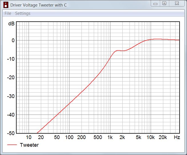

Well, fantastic to have John K, Wolf and AllenB online and interested. :D
Can I ask you flippin' crossover geniuses a question? :)
How would you calculate the RLC compensation circuit for SEAS' current proud DXT tweeter offering?
H1499-06 27TBCD/GB-DXT
I'm guessing something like 1.3mH, 25uF and 7 0hms with my limited tools:
Alan Yates' Laboratory - VK2ZAY's Engineering Calculators - LCR Resonance
Strassacker: Speaker Building, Components
I'm interested, because MarkK's interesting ER18DXT speaker just seems to notch around 1.6kHz and 6kHz, which is nowhere near the 900Hz resonance of the DXT tweeter and seems a bit strange. :confused:

What changes is the impedance the upstream elements in the crossover network see, and how they interact with that impedance.
I never said the drivers' characteristics change. I said the LCR damps the Fs in terms of system (your word and better description) results.
We are in agreement, John. That's why I said chicken or egg...
Later,
Wolf
diyAudio Moderator
Joined 2008
We may be down to splitting hairs here Wolf but I'd have to disagree still.
If you look at the response of a typical dome tweeter at its Fs, it's often down in relation to the passband as a result of mechanical damping of the resonance. This type of plot is done at a constant voltage at the terminals. Peaking that may be produced as a result of electrical network source impedance is an extraneous factor and it is therefore wrong to see it as the benchmark. Conjugating the impedance peak only restores the potentially constant voltage input notwithstanding the desired shaping.
