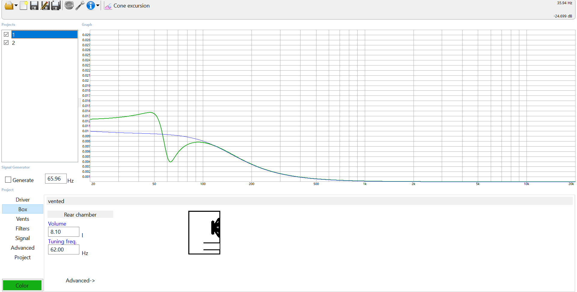

If there is a standing wave inside an enclosure, what is the best way to eliminate it without changing too much of the design? I put my measurements into an online calculator and it shows me that i have a standing wave at 5,9khz.
A quick browse of the web tells me that stuffing (Polyfill / Fiberglass) will help reduce it. As far as I'm concern, stuffing with polyfill lowers Q and make the drivers think that it is in a bigger enclosure than it actually is. Since if my driver got a bigger enclosure the cone excursion will be too high, will stuffing my enclosure with polyfill effects the cone excursion? Thanks!

At 5.9 kHz it should be easy to kill the standing wave with damping.
That is a pretty small box dimension?

Only if you so heavily over-stuff the box that it effectively becomes a solid mass and causes volume reduction, or place large quantities in immediate proximity to the driver, sufficient to mass-load the moving components.

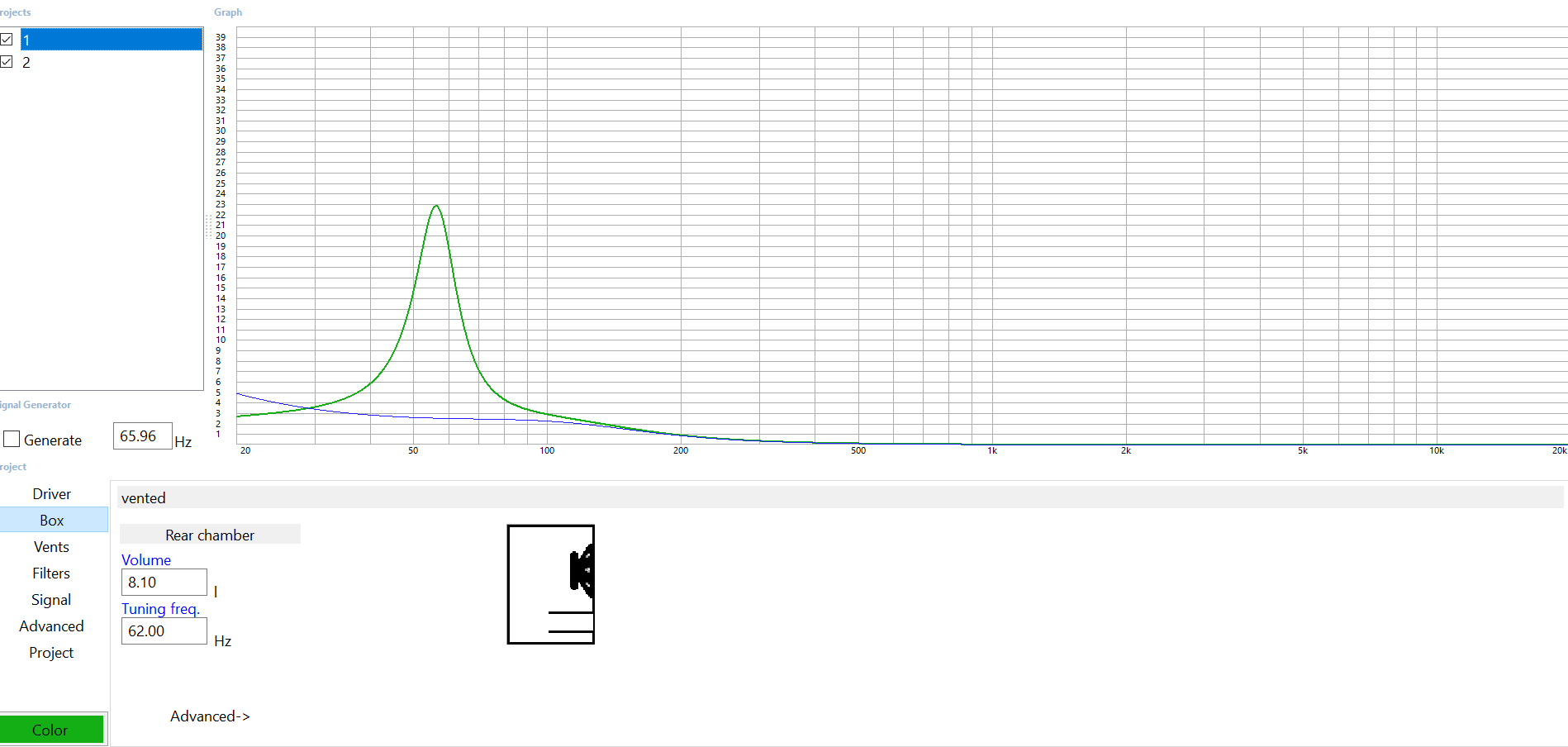

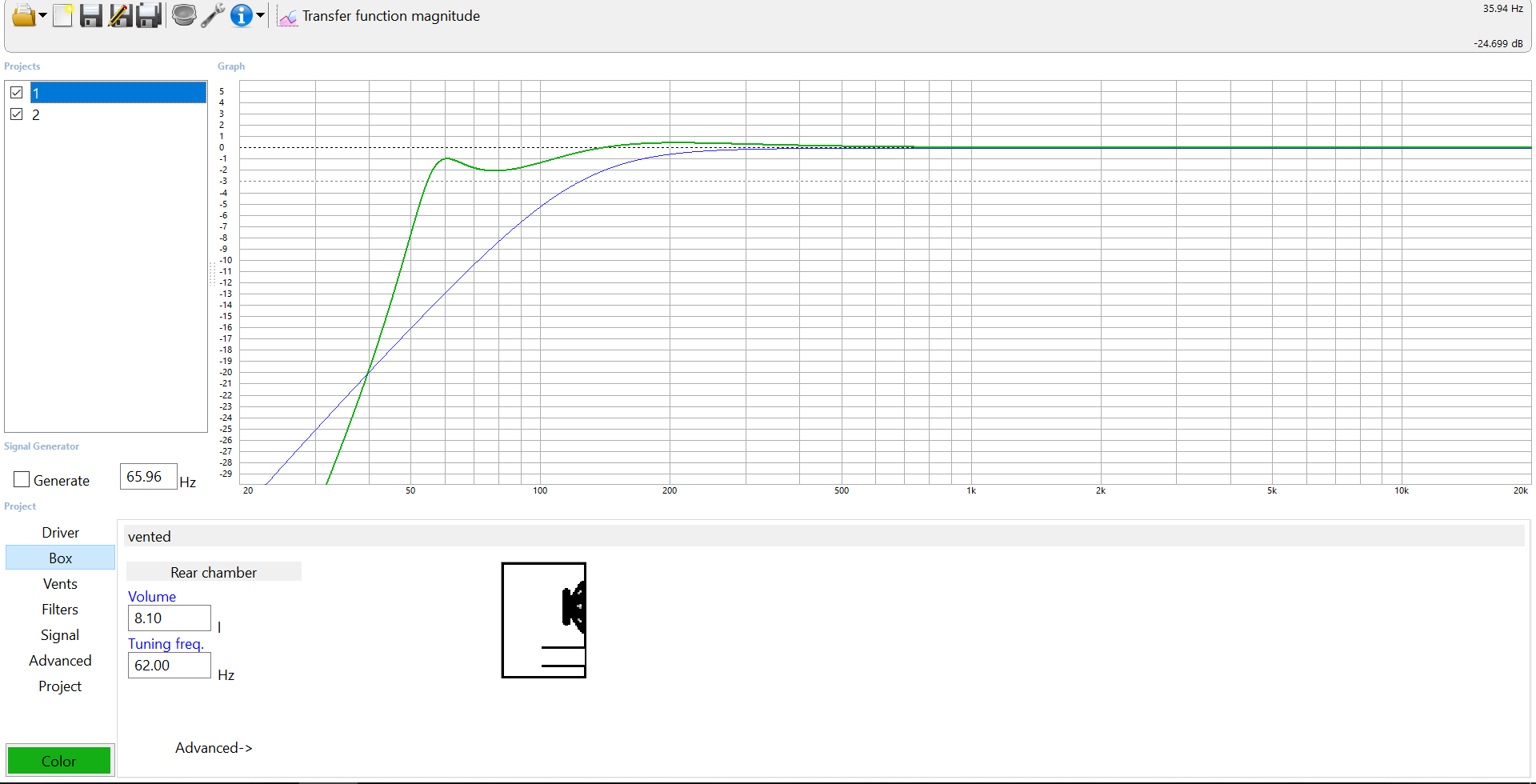

If vented, damping reduces the vent's ability to limit excursion around tuning [Fb] as it moves closer to ~aperiodic, so can be [quickly] over driven if not low pass filtered.
