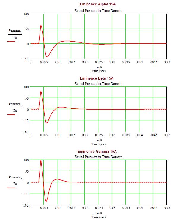

The 'Q' of a driver is a quality factor. A high Q indicates a big peak in output near resonance (or Fs). This means the magnet is not powerful enough to damp the cone near its resonant frequency. In a sealed box, the enclosed air provides some resistance to the cone when it tries to move excessively near resonance. On a OB, there is nothing to stop this excessive motion. But the baffle roll off counters the excessive output giving an overall flat response. However, you cannot hide the fact that the magnet is not strong enough to damp the cone.
A low Q driver on the other hand has a magnet powerful enough to resist the excessive cone (somewhat) motion near resonance. Add to this the natural roll off on OB and you get less bass compared to a high Q driver. But you can always compensate this by adding more EQ. What you will get though, is a driver that can produce a bass note in music and stop the cone from moving when the note stops.
I am not sure I agree with most of what you have said above.
The Q of the system will detemine the shape of the bass SPL response, a driver with a Q of 1 or a driver with a Q of 0.3 EQ'ed to behave like a driver with a Q of 1 will produce the same bass SPL response. If you blindly measure the SPL response of the two options I am not sure how you would tell the difference.
I think your statements about the starting and stopping of the bass notes is totally off the mark. If you look at my two way OB write up, I include the SPL and transient responses of three woofers with different Q values. In the transient response plots I don't see much difference in the ring out of the three. But in the SPL plots the driver with a Q of 1 produces the deepest bass extension. Recognize that a driver with a Q of 1 is still a very well damped mechanical system. What calculations or measurements lead you to these statements?
Martin
I'm glad you chimed in MJK. I have no calculations to back up my statements. I'm not as mathematically inclined as you are. However, I don't think we are in disagreement.
I did EQ the low Qts driver to have a flat response. So, what you are saying is what I did. I also measured the frequency response and I don't feel the need to check the difference between the two systems' Qs.
I looked at your OB writeup and the attached picture shows the transient response of the three drivers from the writeup. The Gamma15 has a Q of 0.38. Look at how long it takes for the alpha15 to settle. It settles somewhere around 33ms in the chart. Now look at how long it takes for the Gamma15 to settle -10-12ms (in the chart, without removing the start of the impulse). I know you will argue that the alpha15 goes deeper in the bass and that is why it takes longer to settle in this chart. But this transient response matches what I'm hearing. Whether it is below the threshold of audibility, I don't know. But I can certainly hear it.
I've also tried your suggestion for the alpair 6 and crossing it to the alpha15 at 400 Hz or so. This combination sounds bad. Really bad. The alpha15 has a thick, sluggish sound and it just doesn't go with the full range drivers. Now, with my Deltalite2515, I'm happily crossing at 400 Hz for the alpair6 and the smaller fostex drivers. It may be a case of mismatched system Q with the alpha15, but then this is the best I can do.
Do you at least agree that low Qts drivers (0.3) represent an overdamped system? I guess I prefer the sound of an overdamped system to an ideally damped system.
I agree that on the same baffle, without EQ, the alpha15 will go deeper than the beta15. But with EQ applied, the beta15, according to me, should sound better than the alpha15.
