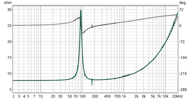

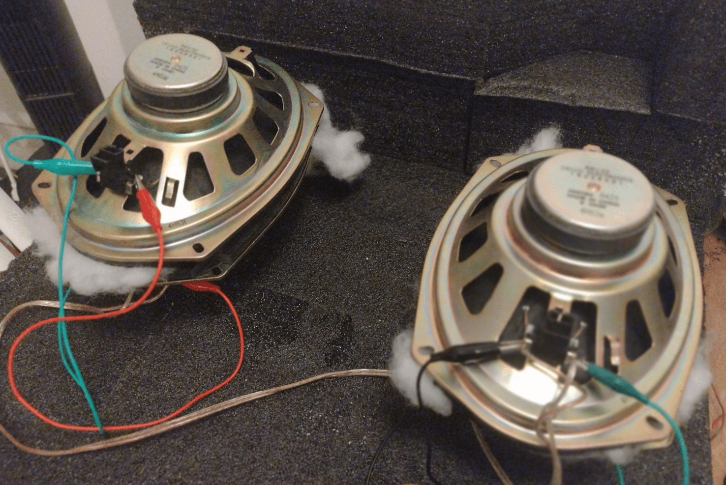

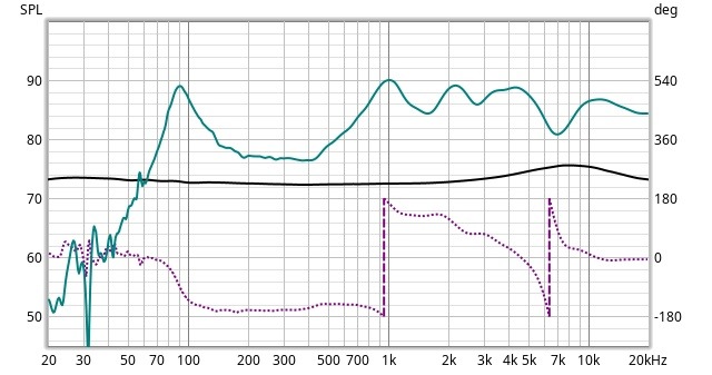

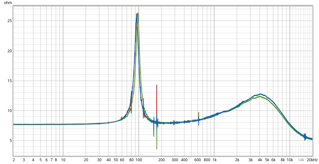

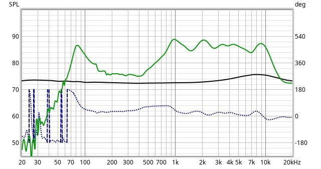

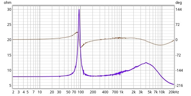

This is what I got after the 12H, 100Hz treatment. Usable for the experiment if I EQ but not the best for that use case. I'll do it anyway to check that what I model is similar to what I get. Thanks for the insights!
Fs 87.8 Hz
Qms 9.181
Qes 3.295
Qts 2.425
I just started measuring drivers, but the measurements haven't been too off when checking drivers with specs.
Simulated in 200Lt box.
Mounted in a box with the back open, from 15cm. Only adding because it's better than the previous one.
Fs 87.8 Hz
Qms 9.181
Qes 3.295
Qts 2.425

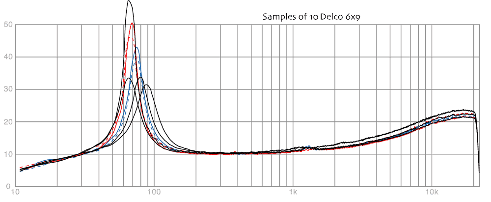

But every car loudspeaker designed to be mounted in doors or behind the rear seats has Qts equal or greater than 1. And I mean every loudspeaker, including 6x9".
I found an old issue of Car Stereo Review today, where they tested 8 different 6x9's. In their testing, they measured T/S parameters in their lab and here are the numbers.
Notice that not a single one has a Qts that's out of HiFi driver range, and average Fs is 52Hz.
